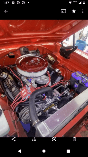

Nice car!
It sounds to me your 906s are milled to 72 cc if you are running a .039 head gasket. Your engine data sheet might say which head gasket thickness they used to achieve 9.5 ...if you want to know want your exact cc's you need to know that. 78 cc aluminum head will likely lower your compression unless they you have them shaved too.
Racetec/autotec are good pistons and are Similiar to JE pistons..The owner of JE pistons sold the company and after a few years started these two new piston lines They specialize in affordable custom pistons. Which sounds like what you have.
Personally if it was my engine I would put in a lot bigger cam....with or without a head change. It looks like you have a dual plane intake, can't tell what headers your running but those probably won't help it get to 600hp.
Nice car!

Is your car a torqueflite or a stick? Is the 450hp you mentioned engine dyno or chassis dyno? If that is engine dyno, that does seem weak for a 505 with a large cam. If thats chassis dyno, i personally dont believe the "numbers" much, they are unreliable imop,being skewed by the torque converter. Also chassis numbers are usually 15% to 20% off of what an engine dyno shows. You might have 515-540 hp now at the crank.
Second question: you didnt mention headers, and it looks like you have exhaust manifolds. You might az well kick your motor in the nuts. I built a 511 with a crane 509, milder cam than yours, with stock manifolds, that wouldn't pull a fat girl off a tricycle. Headers were worth almost a hundred hp. Tbe FIRST thing i would do is headers. If I'm wrong , and it has got headers, excuse my bad eyesight .
In my humble opinion, you need more info about what you have now. Really has that huge dish? Really has .095 milled off the heads?(thats a ton).
Before i bought anything, i would pull one head and see what i really have. (Except headers, i would buy headers).
1 wild R/t I agree with your thinking. My saying A lot bigger cam is a overstatement. But I think I would talk to a cam company like bullet and have them grind a cam that wouldn't lose much compression but would wake it up and let the 505 breathe. A custom grind I think could wake it up vs one off the shelf. And would respond better to whatever head upgrade came.
I have stainless headers . And 2 1/2 duel w x pipe .. no that is power at the crank shaft .. and the heads are.095 milled .. I feel the car is peppy but far from what I would like to achieve.. that's why I was curious if I could just buy a hone drop in new pistons and rings ,put new gaskets on it cam it up and put trick flows on it . But it seems that everyone agrees that may not be the best idea
