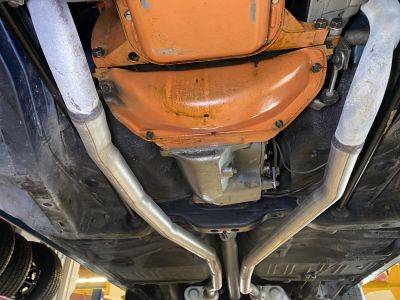

Is this real? Should we buy it?
If you remove back seat would springs match? The hood would need be on BS and fender tag for me to believe it. My rear seat build sheet is cleaner.
Should have a turquoise 330 h.p. 383 with 600 cfm. Holley. Super Bee had orange 335 h.p. 383 with 625 cfm. AVS. Same "H" code on VIN.

My 69 Coronet 440 w #'s matching 383 & 727 is worth close to 30K and add in a 4-speed it is that according to Hagerty. Now a Coronet 500 had bigger engine options and is worth more but I would estimate in the 40K range for that car except for the missing fender tag which brings me way back on price. Just my opinion and I think you can find one for less or get a decent Super Bee for around that asking price.
If the sheet is real, and it probably is... The 4 Spd is correct and pretty rare... 1 of 281... But the hood is added, it's not shown on the build sheet.. If it were I'd be very suspicious of the sheet, it's not & I'm not... N96 as previously stated Super Bee & R/T only... Cool car, cool color... I like it & twenty-thirty years ago thats how we built cars, you want an option you add it... These days people seem to think that makes the whole car a crime...
Where can i verify its possible one of 281 status? Would its rarity command a $63k price tag?

That number is from Galen's white book... 63K is ridiculous....

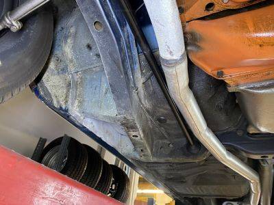

Always nice to get the torch too close?
My opinion? 63K is way to much for that car. You should be able to find a real Bee or R/T for that money without to much searching. Let someone else take the loss on that one.
