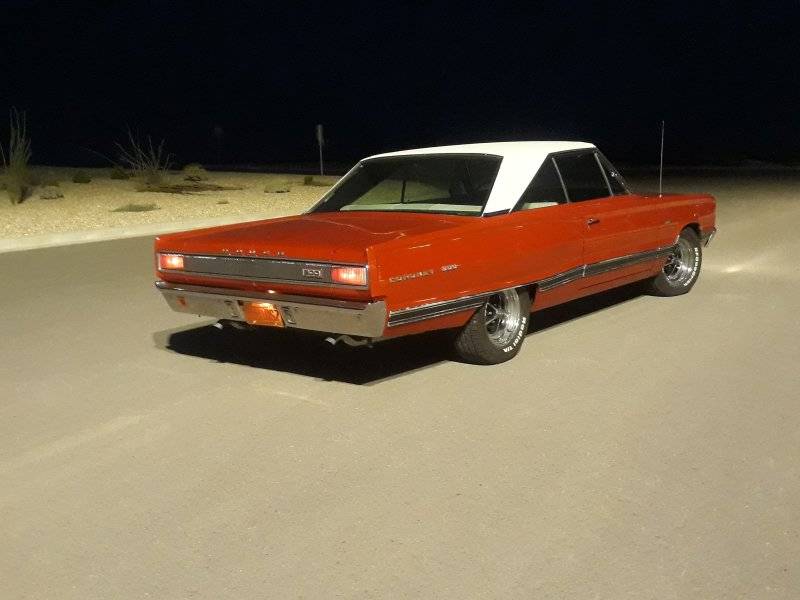

Ps.
Ill sell you a 1967 coronet 500.
With working air for MUCH less that 63k .A LOT less.

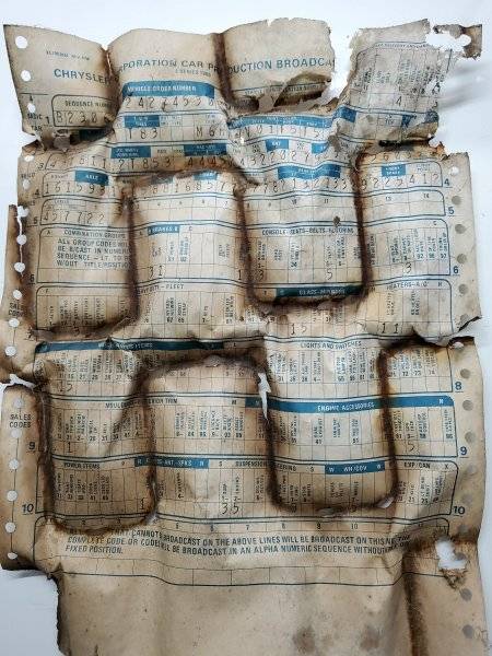

I agree that the build sheet is a fake. That's a 53 year old piece of paper that wasn't meant to last this long. There is only one spring mark on it. This is mine. Notice the tatered edges and browning commensurate with age.
