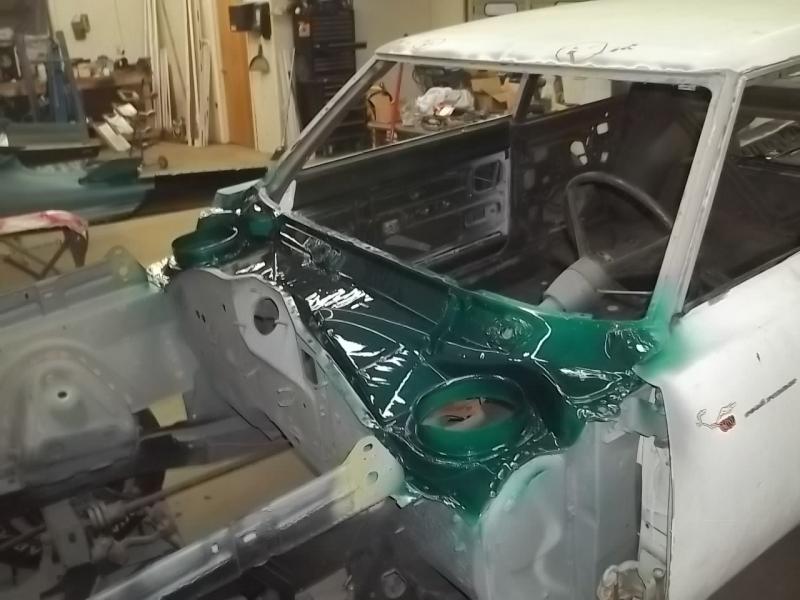

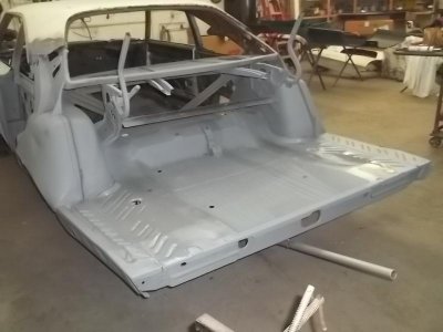

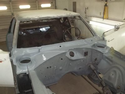

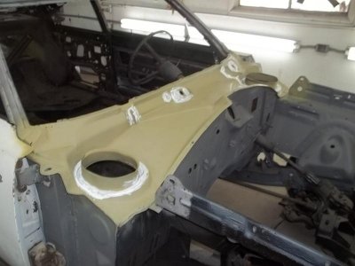

quick update.........

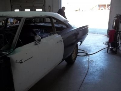

Looking really good, looks like you'll have a good day of welding to do. What happened to your radiator support, motor removal accident??????????? Keep it up
at least a day. I really don't know about the rad supt. an old war wound I would say. thanks a lot for watching and, for commenting.

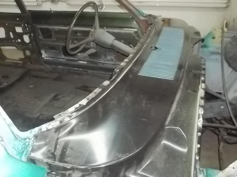

This thread is full of excellent reference pictures for taking these beauties apart and putting them back together correctly thanks for sharing your work!

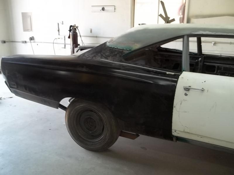

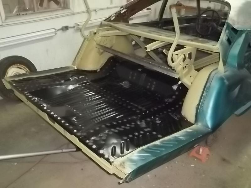

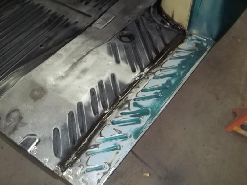

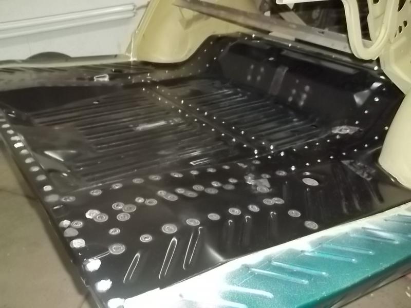

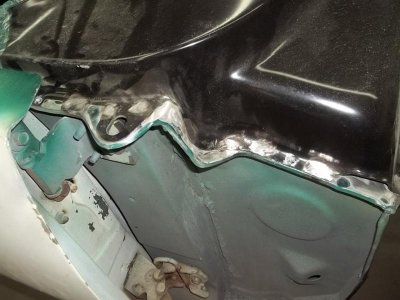

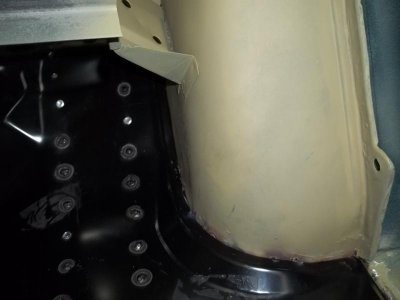

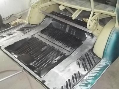

........250.......and burning.....................

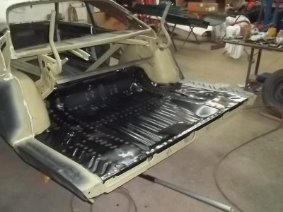

How long does it take to do that many burns?

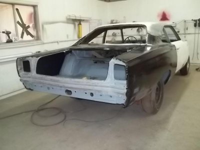

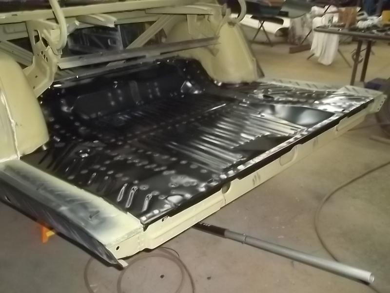

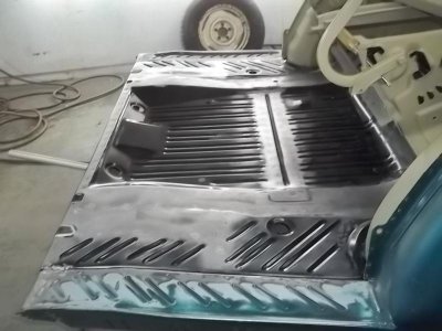

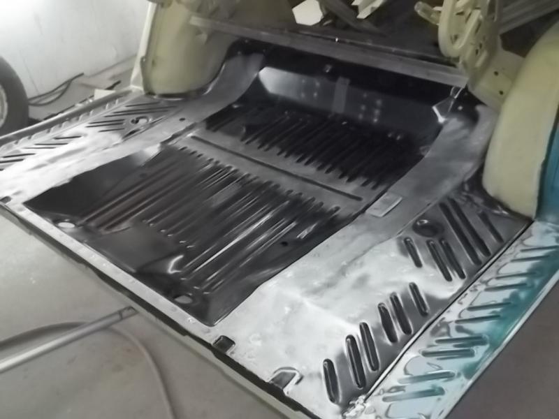

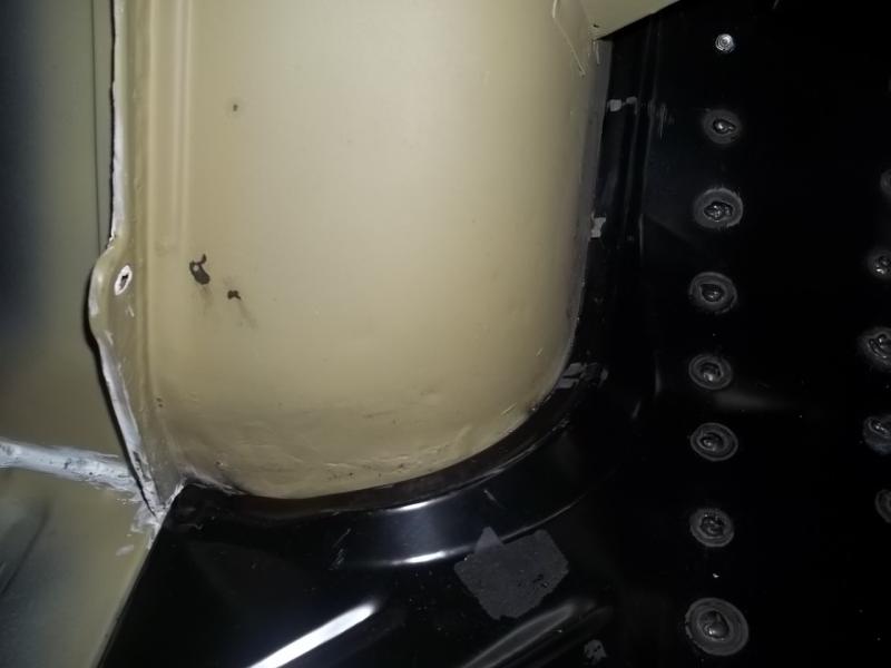

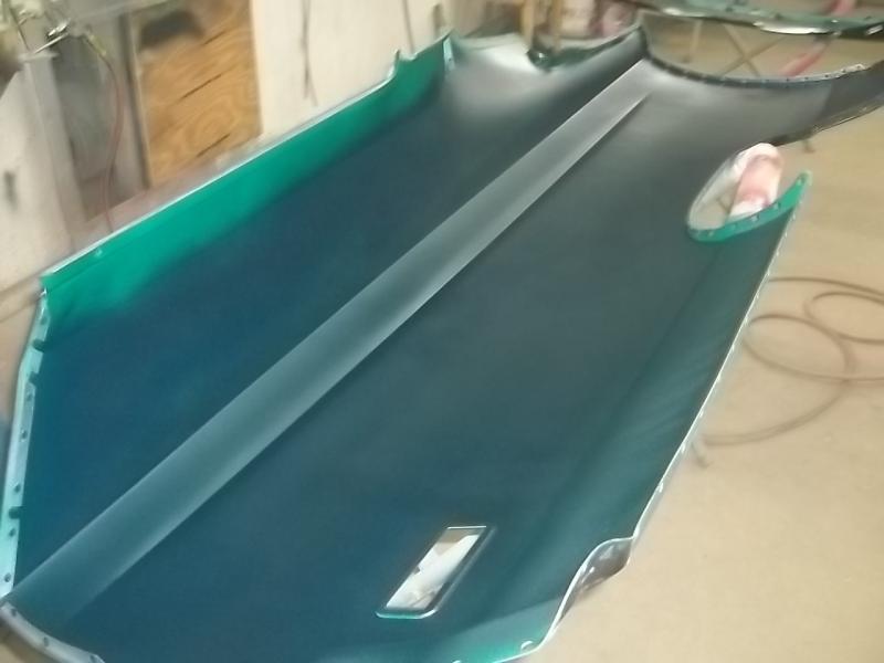

I would have to guess that i'm in the 6 to 7 hour range at this point. but there was 10 or 12 hours fitting, blasting, repair and grinding. the time consuming part is quenching the welds, and keeping the panel cool. patience is still a virtue men. i'm going to guess there is 5 or 6 hours left in the trunk, grinding, blasting and sanding, but then the quarters go on. immediately. if not sooner. that's another 250 welds. at least i'll be in the groove.

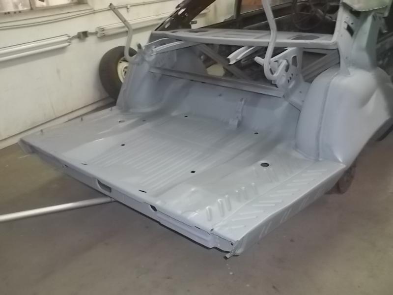

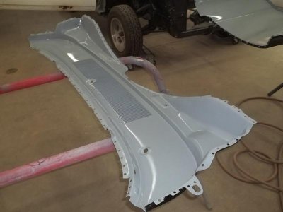

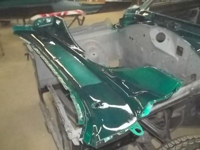

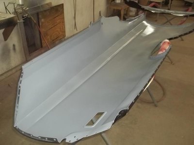

moving right along.........
looking very good thanks for sharing the updates with us

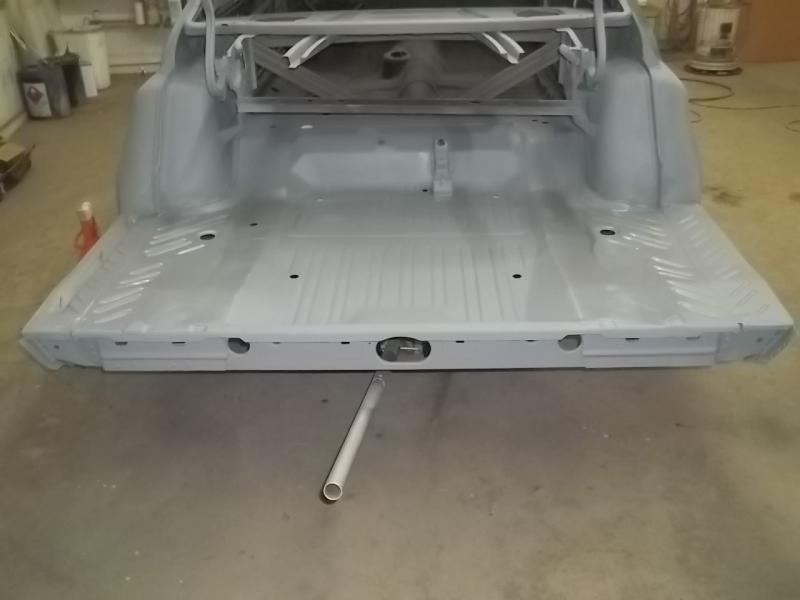

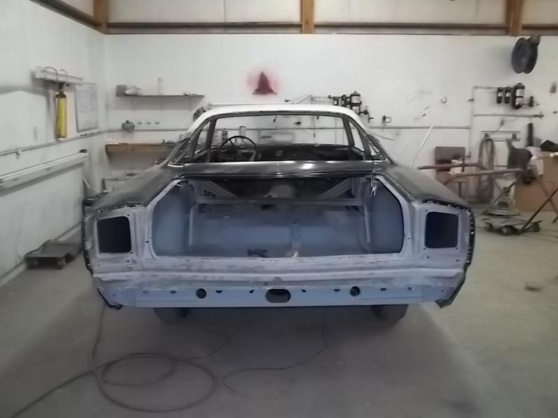

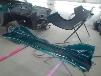

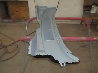

thanks a lot for watching folks. heres a quick update.......

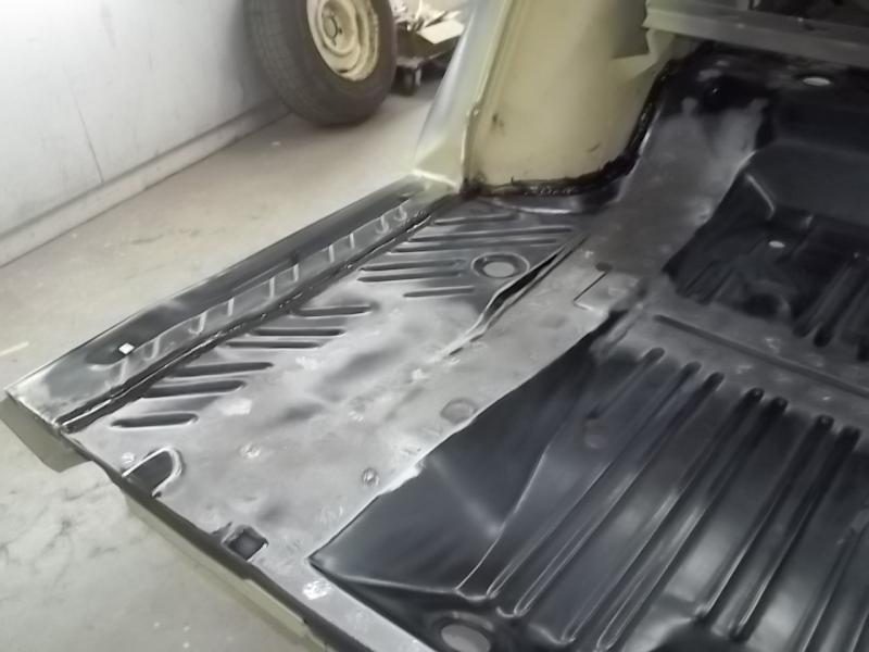

Very nice work, you really went the extra distance on cleaning it all up.:hello2:
