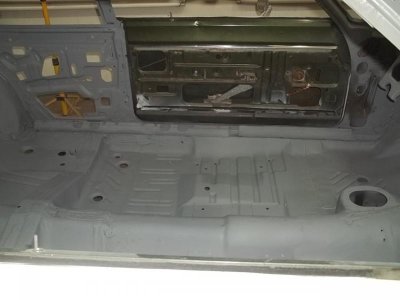

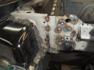

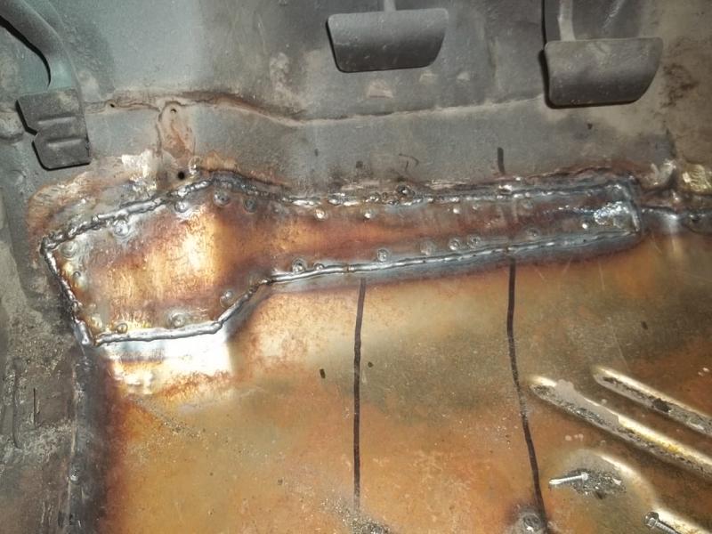

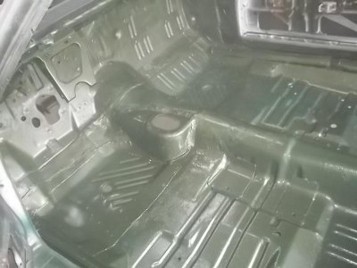

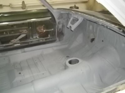

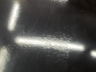

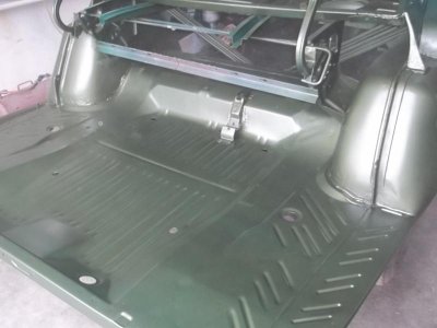

I have a question for you , . I noticed that after your welds are complete , you are doing more surface prep than I usually see. It appears like a factory job. Is there a particular sealer or a weld through primer that is neccesary. the reason i'm asking is that black coating on the panels doesnt look like primer to me and I'm wondering about future rust developing where my welds are? any information would be helpful , I am planning on doing a partial quarter on my' 66. thanks!
Good to know about the AMD panels as I will need them when the time comes. I'm seeing some excellent work you are doing here.
the only thing i've done on the trunk floor is grind the welds out. I take it down to the floor pan and hit it with 80 grit on the D/A. that will remove the manufacturers sealer/ primer/ rust shield. on all exterior surfaces I remove this. on internal areas I scuff the tar out of it with red scotch bright. all of my bare metal gets an etching primer then 2k primer. I only use DuPont materials. the 615/616 etching primer is very easy to use and I weld through and occasionally I weld through it. but I use an old end mill to remove anything in the hole before I weld. especially when i'm using an adhesive along with the weld, as I've done on this trunk floor pan. I also blast all of my welds. you can not completely stop the rust. no matter how hard you try. so I blast, grind, sand, etch, seam seal, 2k and paint. just to cover it up with as much material as possible, if you've done a good job cleaning up before hand, you can slow it down significantly. thats about all you can ask for.
remember, you will have to massage any panel you use. its the nature of the beast. I really do try to do a good job. that's all I would ask of my body guy. how about you?

68 post, thanks a lot for the info on surface prep! I was told years ago about that black coating on the repro panels, he said that I should sand it all off or I would have adhesion problems , but i noticed the guys on this site were painting over it, so I thought I would ask you to make sure I was up to date. Also thanks for the procedure for rust prevention at the weld spots, useful for a long lasting repair..Professional advice is very valuable !
