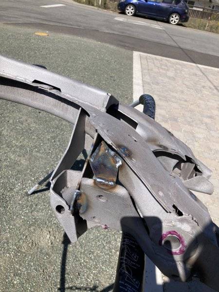

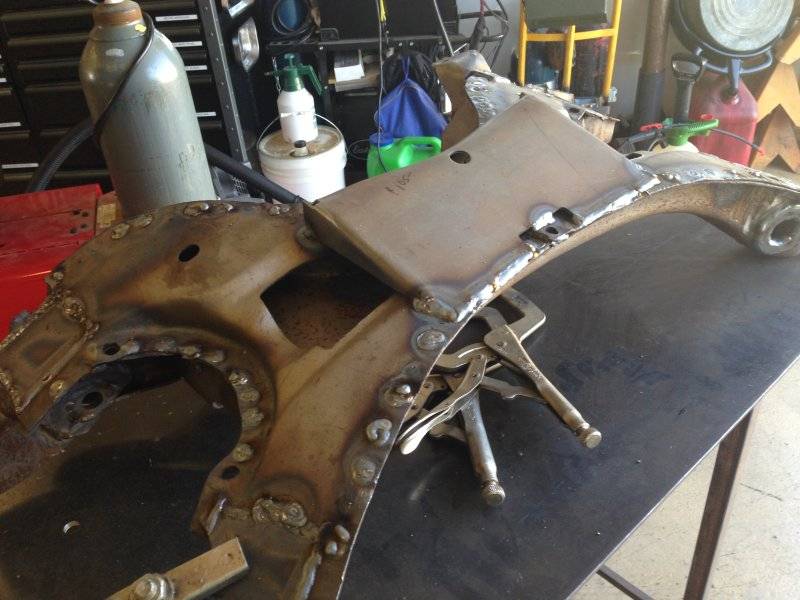

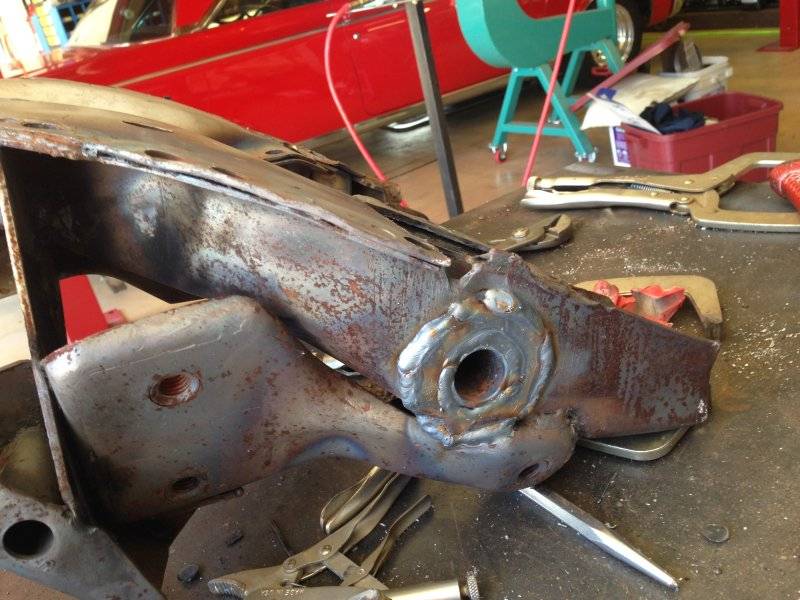

Are you a crafty sort with a welder[ or access to on], can do some fab work, have some metal pieces around for gussets etc? You can do something along the line of what I did to mine. After getting it tanked and clean, went wound the perimeter with my Rota Broach cutters and punched one of the two layers with holes. Added in 120+ welds in addition to the factory 30 or so. Put a skid plate on, added gussets around the steering box mount, cut a pocket to access the lower control arm tube so it could get welded on the inside, put cut out back on with weld, added big flat washers to both sides of the tube, welded them in, boxed in the strut rod mount area, added welds to the original strut rod mount on the k-frame. Got a pair of the lower control arm plates, welded them on
