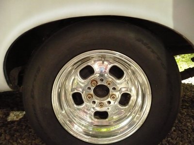

65 Hemi, that is an awesome lookin car , love the stance of the car and the look of your tires. Could you tell me what the size them tires are, I am looking to replace mine and now I would like to fill the tire wells up, I think I need a 29" high tire with a 10" tire tread not tire width tire to do that. Thank you.
315/60R15 MT drag radials

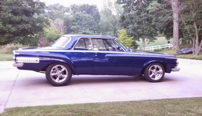

Here's mine. 225 70 15 on the front and 275 /60 on the back.
Thank you for the complements. Actually the car does sit up a touch in the back. It may not be perfectly level in the parking lot. I didn't adjust anything after adding the new wheels. The car has about 70 pounds in the air shocks. The rims are 15x7 front and 15x8 in the rear. Tires are BFG TA radials. I got a great deal on the rims. brand new landed at the door with nuts and stems they were 400 usd. They would have been double that if I would have bought them here in Canada. I used a black sharpie paint marker to black out the white letters before installing the tires.

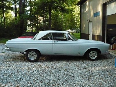

Hmmmm. My 65 satellite came with Mickey 30x12.5x15's and a set of coil-over rear shocks. I did away with the 30" tires and installed 275/60-15's including pulling the coil-over rear shocks but the tail end only dropped about 1-2 inches. It still seems too high to me. I like where the top of your rim is just under the fender lip. Maybe the previous owner installed some kind of heavier duty leaf springs if that's possible. I see 7 layers on mine.

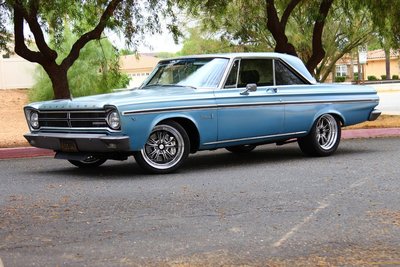

My current street setup... I had to get a good pic to submit for a car feature coming up. Turned out pretty cool.
235/40R18 F
295/45R18 R

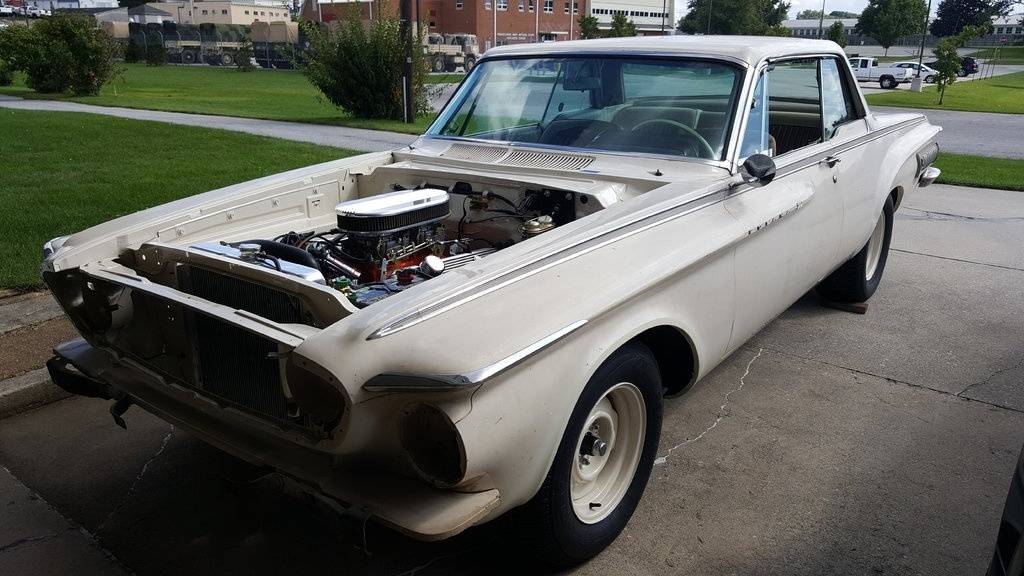

I guess I can submit my combo now. Car is nowhere near finished yet.
Cooper Cobras
225/70/15 on 7"w 4 1/4" BS (fronts)
275/60/15 on 8"w 4 1/2" BS (rears)
Did the taypered axel conversion to Dr Diff flange axels and Green bearings, original housing. Had to use 1/4" spacers with the rear wheels. Having a 4 1/4" back space wheel would have eliminated having to use them.
