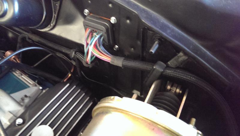

Here's a pic of the Deutsch connector used for my bulkhead if it gives you any ideas. My car was completely re-wired with the EZ Wire 18 fuse kit.
Depends on your motor/build... For my crate they recommended 2" primaries and 3" exhaust... I had 1 3/4" on my 383.

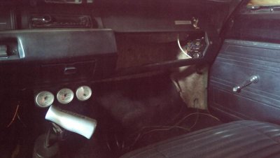

Hyrdgoon that looks nice,, whats a complete ez wires cost ,,I had to remove the glove box , and radio plate, to ,, reroute the A/C lines,, man its a mess thers a few spices in the fuse box , wires not going to anything , others have 2 or3 spices in them ,, looks as bad as the under hood,,, what wires havent been cut into, are stiff and brittle, im thinkin I need to replace all wires,,

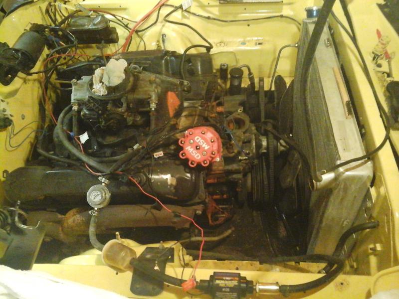

ill get that on its way, heres a picture of the electric fuel pump,, my question is where should it be located? Have to move it becouse of the ac line are going to be on the fender well, , dad had trouble with the mech. Pump, he said it flooded the oil pan with gas, so he stuck the elec. one on, and hehe a nail in the line that goes back to the tank,, and ran some wire too somthing with power,, hehe got to love him

Hey sorry I missed your question man but yeah the bulkhead would be the big plug through the firewall just to the left of your master cylinder, in the location goons connector is. The stock bulkhead connector is basically the huge square plug from the dash harness, with 3 individual connections for wiper motor harness, engine harness, and headlight harness
And ideally the electric fuel pump should be back by the fuel tank since they're usually designed more to "push" fuel rather than "pull"
The EZ wire kit was about $185.
It sounds like you have enough of a mess that starting from scratch might be a real good idea but will take time.

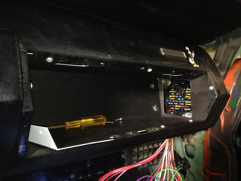

If you're looking for a place to mount a new fuse box since your glove compartment is out you can see where mine went
that deutsch connector didn't come with the EZ wire kit though just so you know

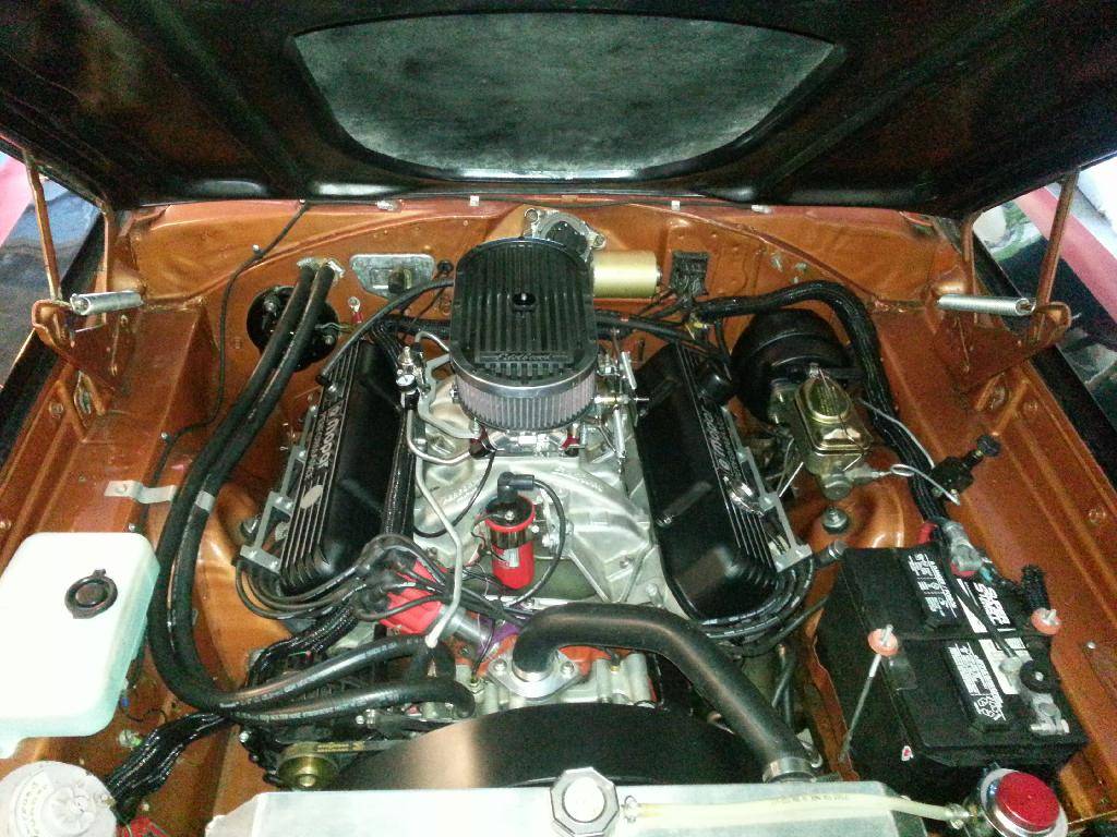

Bigmanmopar Damit man that looks good everything neat Y'all are big a help. This is a great site.
