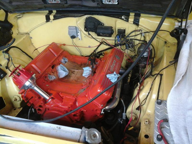

Iv stopeped taking apart and started puting back together, happy days,

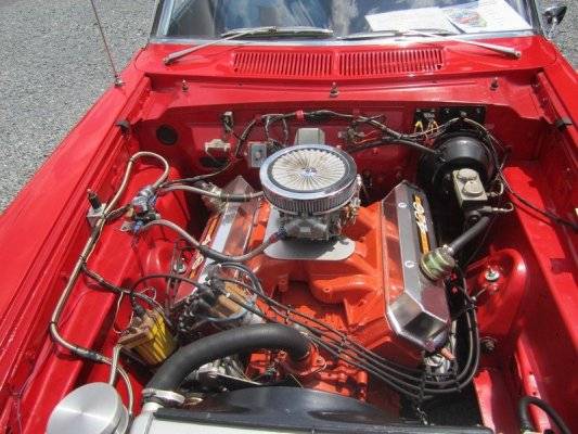

I got aluminum water pump, and intake tomorrow, well order it tomorrow.whats the holes in the head, the ones right in middle, dont look like intake will cover , im getting a mopar dulal plane aluminum, , the stock intake didn't cover ? Belly pan can I get one that will cover?

My wire harness under the hood is my stock wire harness but I cut it open and replaced much of the wires and added the wireing for the MP elctronic ign and the dual field alt. I did forget the tach wires so I had to add them later and I also added a small harness on the drivers side that I made for my electric fan. Ron

The extra holes in the head are heat risers that help in cold weather/climates. Most folks buy the valley pan that blocks them off to keep all that heat away from the carb.
Looking good. Keep it going.
I had to rewire my instrument harness after it was damaged from an engine harness short like yours. Don't cut the harness open, unwind the cloth tape (you can use it again). I had the vinyl non stick wire wrap tape so I did cut that. I only had one wire from the (ignition circuit) that was the issue. I replaced and rerouted it to prevent a reoccurrence, and used the cloth tape to rewrap it after I used new vinyl. Looks like it was never touched. There are pictures under "Steering Column getting warm" in this section. G

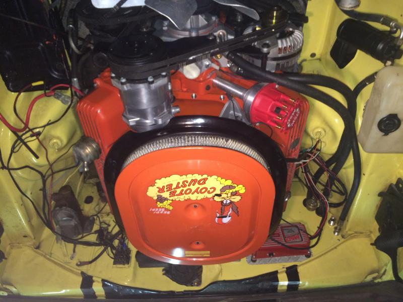

We'll Iv had the week off. Been working my car all week off and on. Hate too bring up old post but y'all just don't know how much this has helped me , I go back to and search all the time. Because im in over my head. I started out burnt wire Here's what been done so far. Added header ,painted valve covers , aluminum water pump, clutch fan ,mopar wedge intake, new holly car ,redone the a/c lines ,air grabber breather , had to cut base of cleaner , ground the extra bolt holes on compresser ,holly fuel pump install in back Now I can fix that burnt wires. Got my under hood wire. Said that was going with painless wire no, now I read the instructions way above me. I got factory harness. Plug in, got the seats out today , got room to work. Gauges and under dash harness is where I'm at now I seen gauges on ebay that have the dash panel all together After market new gauges but don't see any that have wood grain ? What y'all think about that set up?

Badmopar nice I was looking and seen no heater hoses. The looked and seen your in Fla must be nice no heaters, motorcycles year round . Looks good
thanks for the help this engine bay is unreal how clean it is
where the hell is everything at? in the radiator hoses?? lol
thats how i want my bay to look. very nice sir!!

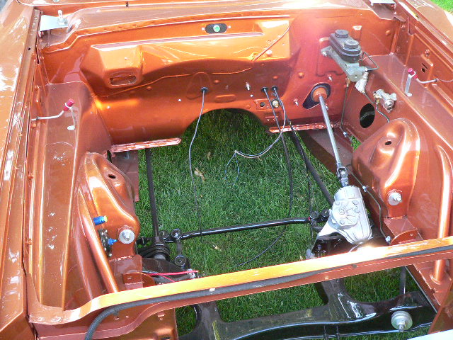

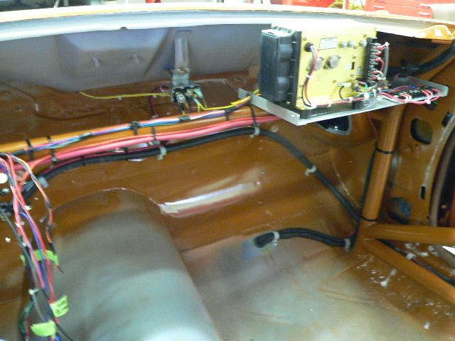

Wires run through the right frame rail. There is a bulkhead on the drivers side for the starter. You can see the bulkhead between the shift cables.The rest are visible near the right side motor plate tab. Bottom picture shows where it goes through the floor into the frame rail.

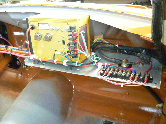

My plan is...
I come from a combat aircraft background so my plan is to make all of the wiring hidden as much as possible, pretending that I don't have the room to put it in the stock areas, and I will also lock wire anything I can. I have a plan to fab some engine bay covers and firewall delete stuff, smooth out bumps and cut off wire holders etc...I hope to only be able to see the motor, headers, and wiper motor. We will see how close I come to my ideal...lol. The lock wire will be seen on the dash in spots and on a kill switch with brass wire. I intend to use dzus fasteners in many places. Going for a aircraft clean look but mean as hell and all business. I guess I miss my Apache...lol.
