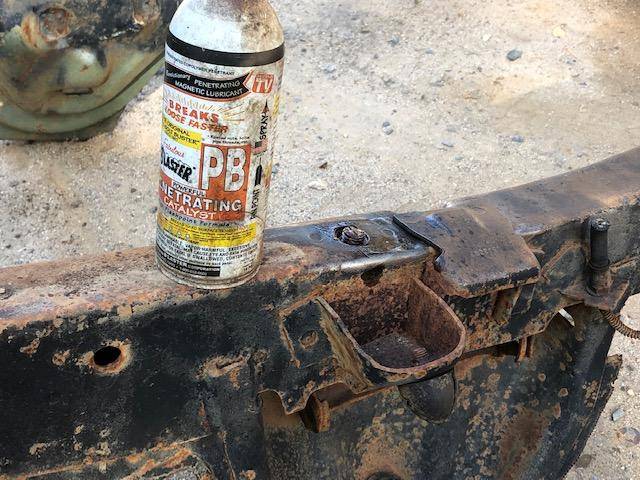

I soaked it in PB blaster:
But even after I drilled through it, I started thinking that it might come out easier if I welded another fat bolt on it and cranked it out.
Anyone else have an idea on how to extract this thing?
I have found what works the best is to weld another nut to the remaining stud. The heat from the weld will help loosen up the rust. It should turn out fairly easily, but if not and your weld breaks, just weld on another nut and try again.
It works!

Easy peasy, huh? A buddy showed me that trick a few years ago and I am always amazed with the results. I think back to all the time I used to spend drilling a hole in the bolt and then trying to get an easy out to work.
Yeah...I have broken off several of those "EZ Outs" over the years!

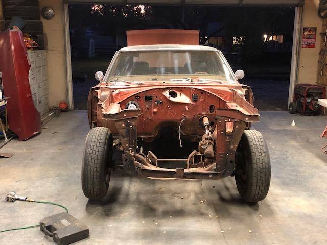

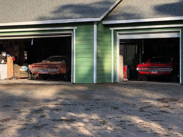

And....SO it begins!
I pushed the car from behind my shop to the front just by myself...on foot. Man, when the entire front end is off and there is basically nothing but suspension and steering, this car is really easy to move!
I used the Power Wagon to push it the rest of the way into the shop.

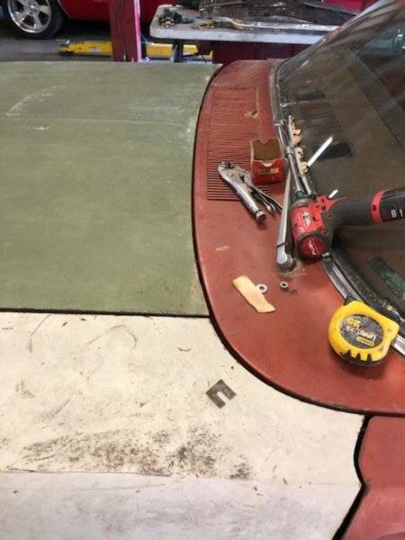

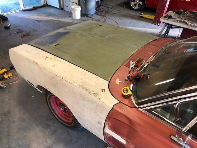

I mocked up some sheet metal to see how stuff lines up. As ElDubb 440 was saying, the sheet metal will dictate what is square and what isn't.

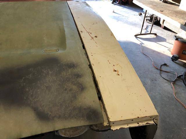

With the fender gap at the cowl and at the fender set with paint mixing sticks as a gauge, I laid the hood loose on the car.
While not exactly scientific, I used another stir stick to set the hood to cowl gap. Bad news though....
I see a 7/8" gap where a 1/4" gap should be. This means that the left rail and apron are shifted over to the left.
I was able to shift the fender over to close the gap some but it has me wondering if this rail needs to be pushed back to the right. I measured the '70 Belvedere stub and the XH rail looks to be 1/8" to the right at one reference point. I don't know how close their tolerances were when new so this may be within spec. I am guessing that the substructure can be a bit out of whack but with shims, ovalling out mounting holes and some other tricks, the sheet metal can be made to fit. Obviously I'd rather that it all fell into place because I figure that if the body has to be pushed, shimmed or adjusted beyond the norm, what are the chances that I'll be able to align the front end the way I'd like?

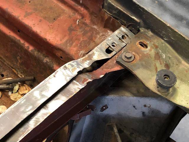

The 1970 Belvedere and Charger core support has a different mounting pattern at the top.
Belvedere/Charger below:
THis '68 Satellite top bar is different. One hole in the center instead of two oval holes.
Not a problem. I have a spotweld cutter and a welder! Looks like I'm going to piece this together with a series of parts.

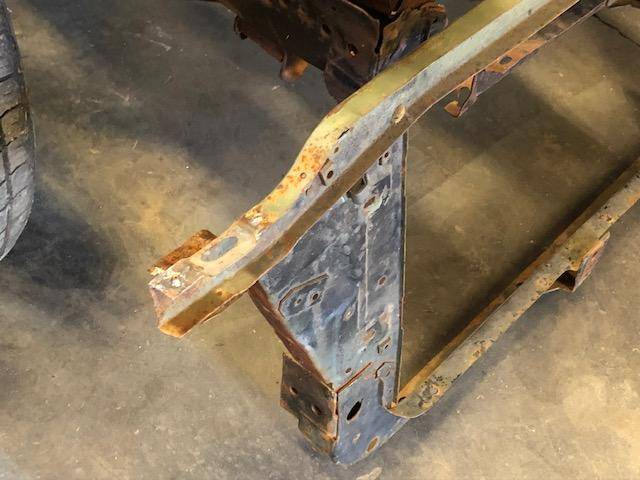

The front suspension and K member is out. Oddly, the K member measures out to be square. I thought that it was bent!
It could still be corkscrewed. I'm going to set it on wood blocks to see if it sits even at all 4 points. This is just for kicks...I have the other K member here with the sway bar in it, tabbed LCAs, etc.
View attachment 870542 View attachment 870543 View attachment 870544
You need to pull the frame on that car, its too far out for shims or elongated holes.
You can rig up a come-along or a cherry picker to make a pull.
Check this out.
  • BodyStraightener.pdf
make sure the very front fender bolt (on the inner fender) is tight. this will pull the fender in as far as it will go...... you're probably gonna need to "cross measure" a couple of things
KD.........the only possible hiccup I see, is the outside chance that the driver side rail was moved a little in the accident. we'll cross that bridge when and if you get there
yep..... saw it coming, we can deal with it
