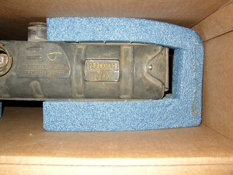

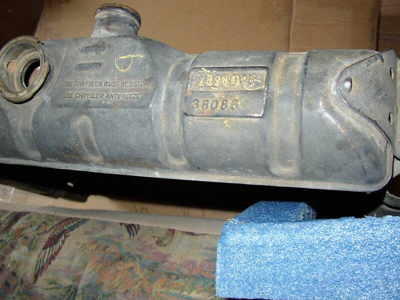

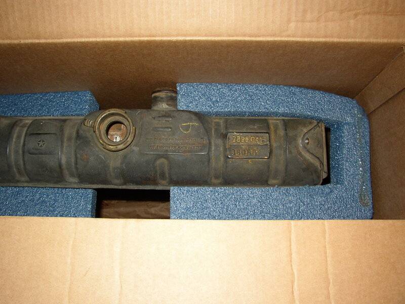

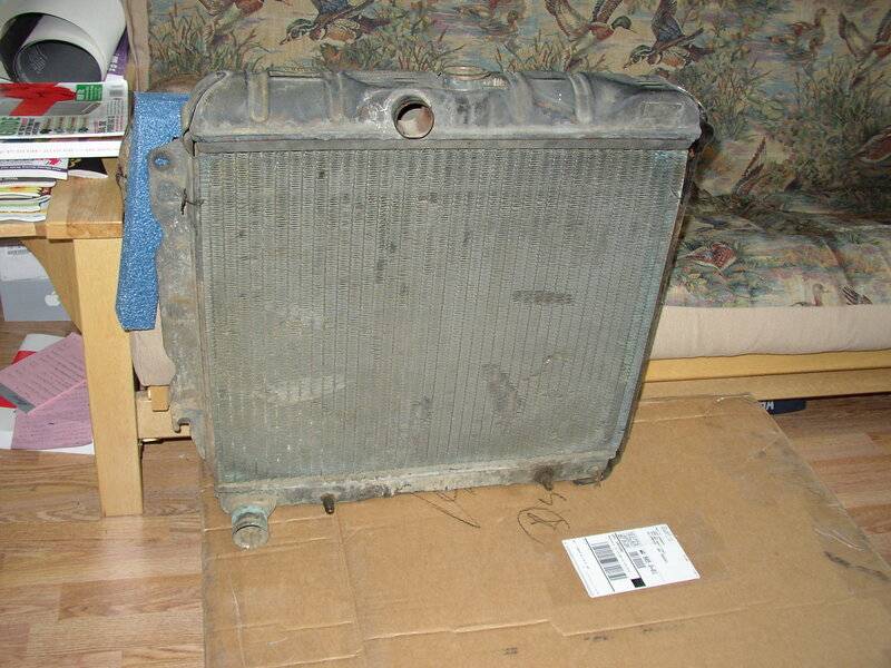

Here is my OEM 22” radiator for my 68 Coronet 383/4bbl H code/727/no air car. The number on the radiator matches my factory parts catalog.

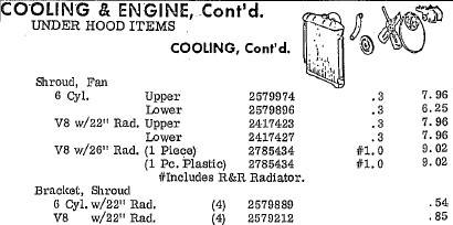

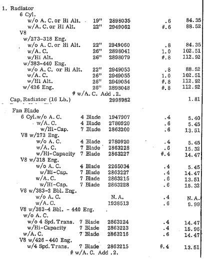

Just found these images from a parts catalog. 22” shroud...upper and lower with 4 brackets...that sounds like a pain. Apparently the 22” OEM shrouds were metal, 2 part that bolted together. Sheesh the shroud costs as much as the radiator.
The 26” got the one piece plastic shroud.

View attachment 1110200 View attachment 1110201 View attachment 1110202 View attachment 1110203
View attachment 1110212 View attachment 1110213
