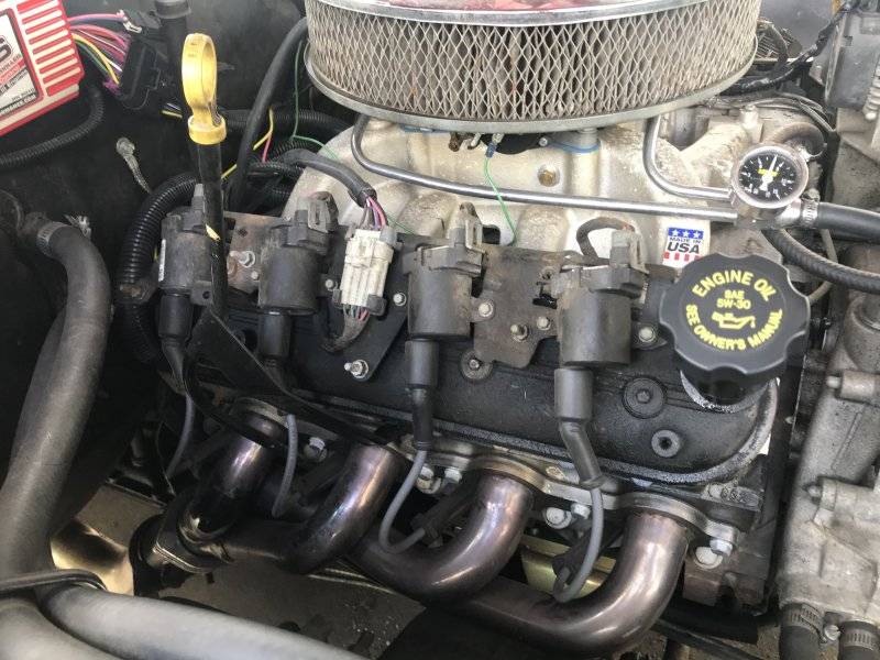

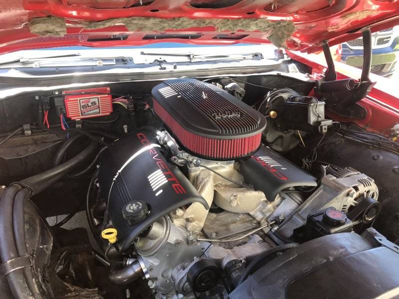

In fairness to the topic. The Cutlass already had a 4.8 LS engine in it. So I did nothing to the car other than swap in the 5.7 all aluminum engine and add the Sniper.
