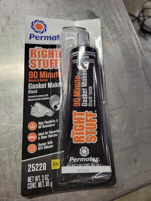

I bought intake gaskets but the ends are cork. Where can I find a set with silicone ends that you would recommend?
Thanks
The silicone will be in a tube that you squeeze into place. I like permatex right stuff brand for this. I have never seen intake valve seals cause hesitation like that, just smoke, and have seen them deteriorated down to failure.
On the loctite 518 it is designed for metal to metal connections, it dries from the absence of air. It may work but I don't know. With an intake paper gasket I would use permatex #2 tube or #3 brushable.
