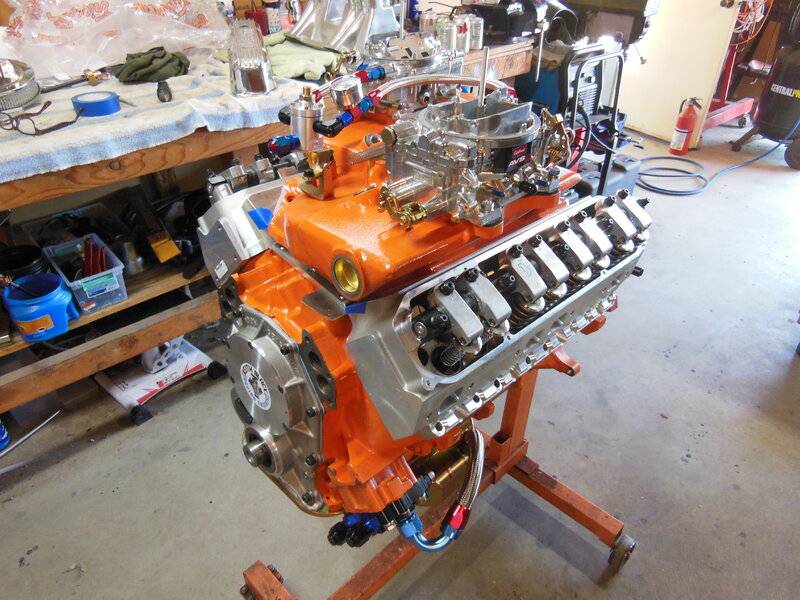

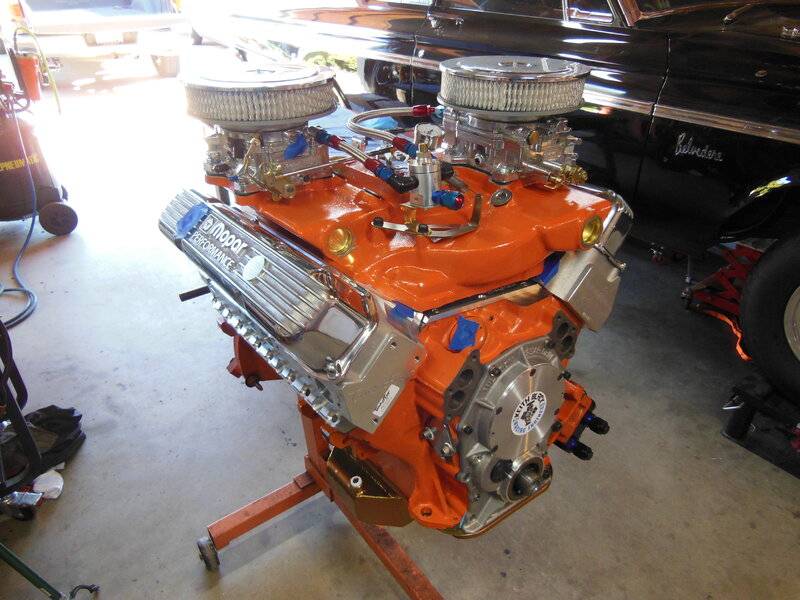

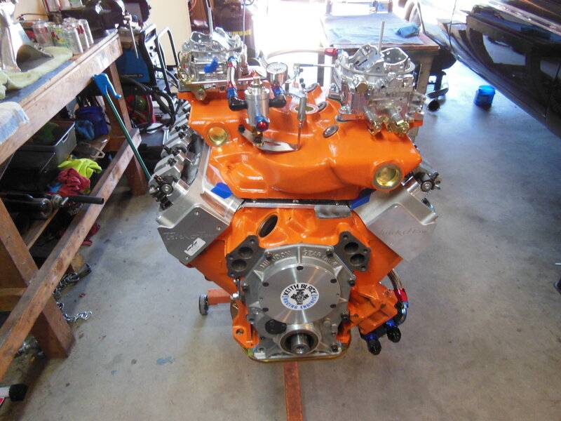

recieved my TF 270's this week ! mocked it up ready to measure for pushrods. basicly the same motor as tested. almost,,446 with a CC solid roller with 1.6 T&D rockers, gives it .667 total lift less lash and 266 and 272 @.050. A&A crossram with avs2 carbs. 10.7-1..have to make up a custom pushrod checker. rocker arm geometry was set up by B3 racing engines :thumbsup:
Those X-Ram intakes sure look fine, and apparently A&A did a great job of hogging out the one in the first post.
Do they "come" modded or are they copies of the factory X-Ram and they have porting services as an option?
That mill looks FINE!
I'm jealous..who did the TF270s come from and how long did you wait? I'm being told none available anywhere...
