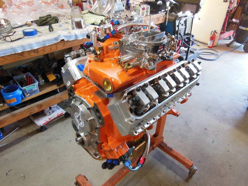

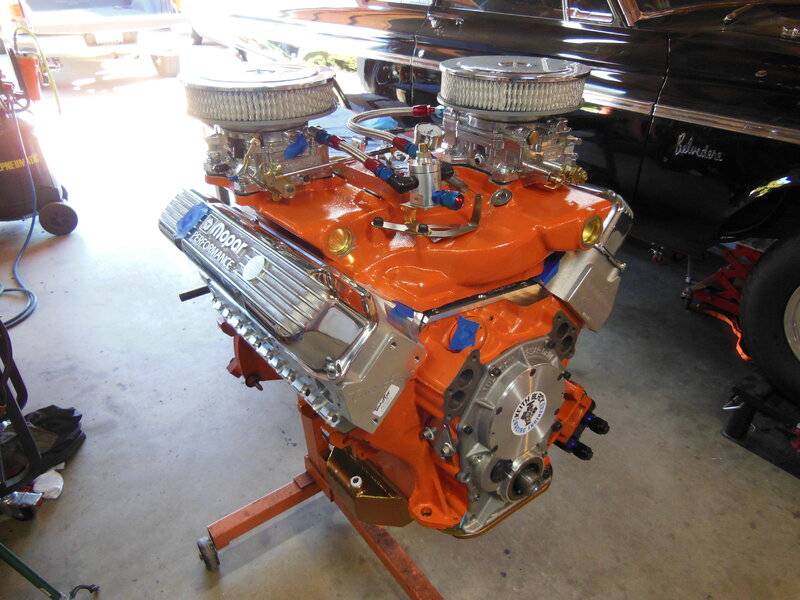

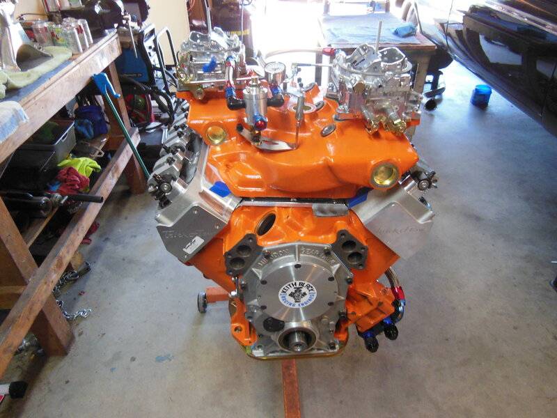

recieved my TF 270's this week ! mocked it up ready to measure for pushrods. basicly the same motor as tested. almost,,446 with a CC solid roller with 1.6 T&D rockers, gives it .667 total lift less lash and 266 and 272 @.050. A&A crossram with avs2 carbs. 10.7-1..have to make up a custom pushrod checker. rocker arm geometry was set up by B3 racing engines :thumbsup: View attachment 1238487 View attachment 1238488 View attachment 1238490
Very nice Tony! Just as a clarification for those interested, those aren't standard T&D rockers. They are custom made for us to our specs and are only available through B3 Racing Engines. They are the ultimate in a single shaft Mopar rocker system.

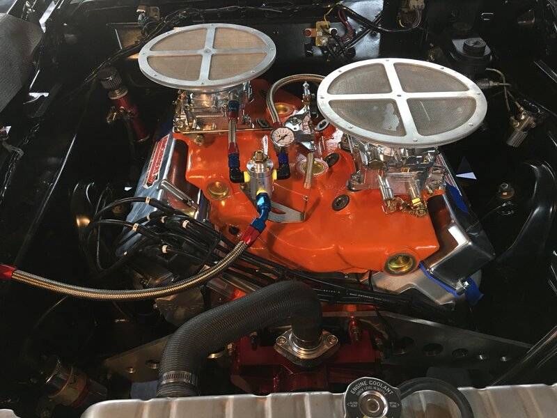

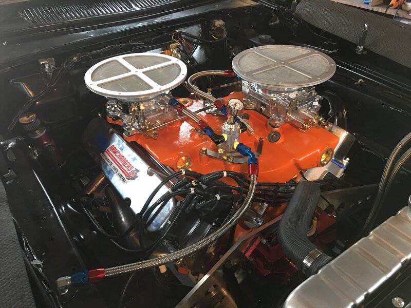

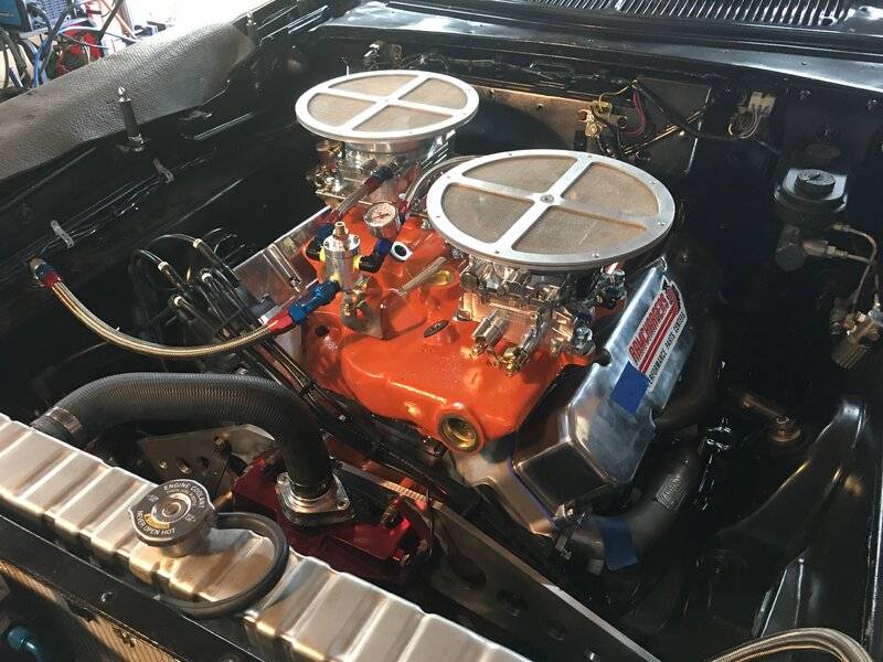

almost ready to start ! replumbed the spark plug wires today with accell ceramic pieces. will spin it over before starting to check cylinder pressure as to whether i need to run race gas,,compression calculates out to 10.5 using round numbers..dynamic calculates at 8.49..bought a 5 gallon can of VP to mix in just in case...28.00 a gallon !:wtf: i hope i dont need it...motor specs r close to the original unit.

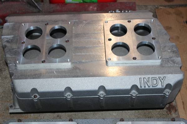

I'm gonna be using this Indy style intake on my 62-413ci maxie...
almost ready to start ! replumbed the spark plug wires today with accell ceramic pieces. will spin it over before starting to check cylinder pressure as to whether i need to run race gas,,compression calculates out to 10.5 using round numbers..dynamic calculates at 8.49..bought a 5 gallon can of VP to mix in just in case...28.00 a gallon !:wtf: i hope i dont need it...motor specs r close to the original unit.View attachment 1264569 View attachment 1264570 View attachment 1264571

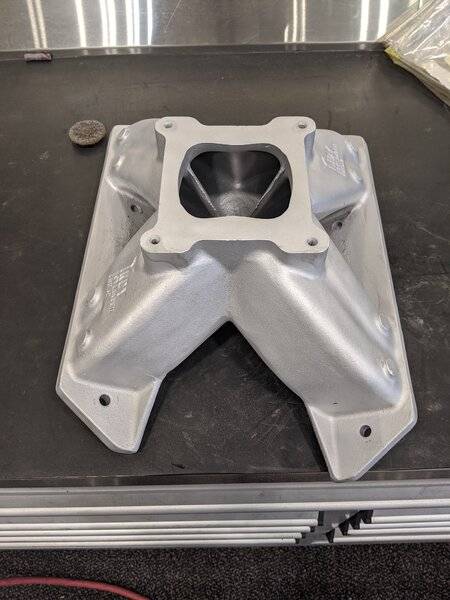

@polyjohn is this the Indy 440-25 intake?
I'm building a BMP aluminum RB 572, and I am going to use a Max Wedge port size Indy ModMan with a 6bbl top but I'm intrigued by the 440-25, and I'd consider a 6bbl top being made for it.
motors up and running ! sounds great,,,.675 lift and 272 - 276 @.050 CC roller. compression test came in at 155, so i should Not have to use race gas running around at the car shows. tuning to continue next week, AFR gauges/sensors will be installed before firing it up again,,looking forward to trying out my Electric power steering !
