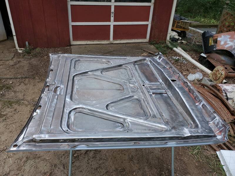

On to the next project . . . the Hood . . .
Here's what I've got to work with . . . just started . . .
After 2 hours with an "old" cup type wire knotted wheel . . . progress was slow . . .
So I went and get a "new" one and tore into it . . . MUCH BETTER !
Note to self - buy a NEW wire wheel when starting a new project . . .

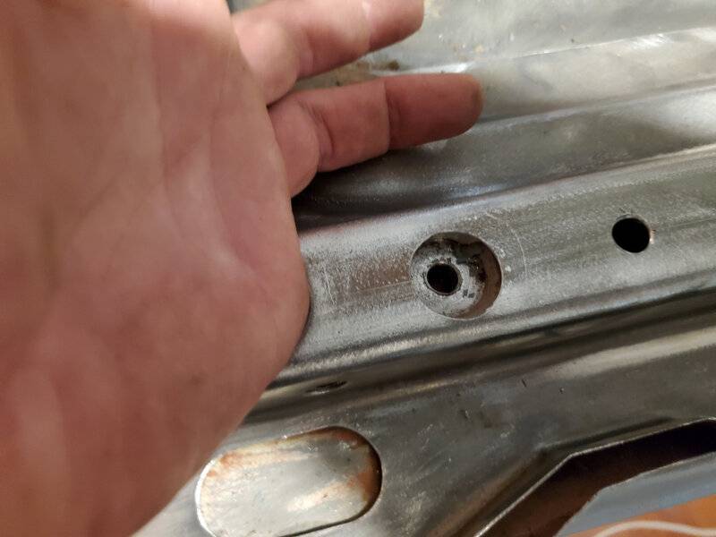

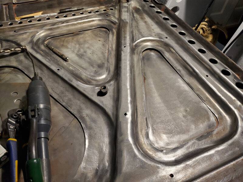

Now to figure out the layout of the holes . . . looks like I might be fabricating a new dimple die for this project too
Created a 1" and a 1/2" dimple die for the trunk lid project ( needed to fit into the tight locations)
with no "easy" access holes, like in the trunk, getting started on this hood was a whole lot harder . . . everything is blind and no way to get to the back side to hold the cutting parts . . .
But I've finally figured it out and now I'm making some progress . . . . the first set of 4 holes took me 2 hours . . .
BUT . . . got them done . . . Oh, the 4 holes are to match the trunk lid and like them both look like "maybe" there was some planning in the layout . . . maybe ? ! ?
You can see the bottom of the dimple die in the hole - and see that there is very little access to work with it and get it attached to the tool to make it work . . .
In comparison, the next 9 holes were done in less than and hour . . .
And I'm starting a new collecting of cut outs for the hood - not that it'll remove a lot of weight

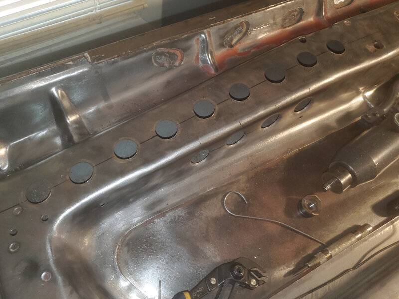

Now it's time to get back it, got a lot more holes to get in the hood and get them dimpled
With all the rain from Hurricane/Storm Sally . . . I got a chance to "try" and focus on getting more done on the hood . . .
Working in these confined spaces, with holes so small I can't get my fingers through . . . means being creative . . . and finding method that will work.
But . . . got the next line of holes completed today . . . ( thanks to the rain )
Got more holes to get drilled, punched, and dimpled on this project . . .
Adding more holes in the hood . . . getting the tools to this concealed area is difficult and interesting . . .
But progress was made and I'm getting it done . . .

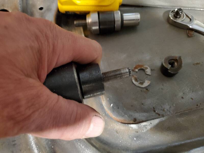

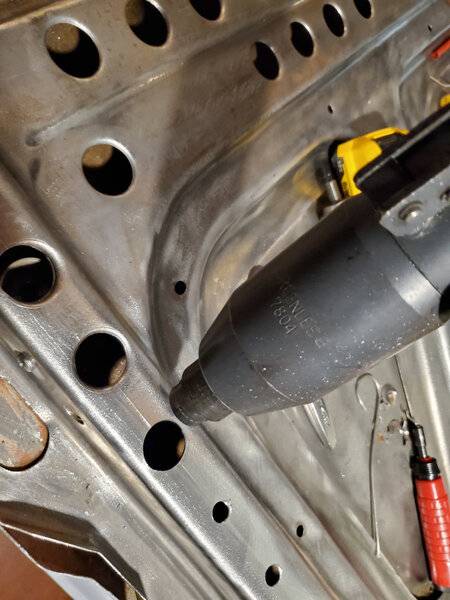

Got an issue with the bottom dimple die binding on the bolt when it's dimpled . . . not sure what's going on an I need to get this fixed.
More fabrication work . . . on this side, the 1.0" dimple die would not fit . . . so I had to make another dimple die measuring 0.9" . . .
And the result is that it worked great . . .

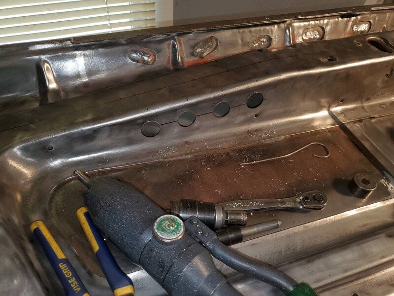

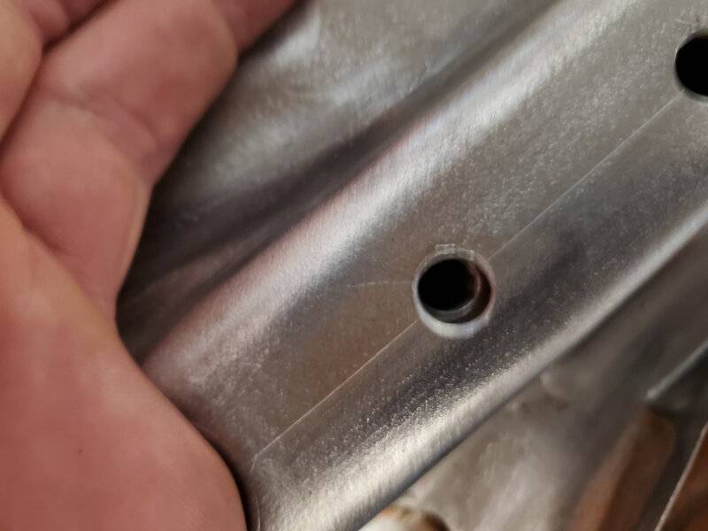

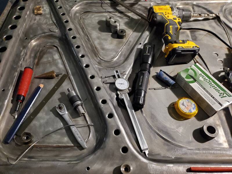

How to make these holes and dimple die them . . . here's my step by step process . . .
First - the holes are laid out and drilled to allow the Greenlee tool to go through the hole ( the hole going to the right and up on the screen )
From the previous dimpled hole - drop the cutting die into the opening (access to this area is not very easy )
After the cutting die is in there, get a metal rod into the center of the cutting tool, and use my finger to raise the cutter up to the top . . .
Position the cutter on the hole so that the threads from the Greenlee tool can get threaded on the cutting tool under the metal . . .
Holding the cutting tool up and in place, thread the bolt into the threaded cutting tool . . . then just pump the tool and cut the metal . . .
Metal is cut . . . and hole is made . . .
Remove the cuttings from the tool ( for the next hole ) . . .
Debur the hole, the edges are very sharp and I got tired of getting cut up . . .

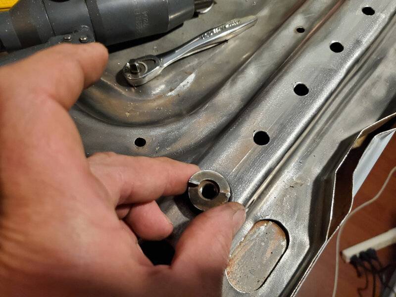

The bottom piece of the dimple die was already maneuvered into position through the hidden access maze of the hood . . . move it from the last hole over to this next hole . . .
You can see the bottom die in the hole . . .
Move this bottom die up into place to be able to thread the bolt into the hole . . .
Thread the bolt into the bottom die . . .

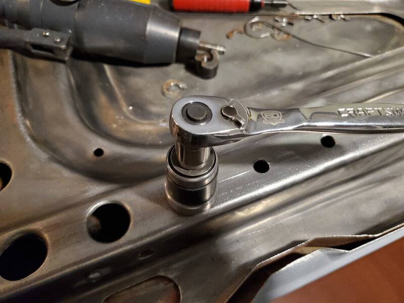

Yes, the Greenlee tool could be used here too, but swapping the parts was getting frustrating - so I use one tool for each operation to simplify the process *( in my mind)*
Tighten it snug and make SURE the bottom of the top die is properly in the cut out hole ( I messed up one on my trunk - learned my lesson )
Tighten the bolt until it gets snug . . . then loosen it . . . and remove the tool
The finished product . . . dimpled hole . . .
Repeat "umpteen" more times for all the holes . . . and you're all done . . .

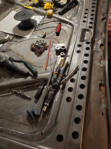

More Hood fabrication work . . . only got 2 more runs that I want to get done . . .
Here's where I want to put them . . . but they already have holes in them . . .
Hummmm . . .
Measured the holes and they would not allow my "existing" 1 1/2" spacing or I'd have a FUN time with those existing holes . . .
So measure . . . calculate . . . layout . . . and get 'er done . . .
One more run ( the other side ) and I'll have this hood "matching the trunk . . . and ready for paint ! ! !
Wait, found some bad areas that will need some welding and metal moving . . . but not much . . .

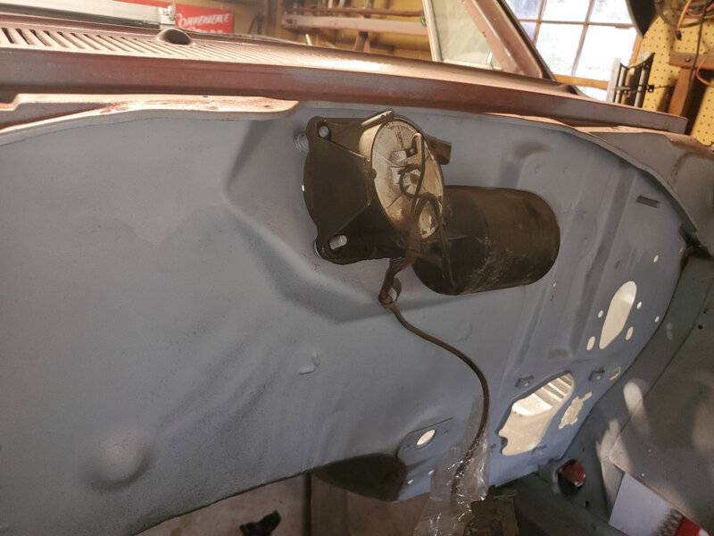

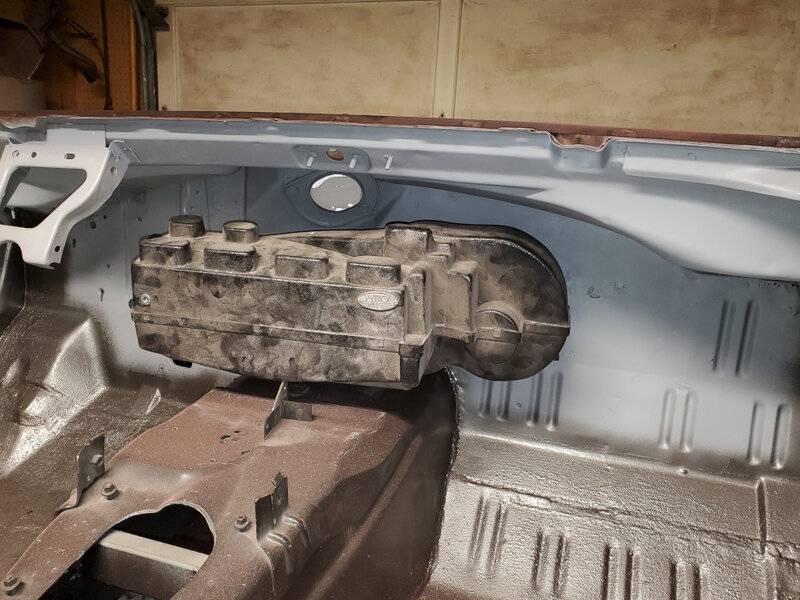

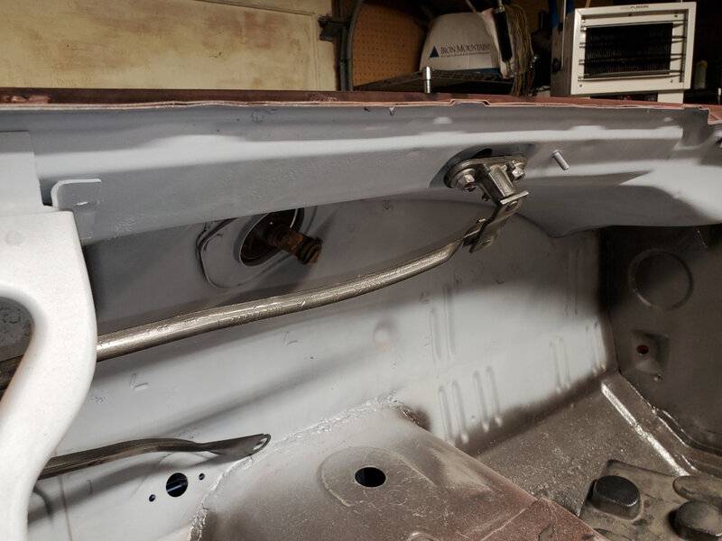

First . . . need to get this after market A/C unit mounting figured out . . .

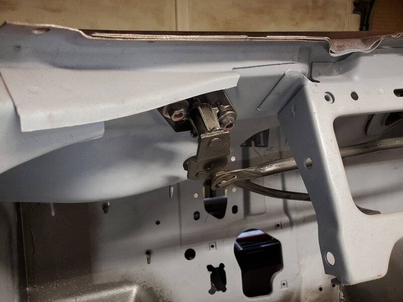

Then I realized that I need to know "where" the windshield wiper motor and pivots need to be . . .
So the hunt begins . . . where in the heck did I put that thing
( are you sensing the cause of my frustrations . .. yet - uh - where are the nuts ? ? ? ARGH ! ! ! )
Then the wiper pivots ( actually found the nuts for them . . . that was amazing )
So after FINALLY finding the nuts for everything, and getting it all in place, I realized that the wiper motor is NOT going to work . . .
Not when that 5.7 Hemi gets shoehorned into the engine compartment ! ! - - - - ARGH ! ! ! !
BUT . . . for the first time ( wait, the new K-member . . . that's right . . . ) Okay, I'm actually putting parts ON the car . . . YAY ! ! !

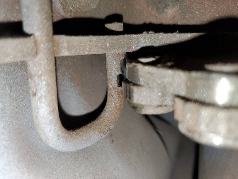

Then there's this that I noticed . . . this is the spring for the driver door hinge . . . and it is worn 1/2 way through the spring . . .
That's going to need to be fixed . . . oh boy, more things to work on . . . just what I need . . .
Now . . . go back up and look at the top picture with the wiper motor . . . after spending about an HOUR looking through all the bagged and tagged plastic bags in the 2 boxes that they're stored in . . . I finally walk over with a couple nuts from my hardware stash to get it held in place . . .
But . . . look very closely at the bottom of the picture where the electrical connection for the wiper motor is hanging . . .
What do you see . . . look closely . . . see a plastic bag wrapped around the electrical wires . . . maybe ? ?
Guess what's in the plastic bag . . . on the wires . . .
You guessed it . . . the nuts for the wiper motor the I just spent an HOUR looking for ! ! !
I didn't know whether to laugh or cry . . . ARGH ! ! !
