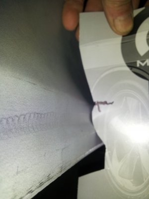

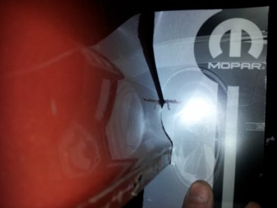

It might be the color that is throwing my eyes off, but the "valley" in your flare looks bigger on the old one than the new. Also, the lip that goes underneath, I don't see it as much as I do on the painted piece. Unless the pictures are from a different angle. Lastly, in the bottom photo at the 1/2 inch mark, it looks like there is a "ridge" that I don't see on the painted panel. If i'm wrong on any of these, i'll blame my eyes or it was the color that threw me off.
Can you take and mix a little body filler and put it on some wax paper and form it on the flare, let it set up and then put it on the other piece to compare any difference.
