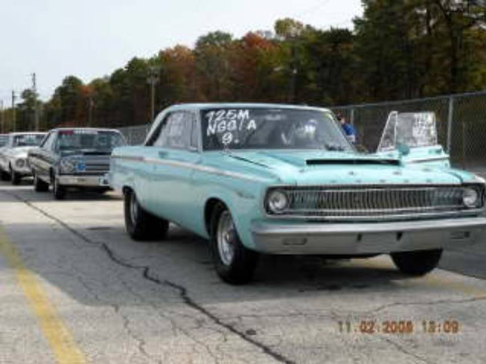

Sounds like it's going to be badass! I believe i've seen your car at Acto Raceway before and that second picture looks like you've been there lol
