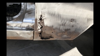

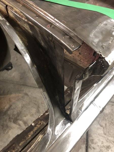

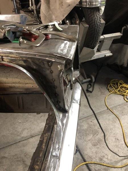

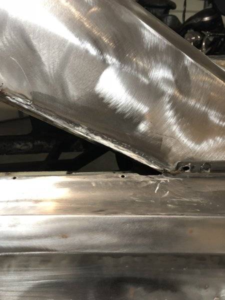

One more rust spot gone little bit more welding to do still on the patch and some cleanup glad to get rid of the hole tho lol
853878E9-60F9-4728-8190-6852BDDBC448.png 3F387B6F-1D50-47C0-9C4D-5E8716F7653F.png

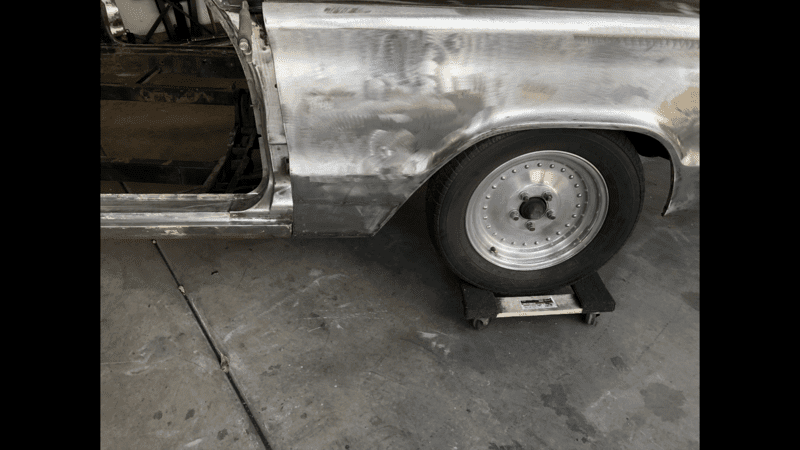

Forgot to add theses pics spent most of yesterday working on her hoping by at least the end of June to have her in epoxy
60FA4791-B10B-4795-90F1-19307AC5417D.jpeg 33BA504A-24F4-4FFF-B132-01D613DCBEF1.jpeg

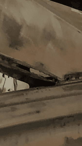

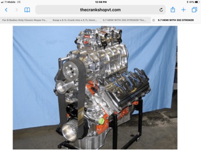

So i figured out what way im going with my motor and it also fixes the Bigass hole in my hood two birds with one stone :rofl:
Tore the motor down last night heads are junk but i was going with later model heads anyway i was mostly after the block first new style hemi ive had my hands in there is absolutely no duration on the cam lol now i know why a mild cam does wonders for those motors now off to the machine shop to be hottanked bored and line honed and decked

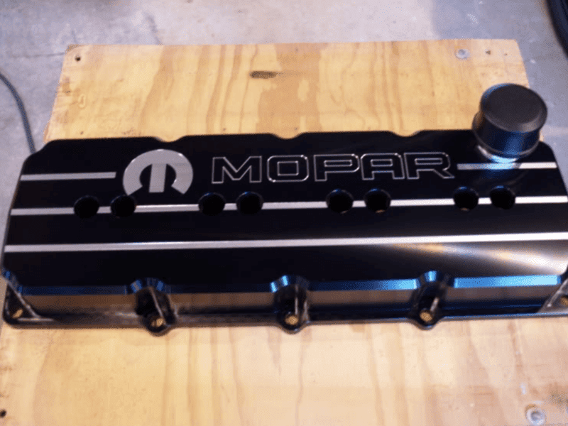

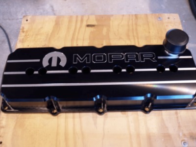

Found a pic of these valve covers that i want Indy said they could engrave a set for me to match them thats the only thing i cant stand about the gen 3 Hemis is the coil pack valve covers im going to use there modman blower intake and the coils hide underneath it should be clean and a compleat pain if i ever have to replace a coil lol
