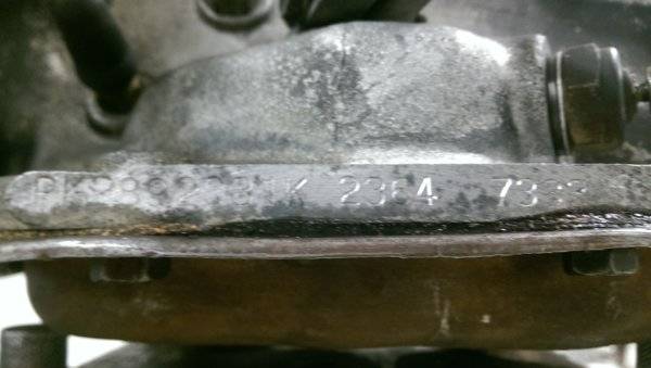

Snap, forgot to post this pic as well, Thanks!
PK2892031K 23647333
PK = Kokomo IN
2892031 = A727 1968 for 383-4
2364 = Wednesday, January 17, 1968
7333 = 7,333rd transmission built that day

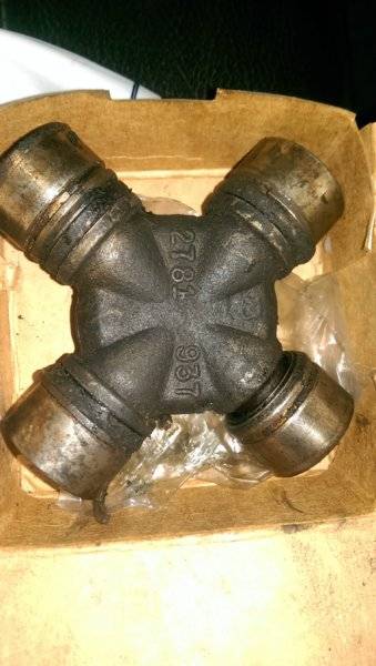

The "Detroit" U joints, do they have PN's on the other side of them?
Can you post good pics of both sides and the end face of the end caps......

Quite possible they still have the factory c ring strap retainers. My original is also stamped Detroit.
Just for curiosity, is this the same high end shop that you went to previously or a real transmission shop?
Trying to find out if they are the big versus the small joints....7290 and 7260's had the detroit stamp on one side....all factory joints had the c clamps and strap in the rear...

The casting numbers on the transmission in your pictures don't mean much. Can't help you with the block numbers on the bottom of the oil pan rail, but they have to do with the machining of the block when new.
If you are looking for the engine & transmission numbers to be matching for the body, they would be stamped in the top of the bellhousing & block flange as you see here...

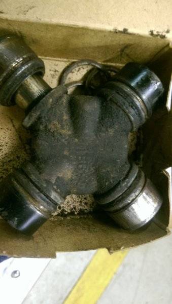

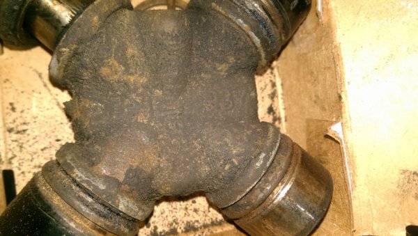

Hey All. Hope you're all keeping warm. Just an update, transmission was installed about a month ago. Here are the pic's of the U-Joints that came out. Instrument panel is at D&M Restoration (http://dandmrestoration.com/) and I hope to have it back in a few weeks.
