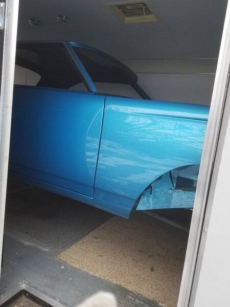

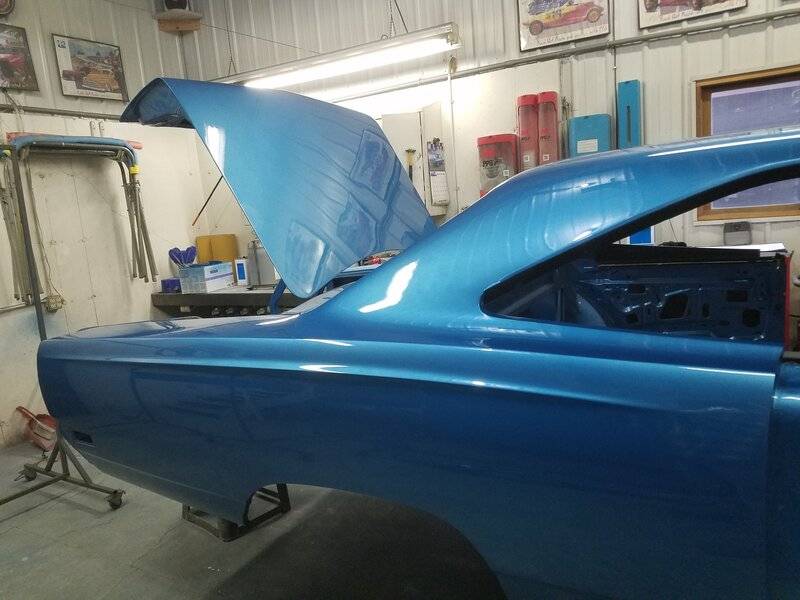

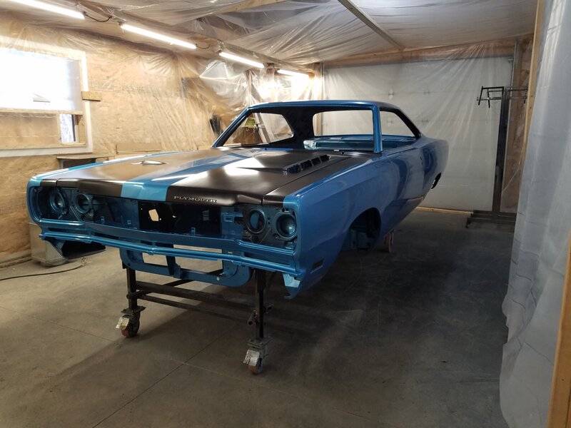

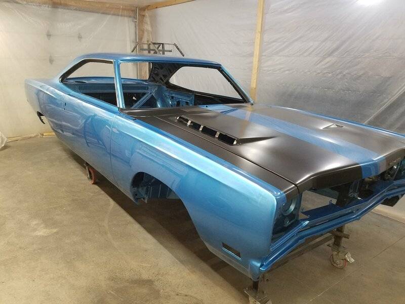

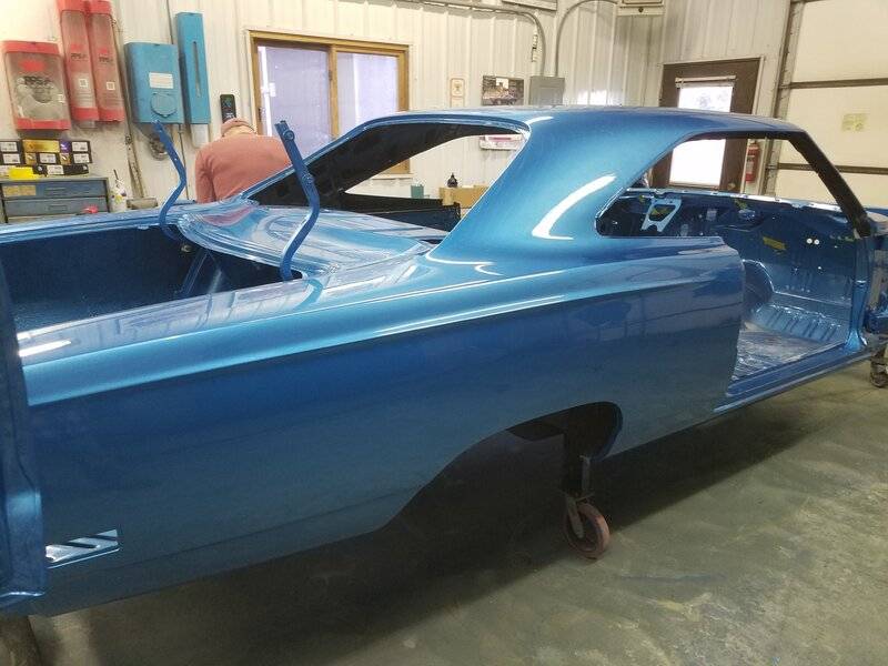

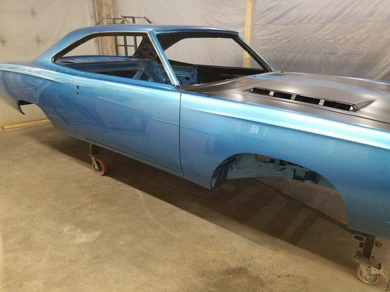

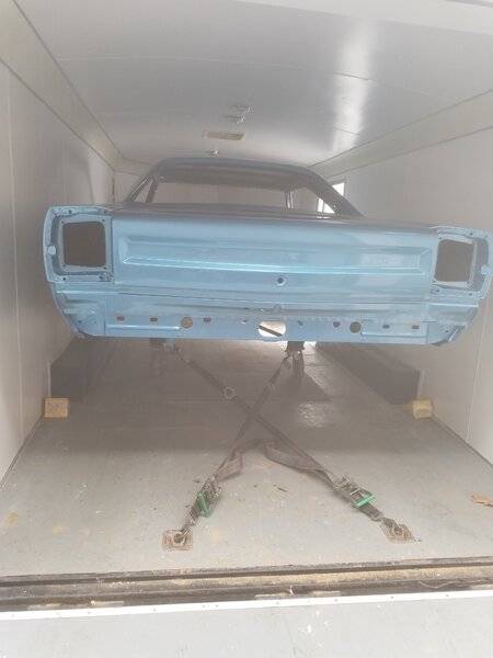

Good luck with your transportation issues. Look at @dadsbee picture with the crossed straps. That is a necessity.
Also, don't forget to put foam or rags or some kind of protection between all seams like doors, hood and trunk (especially the trunk) . Without weatherstripping they will rattle around and chip the paint on the edges (ask me how I know ).

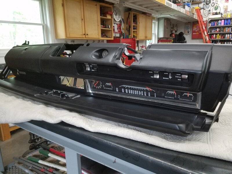

Looks great so far!
