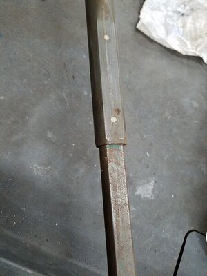

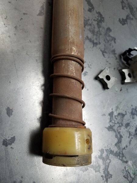

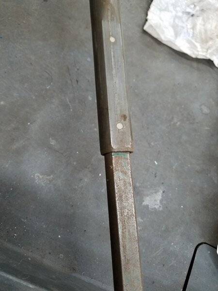

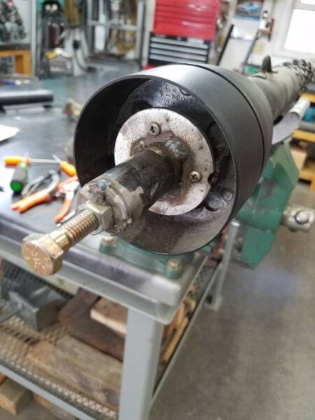

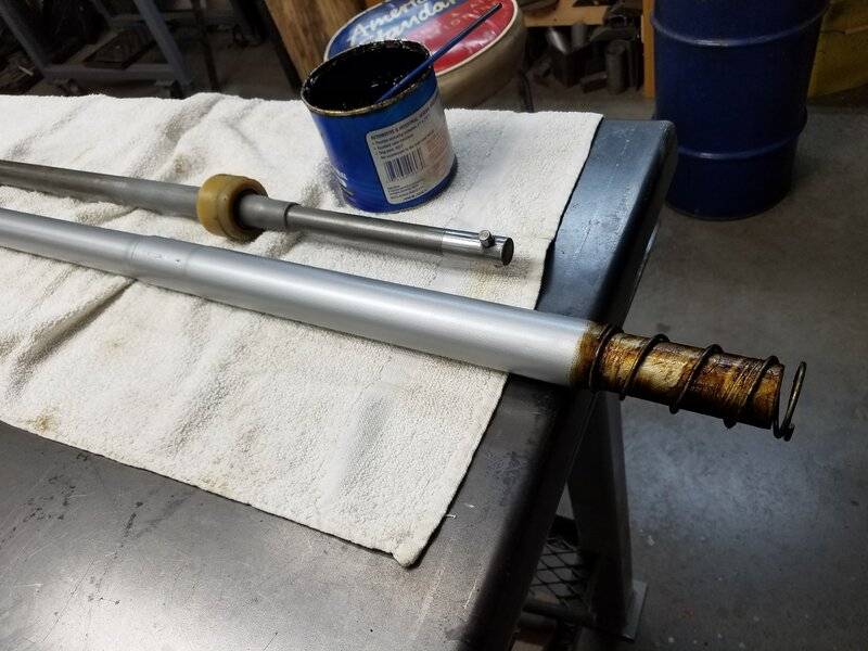

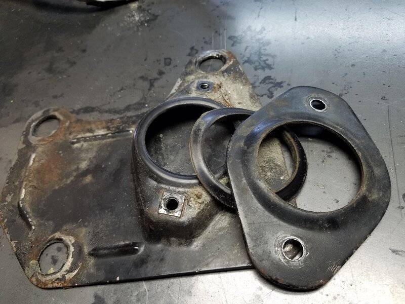

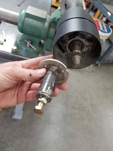

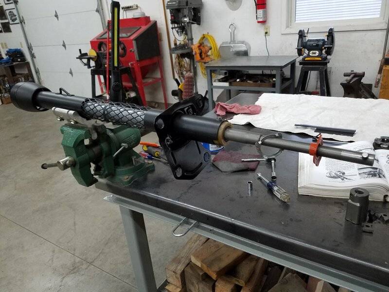

Decided to tear into the steering column next. Wouldn't surprise me if this was the first time its been out of the car. Didn't look to bad on the outside because I spray bombed some paint on it 16 years ago. A cobbled up tool I made several years ago to push the shaft out from the bearing. Interest factory mark on the shaft. Looks to not have moved through all these years. Shot of the bottom end showing the surface rust (did I ever mention how much I hate rust?)

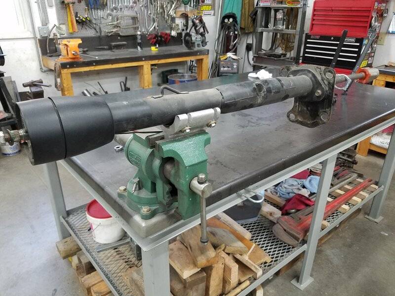

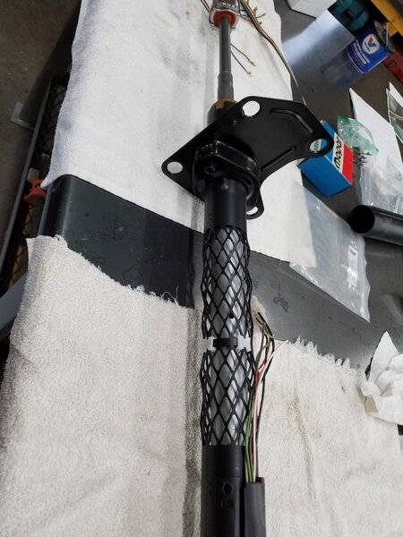

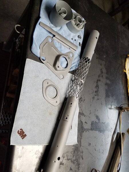

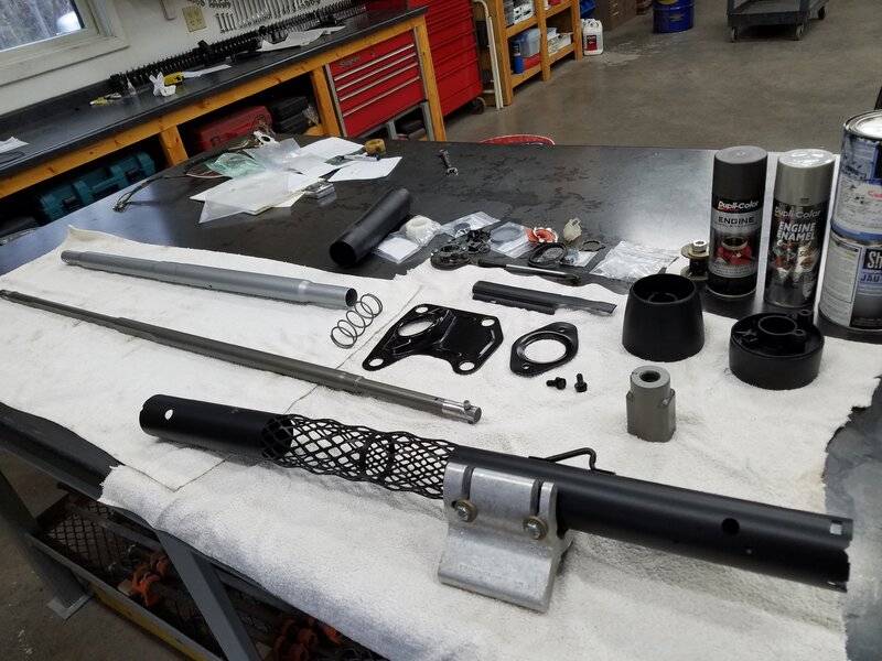

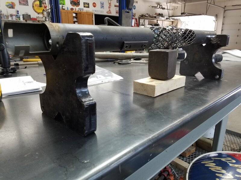

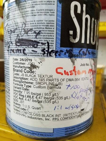

The outer tube was just a tad bent. Not really noticeable, but was off. Got that straightened out before blasting. Blasted everything clean. I sprayed every part with either grey or black epoxy primer and then the final color. I used 2 different rattle can engine paints for the grey. A semi gloss PPG single stage for the flanges and a custom PPG mix I had made for the column tube, collars, and dash frame. It has a flattening agent and texture in it. And everything painted.
20210403_133208.jpg 20210403_155444.jpg 20210413_075416.jpg 20210403_173456.jpg 20210413_075356.jpg

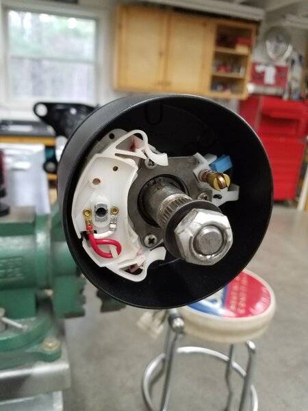

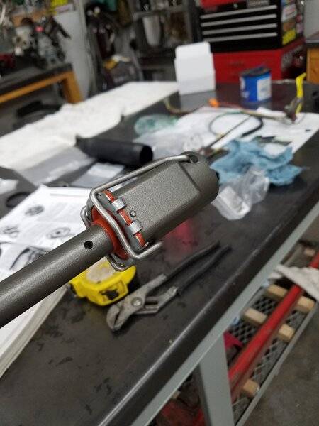

I had bought new bearings, but after cleaning up the old lower found out that is was really nice inside. Decided to regrease that one instead of the repop. The old bearings are so much better quality than the new ones imo. Putting everything back together. Been using these steering coupler clips and really like them. Saves a lot of messing around if you can trial fit them before it is bolted in the car. And yes I know the rubber seal should be black and not toilet plunger material (according to RC), but I had a couple of these and I can live with it.

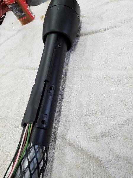

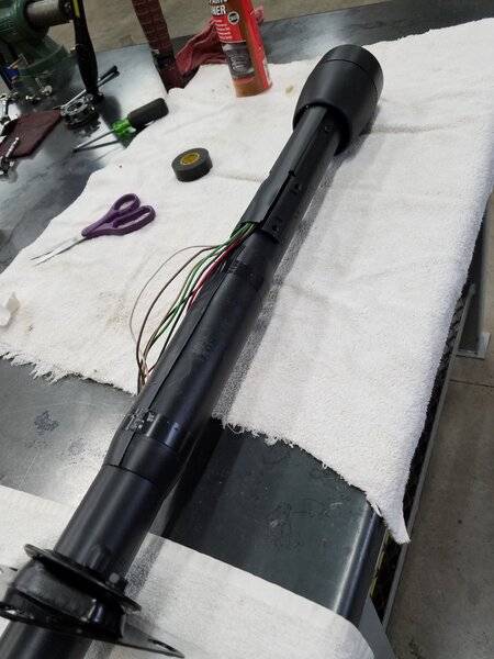

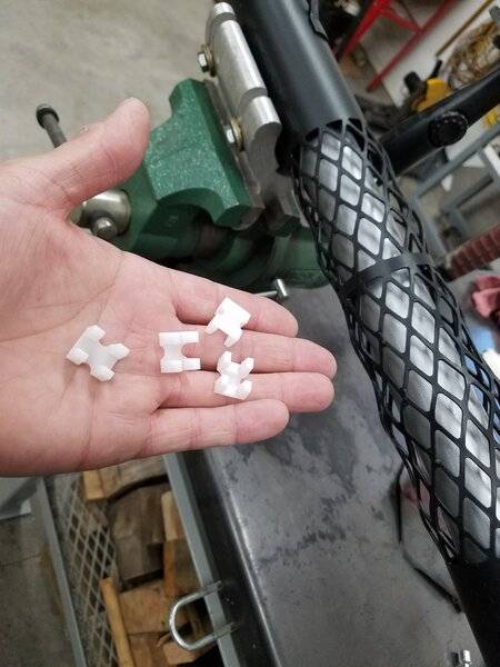

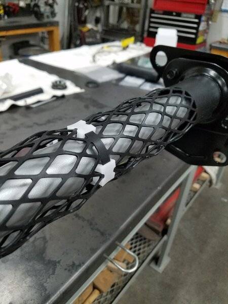

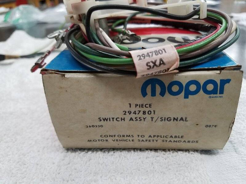

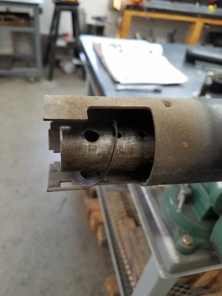

The reason for making sure the outer tube is nice and straight comes to light when installing these clips. Found an original turn signal switch. 2947801, this is the last superseded version that was made by Chrysler until 2008. It replaces the original 2857241 which was in production until 1992 I believe. And all buttoned up.....

Nice work on the column. I have yet to see a column with those clips on it. I know they're in the assembly drawing ('68 at least), but have yet to see a column with them actually on it.
Me either honestly. When a member here reproduced a batch I got enough for all my cars from him. They snap in pretty solid, so can't imagine they would fall out by themselves. They probably didn't get put on many cars originally. Maybe it was planned but never followed through with?

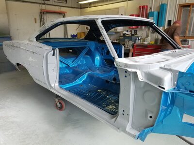

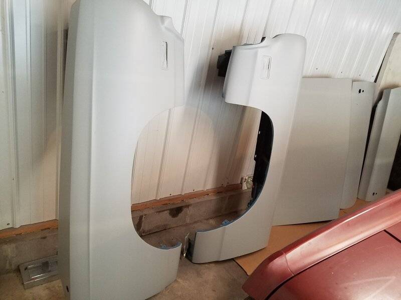

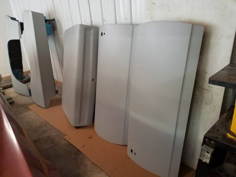

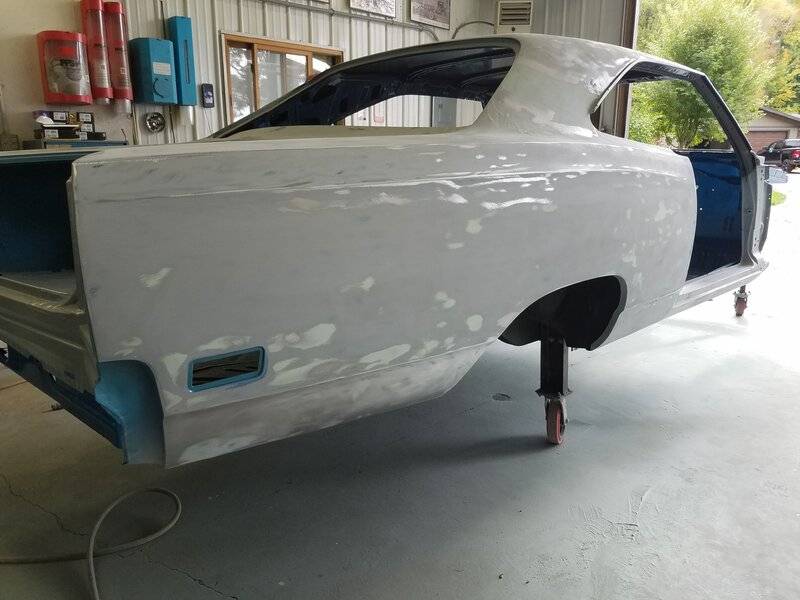

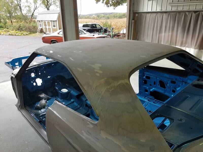

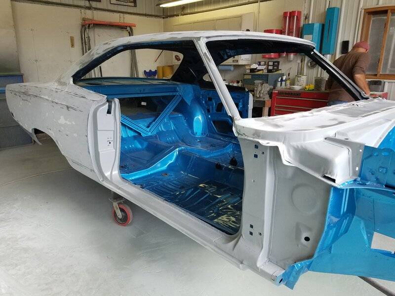

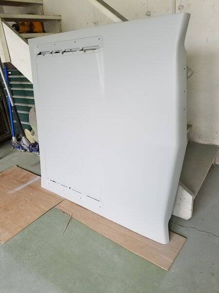

Got the body over to my buddy a month ago. Doors, fenders, hood, and decklid are sanded down and in primer. Old paint is sanded off the body and getting close to primer. Nice to finally be getting things moving along again.
20211004_111933.jpg 20211004_112012.jpg 20211004_112024.jpg 20211004_111949.jpg 20211004_112127.jpg 20211004_112337.jpg 20211004_112059.jpg
Looking good there, it’s always great to see progress! Keep it going!
