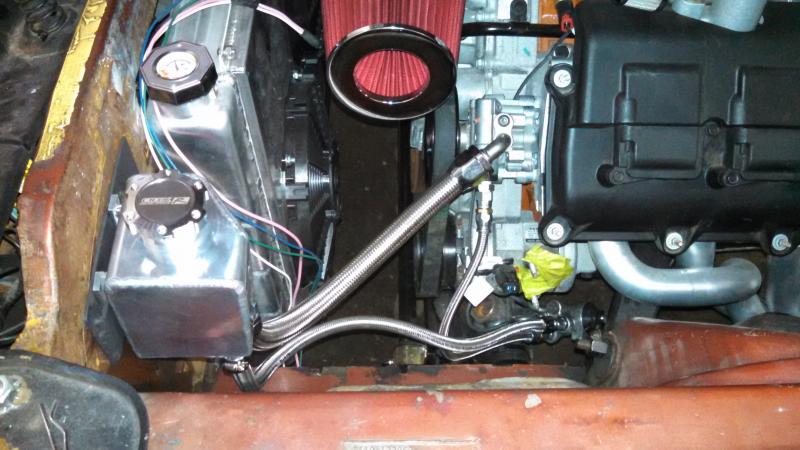

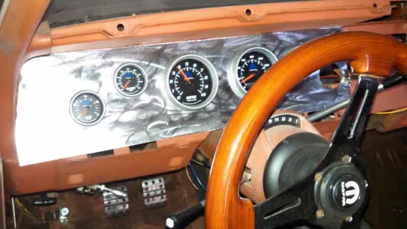

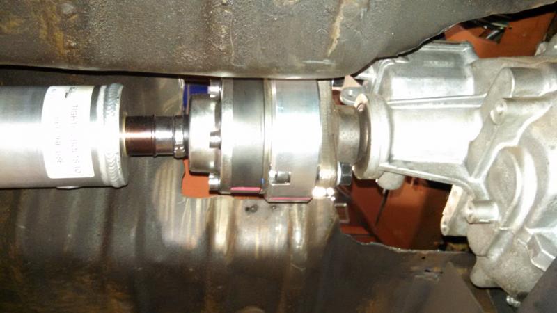

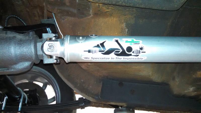

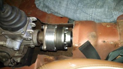

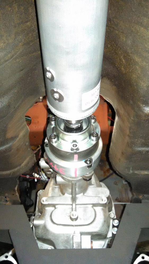

I got all the power steering tank an lines all hooked up. this is temporary for now. the driveshaft shop that made my driveshaft so far it is a work of art and it fit perfect. went to go start it and i still have the old battery (550 cranking amps) thats not enough. gotta go to 850 or 900 cold cranking amps. gotta a temp dash in for now just to get by with. just want to go out an drive this thing. didnt feel the best so this is all got done so far. gonna try an hit it hard next week.:beavisnbutthead:

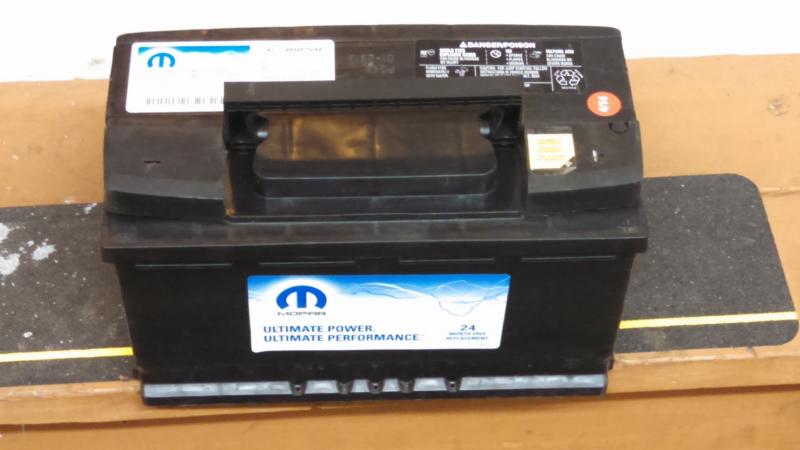

thanks kahn and kb, right now i got 1/0 cable for my positive and i got 2 gauge from negative to block and to frame and i also have two grounds from block to frame up front. just to eliminate the small battery issue i bought this monster. 750cca should get the job done. plus the sticker on it is cool too...LOL
That is a cool sticker, Im going to be buying a new battery for my 73 and this monster looks like it could hold and gentile it! I HATE buying battery's! lol.. BUT, that sticker is KA-ool!!! :)
I had a battery out of a Durango I parted out that was "Mopar Power" but sadly it dropped a cell in the cold this past winter sitting and had to be scrapped. So I too will have to go buy a new battery. Was the pricing reasonable?
hey kb i went online and got a coupon off the net for the 72 series battery. i think it was $160 but with the coupon i got it for 84.95 plus tax. 750 cold cranking amps and it turns that hemi over now. hopefully have it fired up this weekend.

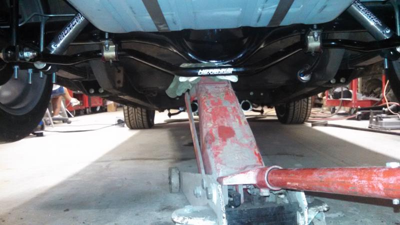

got the rear sway bar on tonite, looks pretty good. got a new ignition switch and got to bleed the clutch. so saturday is the moment of truth to start it up to hear the all mighty HEMI...lol i hope this all works out. :beavisnbutthead:
