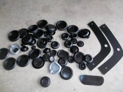

I am finally getting around to working some on my car. I bought a body plug set but I am not sure what plugs go where. There are rubber plugs and plastic plugs. I remember when I removed the old plugs that some were rubber and some were plastic but I did not make note which were which. Does anyone have a diagram or instructions to where each plug goes?:confused1:

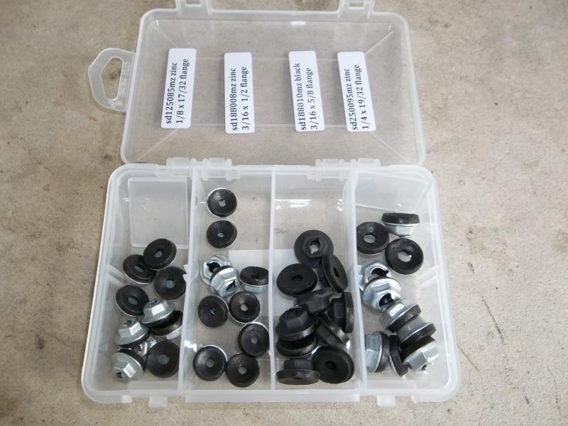

I also got some self cutting nuts with seals to mount my emblems etc.

Great new parts! That is the way to go.. I tried finding a diagram and came up empty, Most of the floor and trunk plugs should be easy enough, i would match them up and put the ones that fit in, I need to get a compete set myself if i ever get my 69 done, I did find a page that maybe could help with some things you may need or want, You can click on "visit page" after you click on any picture to check it out, There should be a diagram some where here to check the locations, some one will have it.. The best of luck on your ride!! :)

Classic Industries has the body plugs but I bought them form eBay because I found the same kit cheaper. The self cutting nuts I also bought from eBay, just type in 40 pcs thread cutting emblem name plate script nuts with sealer assortment Mopar.

Thank you Ron. I called up Classic Industries and looked up the other sites and still can not find any guide to where the plugs go. It appears that the rubber and plastic plugs go where ever you want to put them between the trunk and floor pans.
I put rubber ones in the floor and in spots where a blast of water might overwhelm a plastic one, like when you hit a water puddle while driving. All though I hope my 68 never sees a rainy day again.
Thanks Kid, That backs up what I was thinking. I plugged them in the places I thought would do best. I also do not plan on driving her in the rain but you never know what I might get caught in.

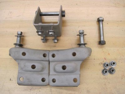

I have not got much done lately (hunting season), but I have been picking on a few parts. I have been sand blasting and cleaning some of the suspension parts so that eventually I can get her back on her landing gear.

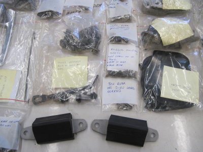

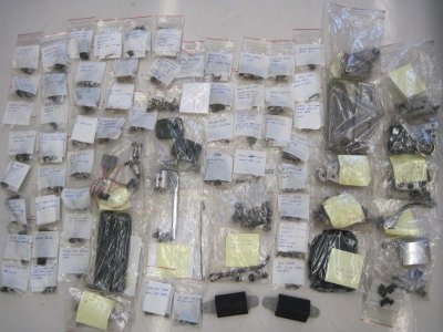

I have not posted lately but I still have been working on a few things. I have been doing the tedious job of locating all of my odds and ends parts that I have boxed away and cleaning them, wire wheeling, scrubbing, painting, and organizing them. I previously labeled them and put them in bags. Many of them I also put a picture of the part and where it goes. I am glad that I did that because I am still having a hard time remembering where and how parts go.
Now that is what is called tag and bag!

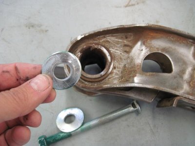

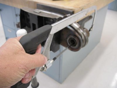

I took me a little to figure how to take out the old bushing on my lower control arms.
I first cut a grove in the inner sleeve and was able to remove it and the rubber fairly easy.

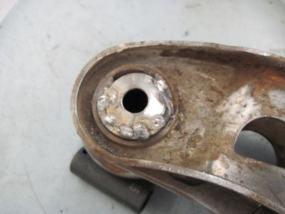

I had a harder time trying yo figure out how to get the outer sleeve out. I was trying to press it out the wrong direction.
I did some research and found a hint. I tack welded a large washer on and used a long bolt with a nut to press out the outer sleeve.
