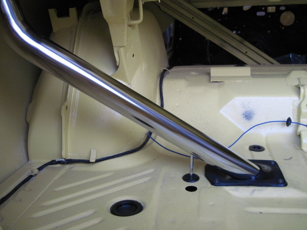

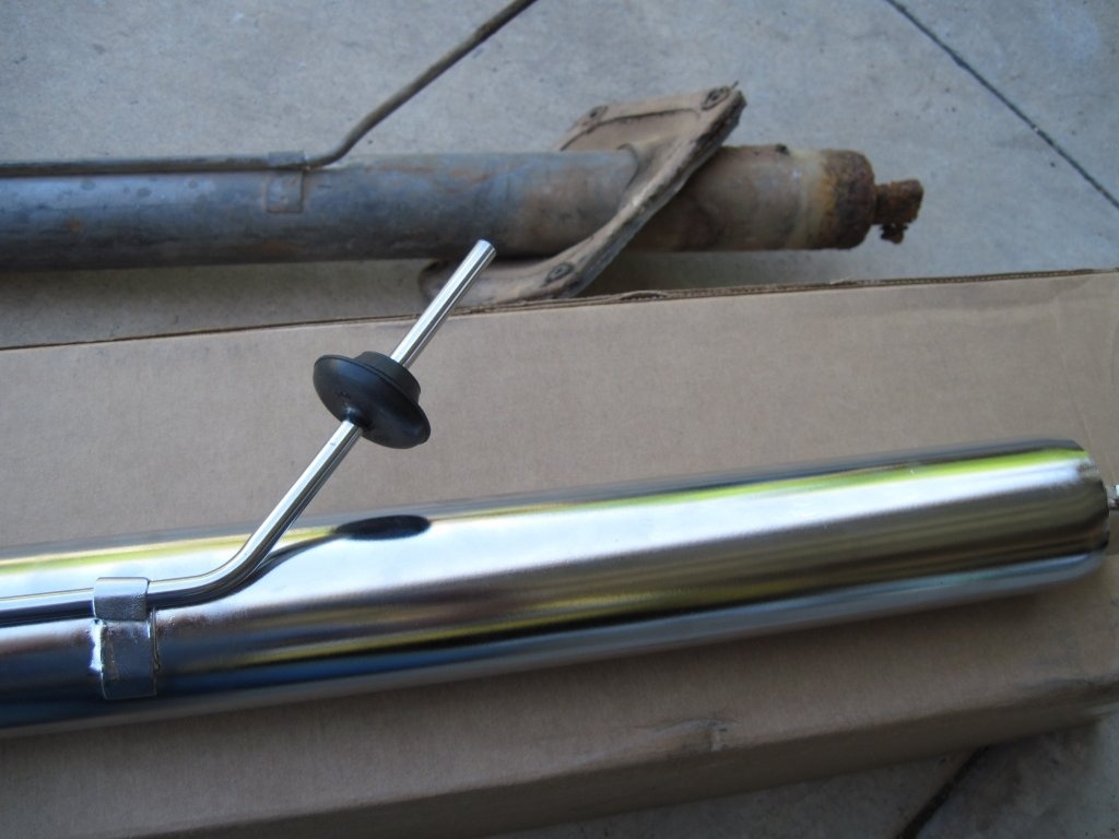

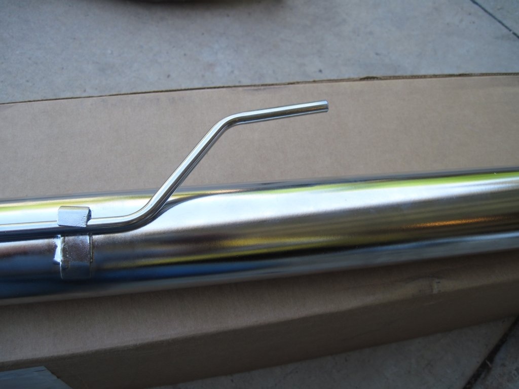

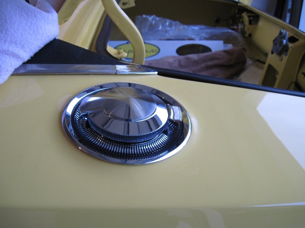

I just finished with what I feel is one of the best looking thing about these b-body cars, the gas cap & filler tube. Just like everything else on this car it needed custom fitting.
The vent tube had a bend and my old one was straight.
The problem is that it cracked the chrome coating.

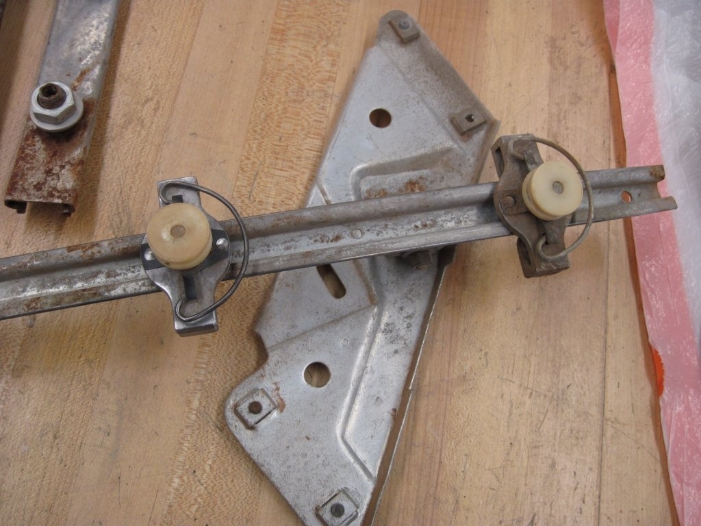

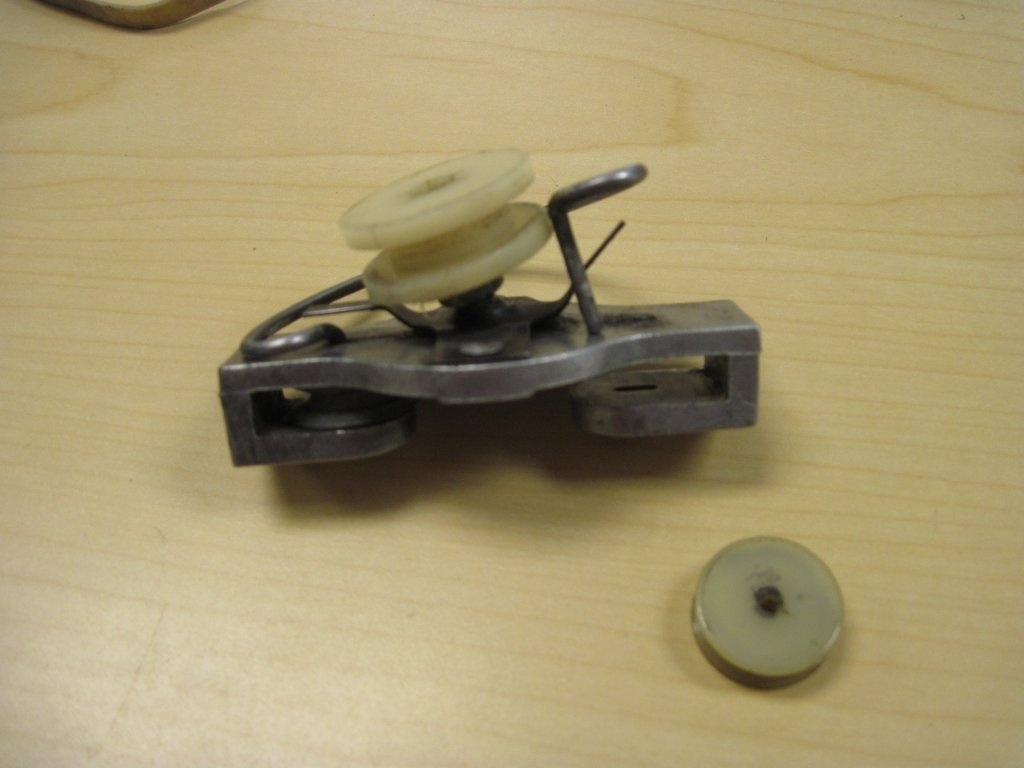

I am still am working on cleaning and fixing the window roller components. Most of the rear quarter window rollers I have been able to get them to roll smoothly. A couple of them I have had to soak with WD-40 and slowly work them until they loosen. When I started working on the right rear quarter window rollers I had one of the rollers that I could not get to loosen. The kit did not have replacement little guide rollers but they seem to be in good condition.

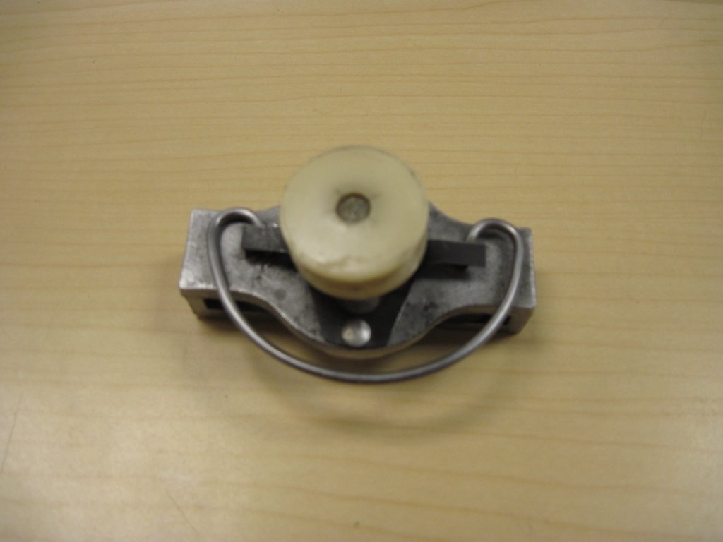

To loosen this roller I removed the retaining spring and removed the roller.
The roller had rust and petrified crud on it. I used 600 grit sand paper and lightly sanded off the build up then lightly greased it before reinstalling it.
After working in light grease in all moving parts the rollers move smoothly on the track now.
Nice work on those rollers. The quarter windows are going to glide up and down; people will think you have electric.
Yeah, I wish I could give some sage advice. It's mostly trial and error. Some obvious advice is to bolt in the smaller tracks first but leave them loose to give you some wiggle room. I remember the rear wobble roller giving the most trouble so start it first move on to the others. Good luck.

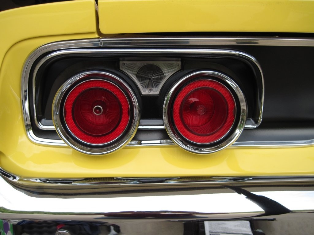

I fixed my mistake on my tail light and I think that I am OK with it.

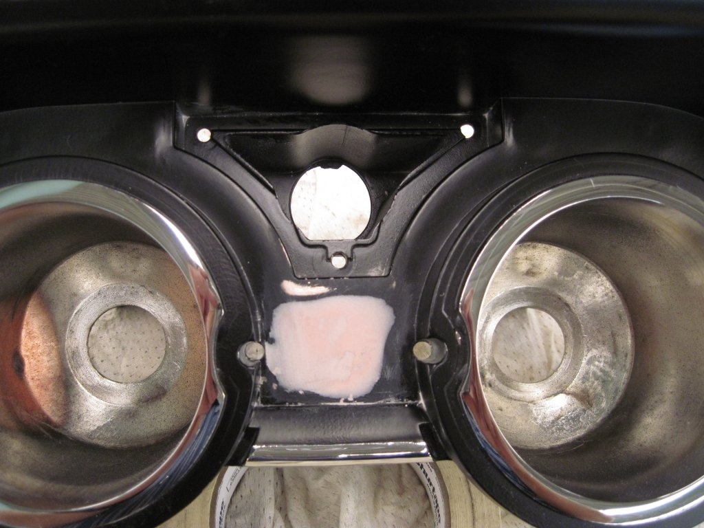

Here is a poor picture bit I first dremeled some groves in the pot metal for better adhesion.
I then epoxied the stud in with JB Weld.
Bondoed and sanded the front side.
I went ahead and repainted the whole bezel to make sure it all looked the same then reinstalled it.

Your tail light fixed up great!
Nice save on tail light panel, exactly what I would have done!

Nice job on the tail light. Love that JB Weld; saved me more than a few times.
