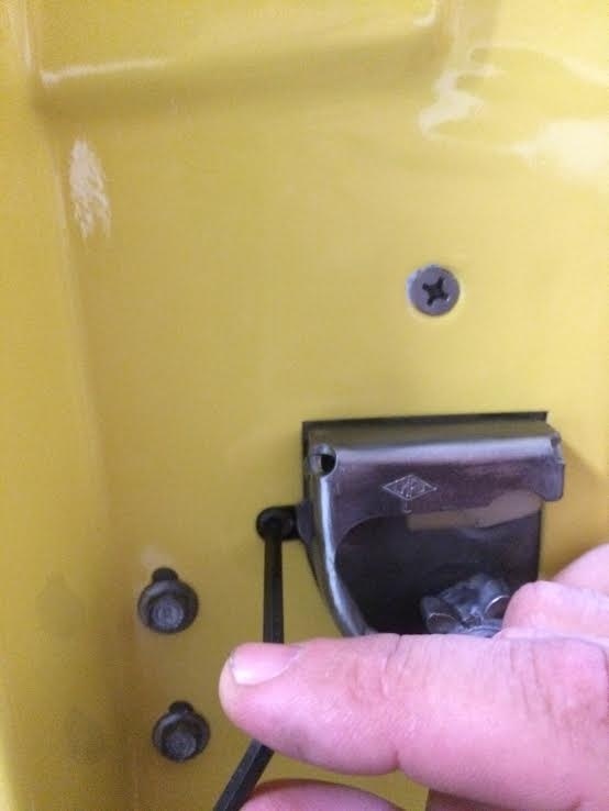

After installing the latch it took me some time to adjust everything to get the door to close right. once I got the door to close right the lock did not work right so I took the latch back off to adjust the lock. I found after I took it off that there is a lock adjustment access from the door jam that made it a lot easier to adjust.

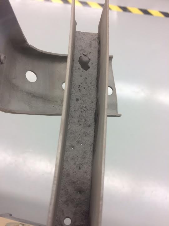

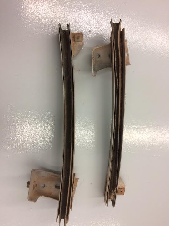

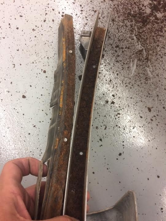

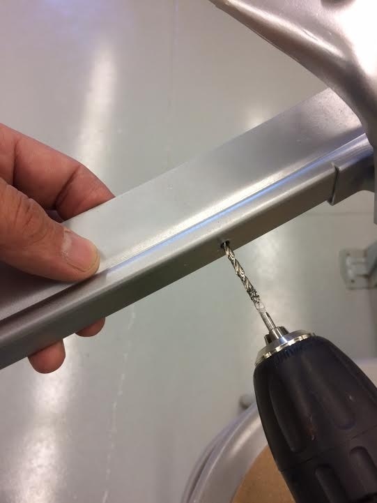

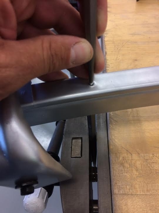

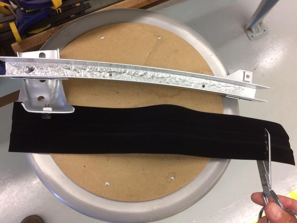

I have been working on getting everything ready to install my door windows. One of the things that has helped me is when members on this site show their process on specific parts restorations so I have been trying to show how I have done some of mine and may be it will help others have an idea how to improve on theirs.

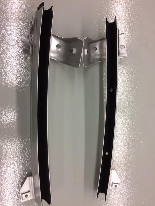

Many of my parts have been in fair condition when I clean them up but when I started to work on the interior door window rails I found under the old rubber seals that it had cancer rust. Water must get held up in these and cause problems. After cleaning and media blasting the rails I felt like they were still structurally strong enough to reuse. I treated those spots with rust treatment. I ordered the new rail felt and it came with the mounting rivets. I cut them to length and hammered the holding rivets back in.
After media blasting there were a few spots where the rust had eaten through.
Great job man that looks sweet! A lot of time you spent on those! Some people never realize until they do that....
They always are roached under the seals......even when the outside look good....

Great tips. Keep them coming. These are things I do not know. I am also learning a lot from your project thread. Thank you,
I still do not have the rubber seals on the door but the door seems to shut and open well.
How does that door adjust work ? I didn't know you could adjust it on the door latch with a hex key
The hex screw is only to adjust the door lock position. When it is not adjusted correctly the lock will not work. I adjusted this after getting the door to shut correctly with the latch in the door jamb.
