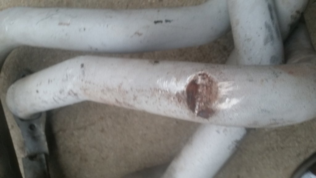

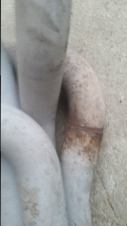

the headers that came with my car had a removable tube,( don't know what kind these are, must be from the 80's, no markings or numbers that i can find anyways) and a large dent next to torsion bar, also had to lift the motor up about 2 inches to get them in , start the back bolts before the flanges made contact with the heads, otherwise they wont clear the header tube into the head flange. its like they weren't designed for headers (ha ha ). I was gonna go with exhaust manifolds for that very reason, I'm still up in the air on that one, good luck.

the headers that came with my car had a removable tube,( don't know what kind these are, must be from the 80's, no markings or numbers that i can find anyways) and a large dent next to torsion bar, also had to lift the motor up about 2 inches to get them in , start the back bolts before the flanges made contact with the heads, otherwise they wont clear the header tube into the head flange. its like they weren't designed for headers (ha ha ). I was gonna go with exhaust manifolds for that very reason, I'm still up in the air on that one, good luck.View attachment 406201 View attachment 406202 View attachment 406203

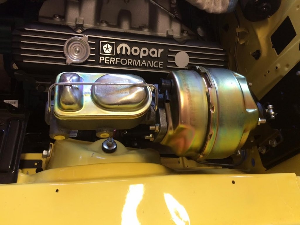

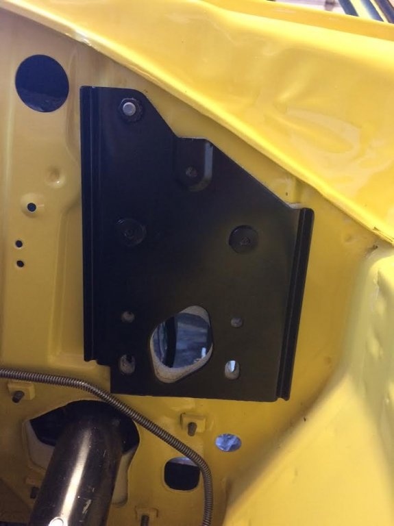

Justin sent me the manual brake reinforcement plate and it arrived today so I had to go and try it out. Everything seemed to bolt on the way I think it should.
This style of brake system sure seems to stick out far into the engine bay. I hope that everything works as it should also.
Thank you Justin for the help.:thumbsup:

That booster is going to make plug changes a pain!

I went with a manual master cylinder for mine. Because of maybe not enough manifold vacuum & space & weight.

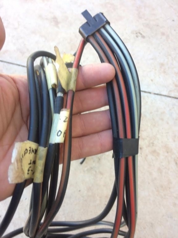

I have been going to order a vacuum hose harness, for my A/C heater box, for some time but I just haven't felt like forking out nearly $200 for one so I got the old one out to look at it again. I thought of trying to build one myself.
The only special things that the old harness has is the plug end and color coding stripes.

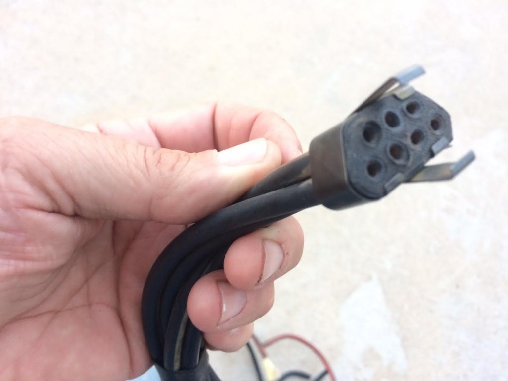

After cleaning it up and looking at it closer the hoses seemed to be flexible and in good condition except for the hose that goes through the firewall. That hose was stiff and felt brittle on the end that goes out into the engine side.
I decided to replace only the firewall hose. I reamed the old hose with a drill until it loosened in the in the plug bracket and slipped out. Then I glued it and pushed it through just past flush then seared the end with a lighter and pressed it flush. It looked to me that that was somewhat how it was done in the factory.

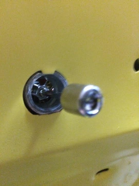

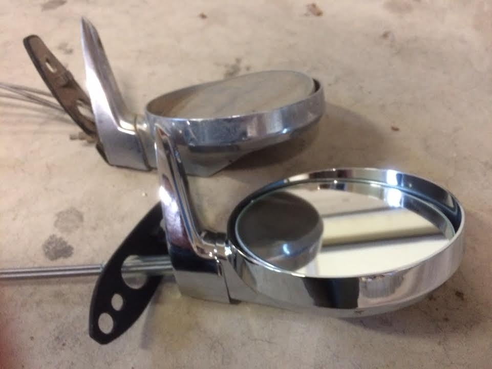

2 of the cables on the original adjustable door mirror were broken and the base of the mirror so I ordered an OER mirror from classic industries and installed it. This was just another example of how every replacement part I have put on requires at least a little custom fitting. The only thing I had to do to fit the mirror was to file the key tab in the mounting hole for the adjuster knob. There are some minor differences in looks but I am happy with it.

Yep there ya go. Just what I was talking about Monday. 5 min job suddenly takes a hour. Looks god though. I'll be prepared when I do mine!

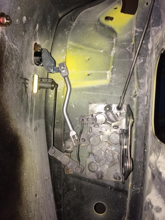

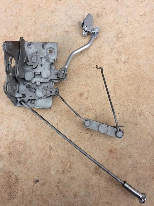

I have been getting the door glass ready to install and so I thought it would be easier to get the door latches installed first. I scrubbed the latches with break cleaner and media blasted them to clean out all of the old dry grease and dirt. I then used the air hose and blew and worked all of the movement until I was sure that all of the grit was out from all the movements and clean. I sprayed lithium grease on all of the parts to make sure that all moving parts got a good amount grease.
