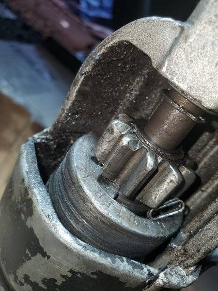

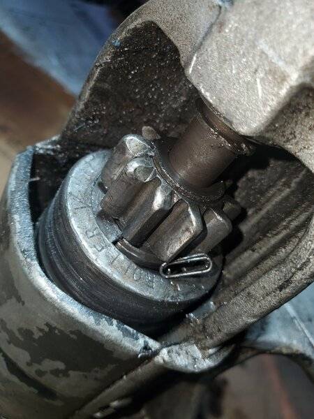

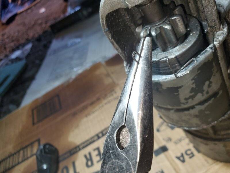

Ok found these paper clip looking things at the bottom of the bell housing and coming out of the starter

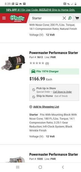

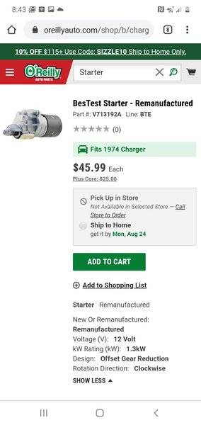

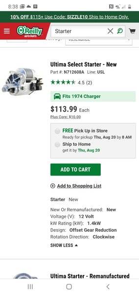

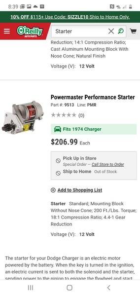

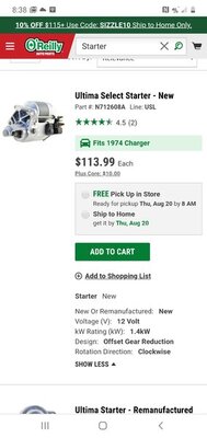

Why do much I think a duralast one from AutoZone I'd only $50 or so life time warranty
