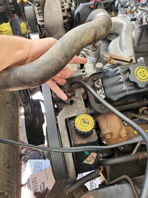

So I'm connecting here to here just to be sure? Seems like we're bypassing the thermostat.

Yup those two not exactly bypassing t stat you'll be fine I door it all the time in FL no heat needed here

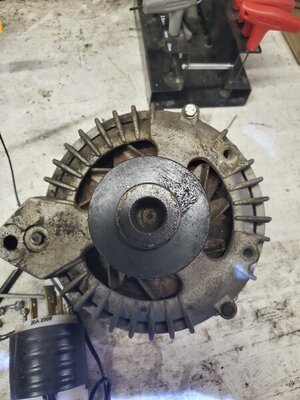

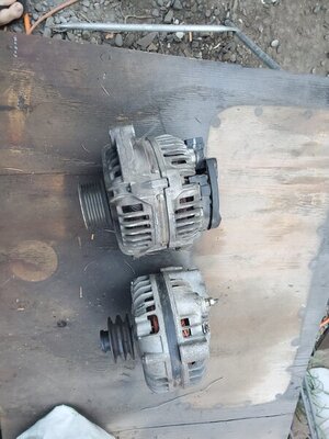

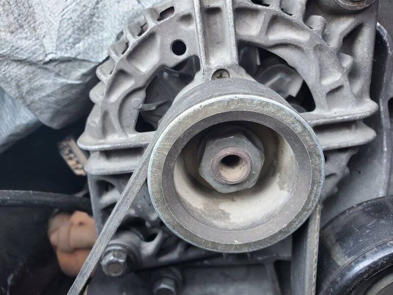

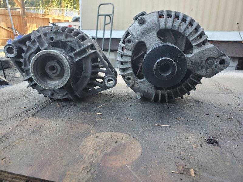

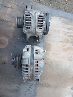

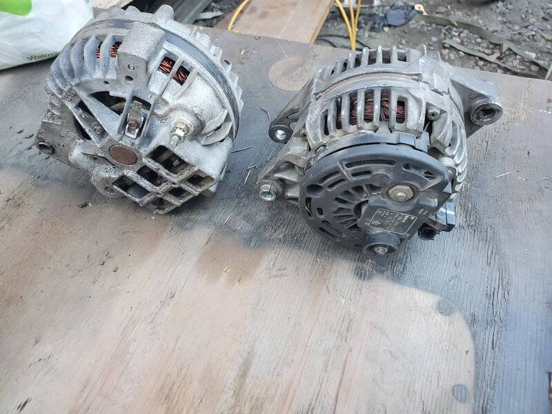

I dont think the pully is going to swap over on the alternater...
If pully won't swap maybe go see an alt shop and tell them you need the back of one front of other they could probably just switch the case on the rear of the newer style
The old alternater is completely different. Mounts pullys and wires

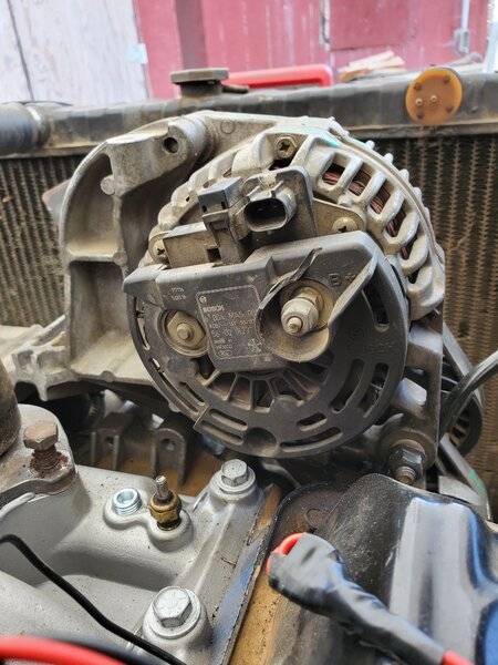

Can I use the new alternater and just wirer it up the the old regulater
Does that new alt have an internal voltage regulator ? That might cause an issue if not I guess just find that plug and wire it up
Looks like thats what I'm doing. I'm excited the rest of my parts show up today ill let you know how it goes.
