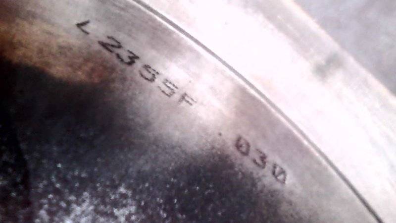

With that nice scope...Pull a plug out and look at the top of the piston.

Scoped the piston top and found them to be 0.03 over Speedpro L2355f30.
Stock 906 heads are around 90 CC (I think? '70 block and probably stock heads. 906 then, right guys???). Don't want to pull a valve cover today.
Do you guys think I should even bother CC'ing the block/piston area? PIA for me when I know I am pretty close to where I want to be.
"Six pack" replacement pistons. They're heavy, wild guess you have 9.5 compression give or take. Try not to rev it above 5500 to give your rods and rod bolts a chance to survive. Forged which is nice.
9.2-9.5: 1 is likely pretty close. Most the 906s I have cc'd are less then 90cc. 86-88cc is more typical w new valves and surfacing..imo. probably for what your doing I would figure 9.5:1 though until you measure it. Better safe then sorry. E85 guys runs 9.5:1 with lots of boost.
