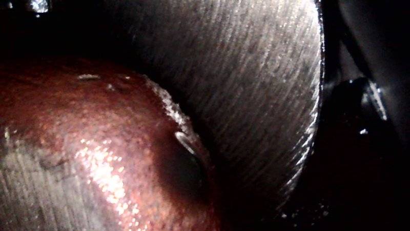

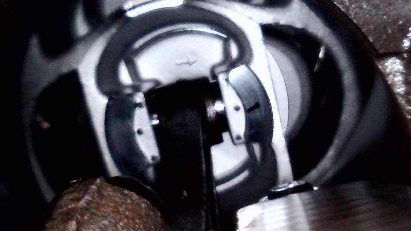

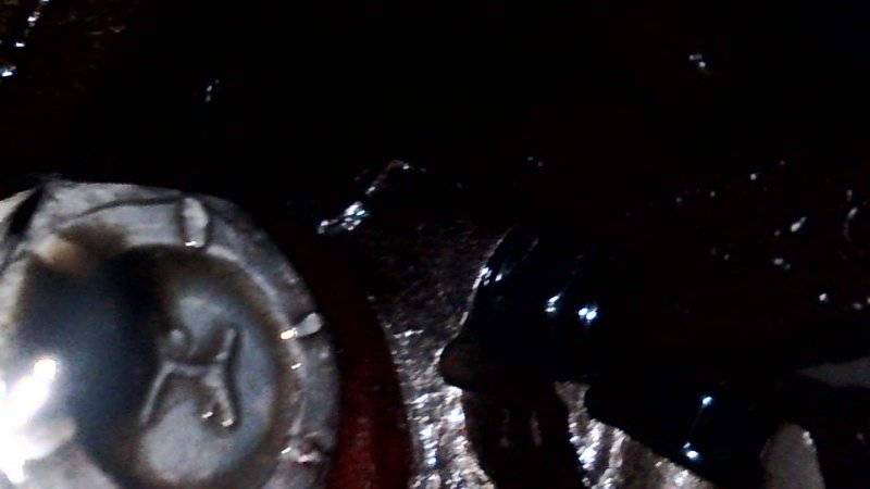

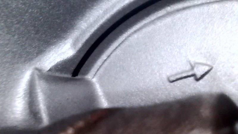

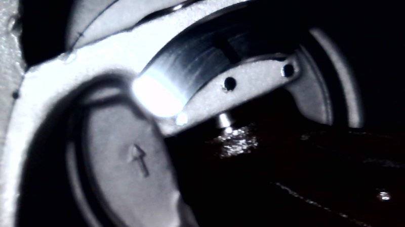

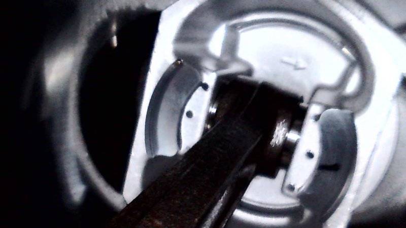

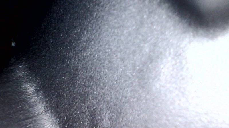

Do you need just better all around pics of the pistons or trying to find markings? I will look again, but I did not see any markings other than an "O" and the directional mark for installation.It's a stock bottom end with new pistons.
The better the piston pics, the better we might be able to identify them![]()
Yes mainly any markings on the bottom of the piston head.While I have the oil drained, anything else you think I should be looking at?

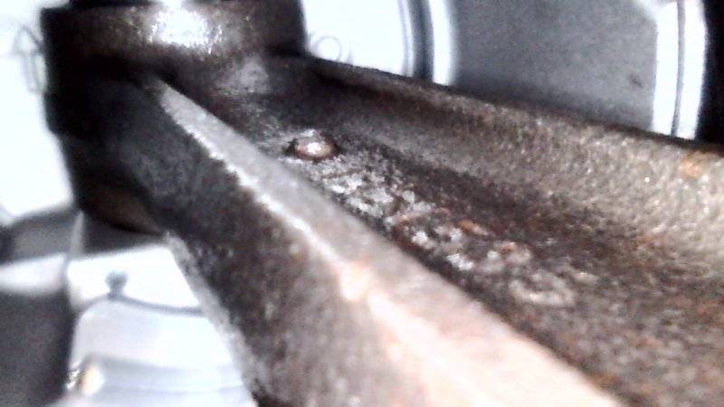

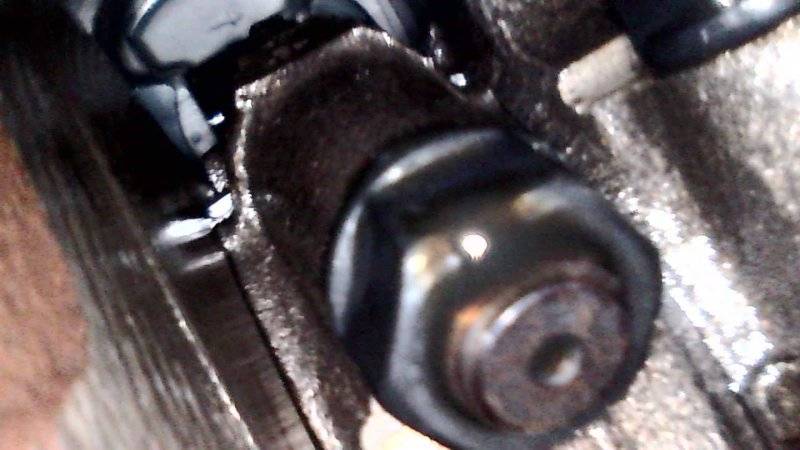

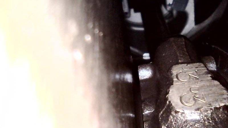

Basically, you will never break a stock rod, no matter how shitty you think they may be. (Not sure why you came to that conclusion)I looked up the rod P/N (1851535, I think) and it looks like OEM. Hopefully the guy didn't use the same rods that were in the motor to begin with. Ugg.
Keep in mind that I know very little about 440's. I have always been a Chevy fan so I appreciate all the comments. There are always little tricks and in the know type knowledge that you guys have. Just trying to get into the groove.Basically, you will never break a stock rod, no matter how shitty you think they may be. (Not sure why you came to that conclusion)

Thanks for your input.Yes mainly any markings on the bottom of the piston head.

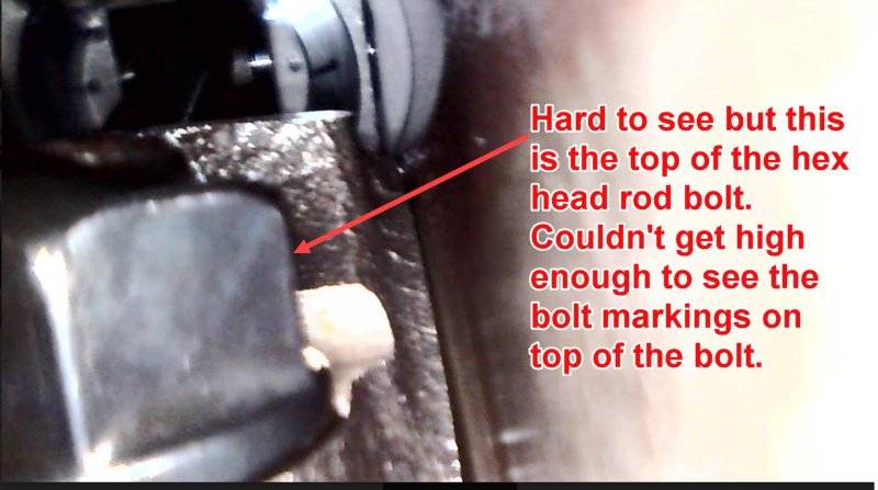

The nut end of the rod bolts too.
Wow, 8300... Your talking a big block right?With that nice scope...Pull a plug out and look at the top of the piston.
Oem rods are not bad, mopars were all forged, not cast like most gm rods. I'd rather run a factory set then "cheap" chinese set, but past 600hp we run eagle and scat rods. If it has a light pistons that helps them considerably. They likely have been gone through...better picture of the rod bolts would help.
We ran 550-600hp with stock rods arp bolts for years. Even went throuh the traps a couple times at 8300. We have pulled one in two that even had arp bolts....but a cylinder wall was split. Likely any rod would've let go.

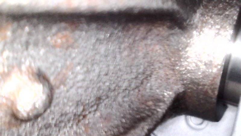

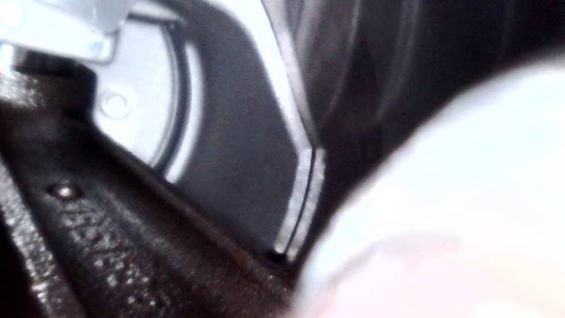

Here are some more pics. Thanks for you help.Yes mainly any markings on the bottom of the piston head.
