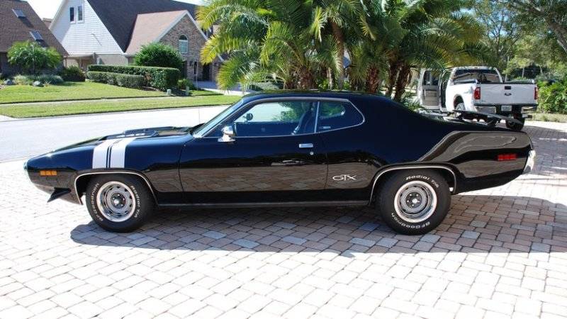

Did you ever tell us what kind of car that WE are working on and show us a picture of it?
But here's the next on the block with 440. This time with an edelbrock top end. Should be easy...fingers crossed
Guess technically that's what we are working on...
It's the PT I'm working on as a model to put into the GTX so I have no issues.
Here's what it looked like a few years ago. I got it from a guy that was trying to re do it. Had health issues, the sold it. Then that guy had health issues. So I'm next in line..lol
