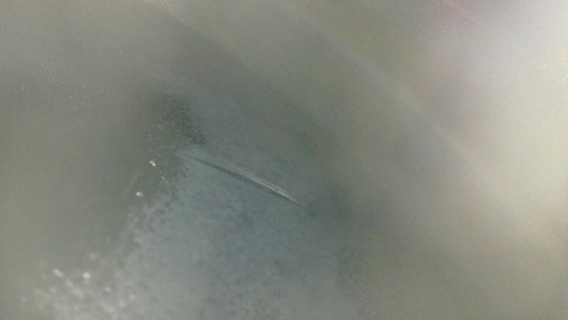

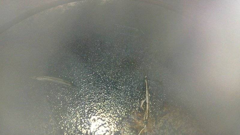

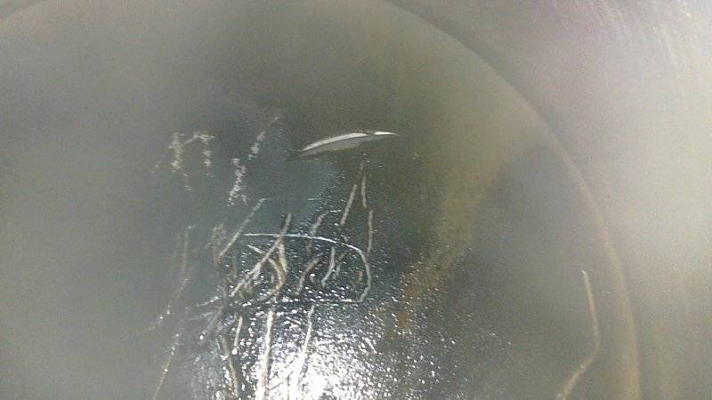

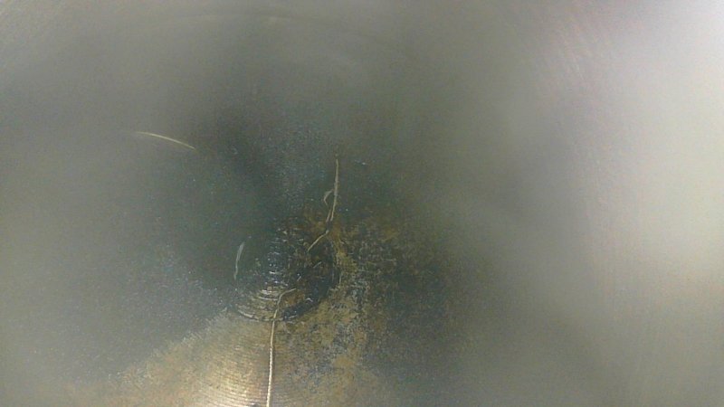

I'll do a Comp test to check for bent valves. Then degree the cam before removing. Looks like intake on all 8. I would say retarded cam? Scratches are the cheap scope.

Yes sir..sure does. Well let's hope valves are OK. Just pisses me off. I've worked so many hours to figure this out. Should have done this in the beginning. Not to mention extra $ spent.

The pushrods should bend before the valves.
All I know is I see flat top pistons
How far are they in the hole

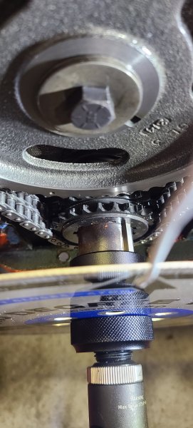

Hers what i found.
1st pic is at TDC found with piston stop numerous times.

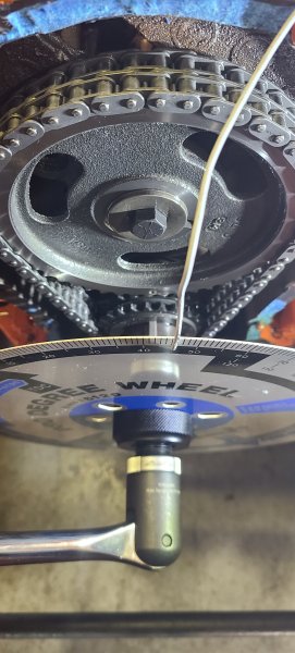

2nd pic is his TDC marks and the degree wheel. Looks major retarded no? Tis why int hit pistons.
So in the end works out to be 43° retarded. All from not even finding TDC...wow...so that was the problem. Onward and upward..lunati goes in tomorrow. Glad wasn't more damage..could have been worse.

Did they screw up the alignment of the multiple keyway timing set or was it marked wrong?
No it's lined straight up. Pic 2 shows it's lined up, just not to TDC...lol.

Sorry but it sure looks to me like it was installed incorrectly.
The keyway is not vertical when the engine is at TDC it's about 45 deg. clockwise like your first picture. ( 43 maybe???)
You don't line up the cam gear dot with the keyway.
