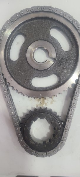

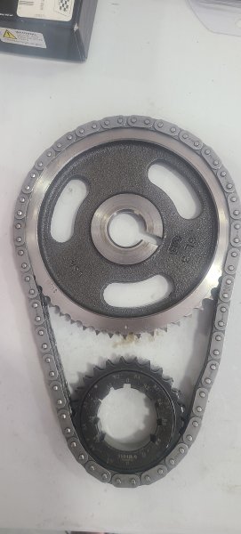

Yes you're right. It was out 3 teeth. Each tooth would be 14.5°. Just enough to hit the valves. Hers how it was installed. They lined up the cam dot with 0 on crank. So retarded R4.

I'm thinking there was and inexperienced builder. He installed what he thought was correct. Noticed valves were hitting pistons and re traced back to re align the cam. Otherwise of was running surely those valves could have been bent.
As the multiple keyway gear was confusing, he finally lined it up with the 0 not the dot. Still retarded but not enough to bent valves. Just enough to make it a dog though.

Sorry Geoff...43 at the cam gear. Like 8 on the crank. Was reading the degree wheel as per the pic.

Sorry..wrong pic. This was the one.
Not sure where you are getting 6-8 degrees? I don't see that being possible assembled like this picture. Think of the cam relative to the crank. In terms of ret/adv. If cam is advanced it is advanced ahead of the crank.
It appears they installed it advanced 40+ degrees, not retarded.
They does explain why your compression tests read high and had no vacuum. I would also guess that it kissed the valves at that point. I doubt they changed It. They just didn't understand the lower gear markings...and that is sad.

Yes as im not seasoned in this, yes advanced. Around 43°. Man you know your s***t!
