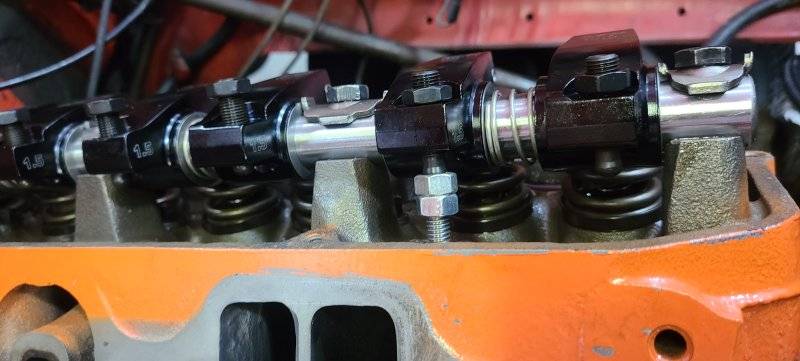

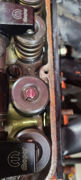

So maybe 8.750. Here's my checker with 1.5 turns in.
I would expect to adjust them enough to fit doing a 703 in place of a .509 MP. The cam base circle I don't believe is that different effecting push rod length.
What do they look like adjusted with a 1/4 turn preload.
What procedure are you using to adjust the valves? Was this the pushrod/rocker combo it had?

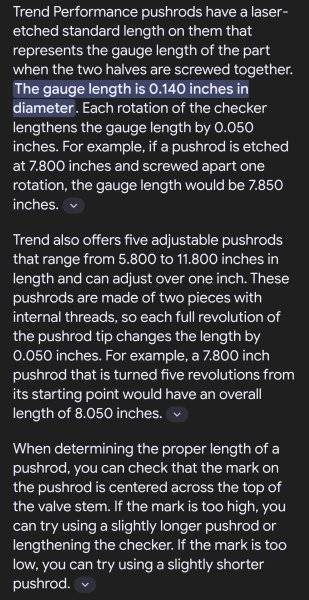

Got to be careful buying pushrods there is effective length and overall length. It gets a bit confusing to recommend anything without knowing what is being measured. But, here are some links that might help. If you have researchef this stuff, it may help someone else.
https://www.compcams.com/valve-train-geometry/

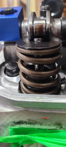

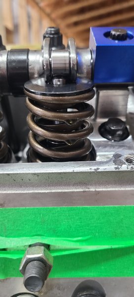

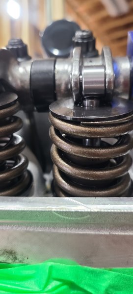

Think I'm on right track. Center line across valve stem looks good with my measuring rod.
Comp measures to the end of the cup, so inside is approx 3/16" or .1875. So I arrive at 8.9375 approx. Trying to see.if one is available in stock before running to Smith Bros. So waiting to hear.
There's a bit of forgiveness with hydraulic lifters. So should be pretty close.

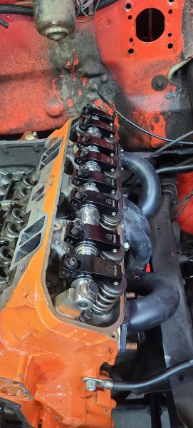

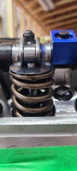

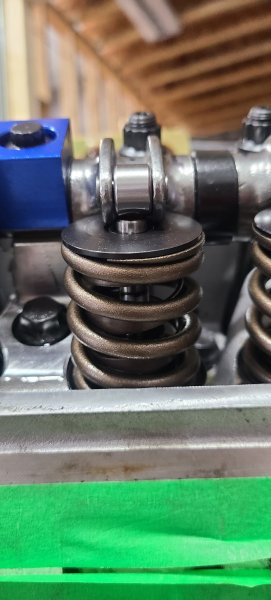

After all this I thought I should pop off a valve cover on the other 440 build from them. I supplied the top end this time.
I don't think this is gonna fly....
How much lateral offset before its a no go and start grinding towers/shimming?
