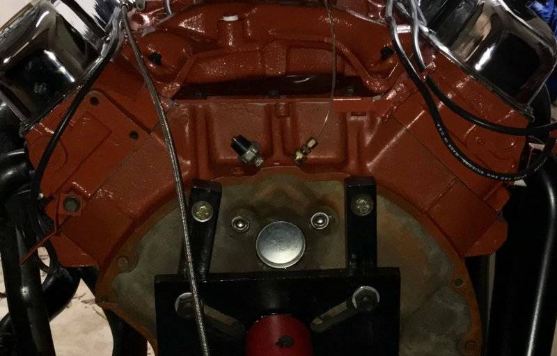

Just wondering. There are 2 plugs behind the intake. One has the low pressure light sender and I put the fitting for the aftermarket oil pressure gauge in the other. Is that the best place for it?
That's how I plumbed mine - one for the sender and the other for the gage line.
