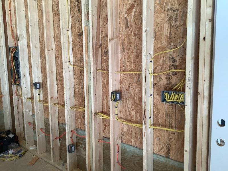

Actually, wiring is at the 93% completion stage right now, but that would have been an option, otherwise. I used radiant sheathing on the roof, but Lord knows if that will really be of any benefit after all is said & done.

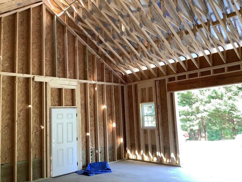

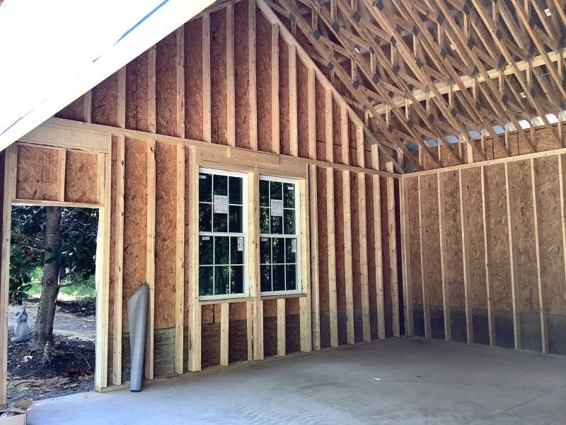

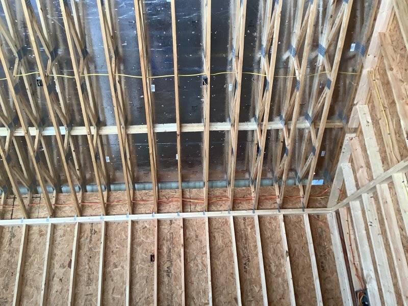

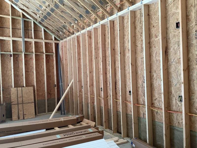

Actually, wiring is at the 93% completion stage right now, but that would have been an option, otherwise. I used radiant sheathing on the roof, but Lord knows if that will really be of any benefit after all is said & done.View attachment 1525479View attachment 1525480View attachment 1525481View attachment 1525482
Looks like you have some reflective rigid stuff up there already. I also see you are in South Carolina. How much insulation do you need? What is recommended for your area?
I'm concerned more for Summers in Carolina! Super HOT & HUMID, especially July, August & into September. Soooo uncomfortably hot & humid, sometimes it feels unreal......especially after retiring here from MI. I'm putting in a Mini-Split system too, humidity & dampness is a bear down here!
