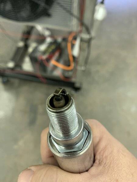

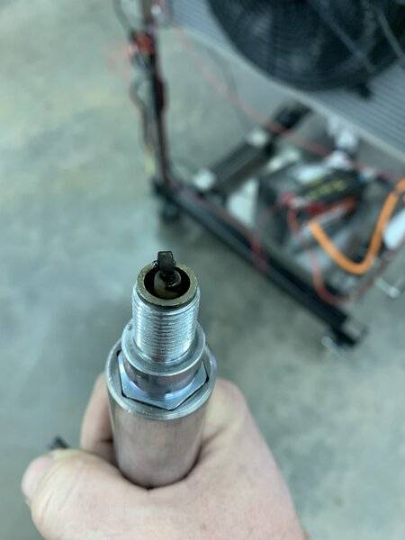

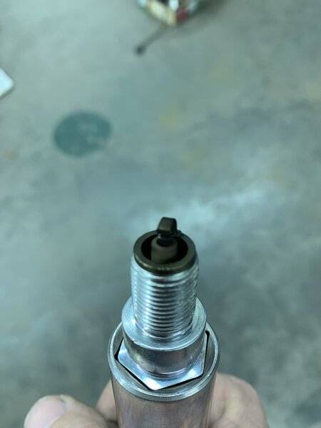

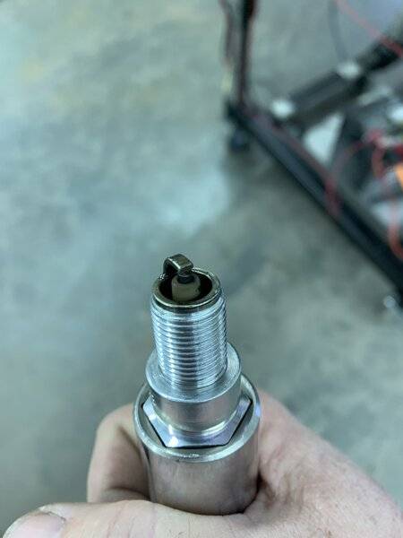

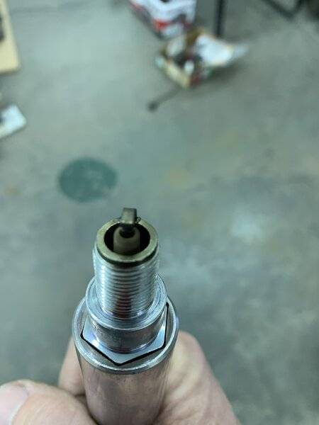

I know plugs will be kinda hard to read after
10 minutes of idle and throttle hits but i’ll post pics of the plugs in the next reply.
Plugs look much better the AR53 were black
pics in order of 1-3-5-7 and 2-4-6-8
