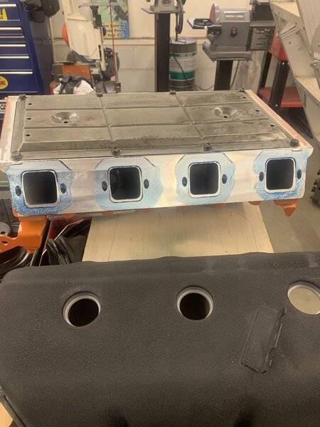

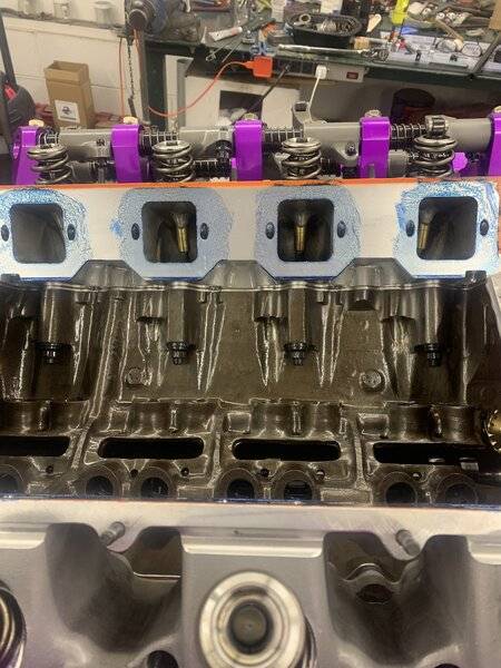

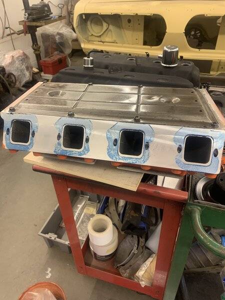

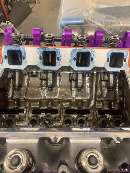

How does one determine if the manifold is leaking? I have torqued it several times now and there’s no evidence I can see of it sucking oil.
First of all intake leaks the bad ones are on the bottom side. So harder to diagnose. One simple test I do to see if the intake is leaking is this. As long as there are no other crankcase venting except the valve covers this should work for you. Remove all pcv and plug them. Plug all valve cover ports on one side. Start and run the engine. On the unplugged valve cover side you either will have crankcase gasses escaping or a slight vacuum. If vacuum you know the intake is leaking. I suspect the no idle below a lower RPM and high A/F, along with all you have tried to correct doing nothing could be a serious intake leak.
Unlighted propane torch, around intake. Might need to block wind from fan. No lean plugs right so who knows.

Here’s a couple pics when I check the intake fit with Prussian blue.
