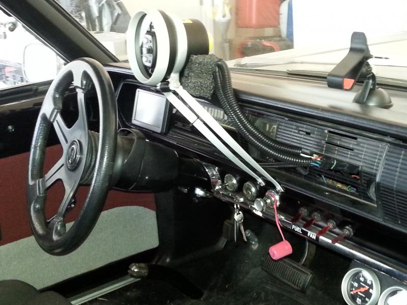

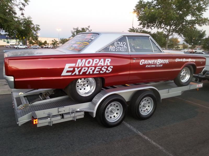

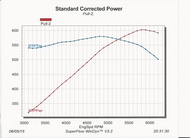

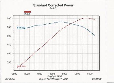

tach 1.jpgScan0005.jpg20150918_190822.jpgView attachment 288912View attachment 288913View attachment 288914If a 10.985 time slip counts as a 10 second build, I guess I finally qualify to this thread....
505" Ohio Crankshaft Crank & H-Beam Rods / SRP Forged Pistons 12.2-1 / Indy SEZ non max port heads / Indy Dual Plane / Demon 850 / Comp Solid Flat Tappet Cam about 660 lift with 1.6 440 Source Rockers / 440 Source Steel Billet Girdle / 440 Source Steel Billet Main Caps / Hooker 1 7/8 Super Comp Headers / Mallory 140 Fuel Pump / Mallory Return Style Regulator / MSD with 6 AL Box / Reverse Valve Body TorqueFlite / Ultimate Converter at 5000 Flash / Narrowed 4.30 Spool Dana 60 with All MOSER parts & Axles / Moroso Drag Special Front Tires / MT 28x13.50x15 DOT ET Streets Bias Ply Slicks w 11" tread width / 15x10 & 15x4 Welds / AutoMeter Replay Tach / Hurst Qrtr Stick Shifter / Hurst Line Lock with 2 step / Fiberglass front fenders and frt and rr bumper / 3440lbs dry without driver and no gas / Full Street Legal..Lights,TurnSignals,Horn / Current California License Plates and Insured with Hagerty for Street Driving.
Hope to get it down to 10.80 with property jetting and timing. Only 5 runs to get the 10.985 at 120.6MPH.
yep that is very close. how did it feel?? change your RPM shift points? I like those numbers a lot. so tell me exactly what you changed. I have been thinking about trick flow heads this winter down time.
Canyon...My thoughts...I forget what heads you now have but...If you change your heads get the big Ported MAX WEDGE INDY heads with big flow numbers..the most important thing on the car....I now wish I would have gone with the MAX WEDGE Size Ports and a big port job...a few hundred more dollars at the time...but much cheaper than doing it over.
Your there Mike. Love the pics. I run the Elbrock heads and thinking of changing them but, I ran a 10.73 Wed night and I wonder if I should just be happy with that. If you get the jetting done you will go faster. jets first then timing. Great looking and running car thanks for sharing those pics. I hope to meet up with you this upcoming season.

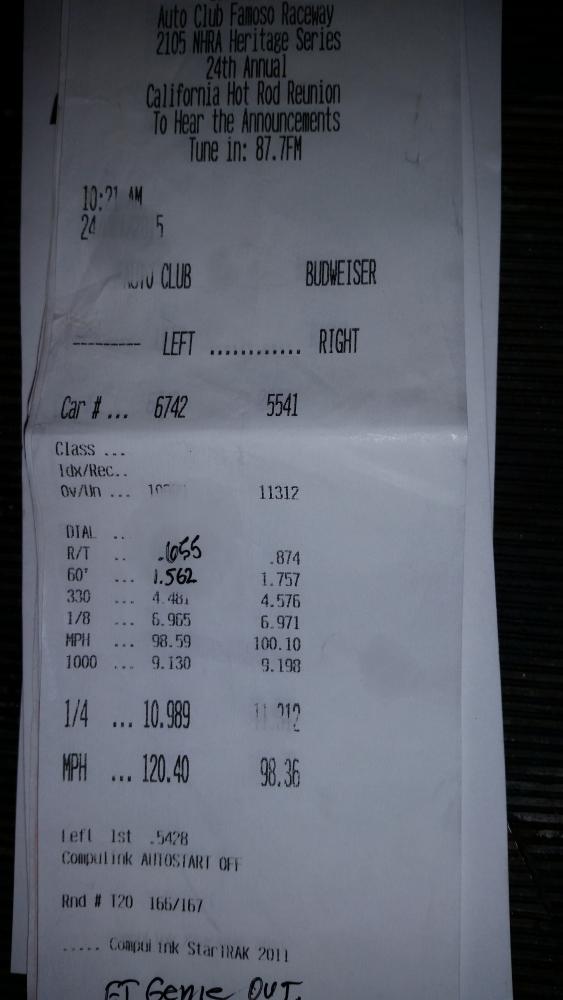

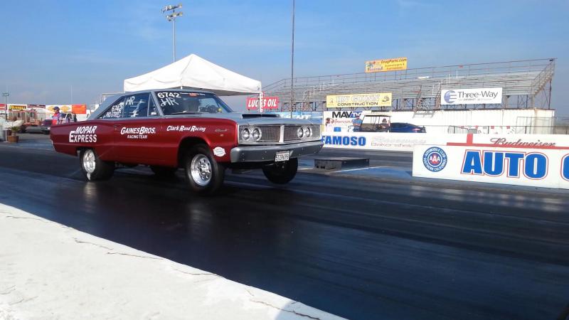

10.985 slip.jpgBest Wheels Up.jpgHere is my prized 10 second time slip....10.989...on the 5th run on my new setup....just hope to get it into the 10.80's. Will probably take me about 10-15 runs doing a little tuning each run....jetting first, then timing, then rear tire air pressure then launch RPM then Up from 100 Octane to 110 octane, in that order as I see it.
I tweaked the setup just a little bit on each of my first 5 runs and it went just a little faster on each pass. The 1st of the 5 runs started out at 11.10 and went down from there.
Any suggestions as to the order of my tuning procedure ?
PS: My "build" is on a prior post earlier in this thread.
Sounds like tuning is pretty close to being on the money. A/F is critical just keep going down until it slows some. Keeping in mind the temp. My car came with a messed up 1050 Holly.For the life of me I can't figure why this was so far off but, it was. running 90 4x with no power valves and it runs so much better. Another thing is suspension your 60, I think should be a bit less mine iis into the 1.45 ares so I think getting that down should get your mph up and the et to drop a tenth. Compare each run at each mark 330, 660 and see how eah one compares. Does the car leave straight? and tire spin? I run 9lbs in my tires. I ran last night on a cold track so I know I was not as tight to it as I would have wished. My car moved right on launch. The left lane was the worst I went from launch to nearly getting the center line. You have a really cool car with a fine build you will get it down deeper in the 10's for sure. The season is over next Wed for us up here.
View attachment 291896View attachment 291897Here is my prized 10 second time slip....10.989...on the 5th run on my new setup....just hope to get it into the 10.80's. Will probably take me about 10-15 runs doing a little tuning each run....jetting first, then timing, then rear tire air pressure then launch RPM then Up from 100 Octane to 110 octane, in that order as I see it.
