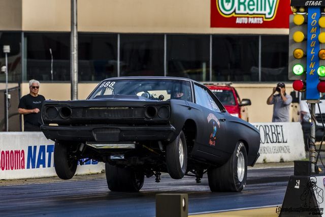

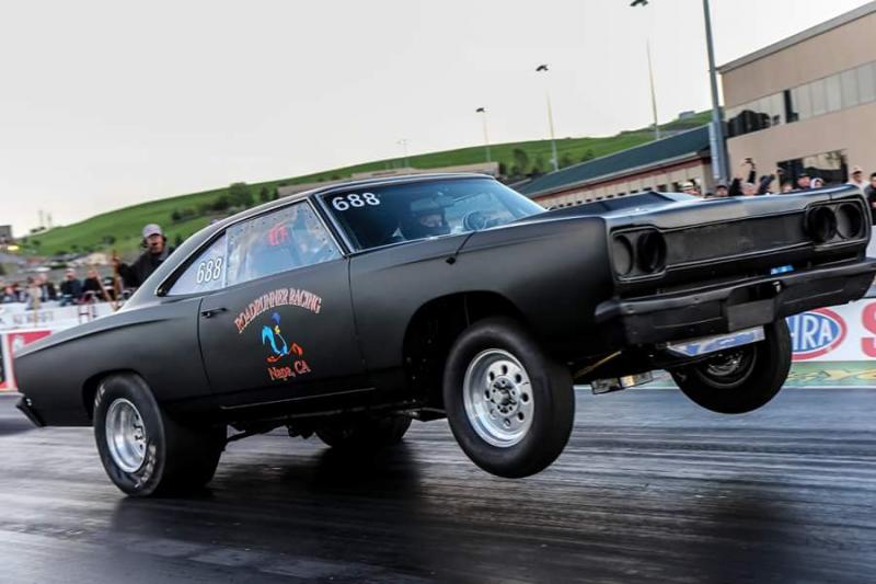

I tighten the rebound on the front a touch. Comes up a little to quick and unloads about 1 tire revolution. Good improvement. Get some slow motion video from the side aimed at the rear tire. Then catch the the front and the rear tire from the side and you'll see it. there's more left.
