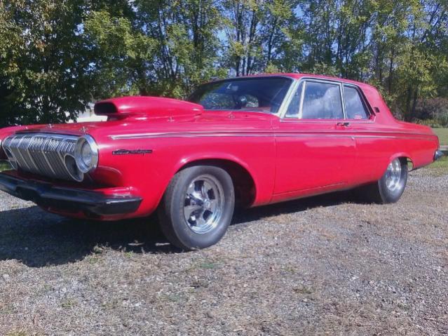

Figured out how to post my pic
nice 63

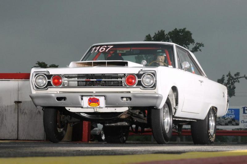

HI all! newbe to this sight, 67 belvedere I sedan, all steel except ft bumper, 472 hemi, heads by Modern cyl.(rip Jeff), 670 roller, 9in J converter, 4.10 dana,9x30 slick, everything home built. runs 10.0 N/ss class. thanks for looking, RussRuss.jpg
HI all! newbe to this sight, 67 belvedere I sedan, all steel except ft bumper, 472 hemi, heads by Modern cyl.(rip Jeff), 670 roller, 9in J converter, 4.10 dana,9x30 slick, everything home built. runs 10.0 N/ss class. thanks for looking, RussView attachment 178583
Very cool 67 Belvedere I, welcome to FBBO... sounds like a fun ride

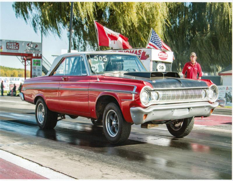

Moving over here from the 11 Second thread.......Made it into the 10's a couple of weeks ago....Best to date.....10.752 at 126.01 mph
Updates that got me there have be M/W Indy heads, Super Vic intake, 1050cfm Quickfuel 4500, and Comp Cams solid roller with .625 lift , 253/262 duration at .050.
Thanks
Splicer
Special thanks to 383M64 DODGE 2013 TN small.jpgan, IQ52 and Supershafts for providing positive info
That should be "special thanks to 383MAN, IQ52, and Supershafts for providing good positive info. Car is street driven regularly and runs the same times thru the pipes or with open headers.
