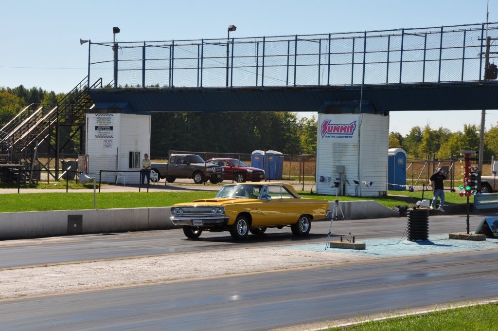

65 Coronet 500
500ci
30 over 400 4.15 stroke
K1 rotating assy, wiesco pistons
11.3 comp
Lunati hyd roller
comp magnum rockers
trick flow 240pp heads
Doug headers. full 3" exhaust, dynamax ultra flow mufflers, tti tails
trick flow track heat manifold
fitech 1200 on e85
727, 3000 Hughes converter
strange dana 60 3.73
full load 3920lbs
best 11.48@118
pretty consistent 11.6@115 1.6-1.7 60'

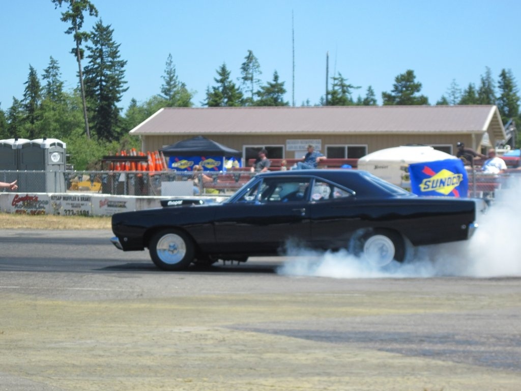

68 roadrunner
440 30 over
diamond flat top pistons
557 purple shaft flat tappet cam
custom crank
scat h beam rods
Mopar M1 intake
edelbrock performer rpm heads 75cc
1.6 Harland sharp Rockers
quick fuel 850 annular booster carb
hooker headers
built 727 transmission with trans brake
4.10 spooled 8 3/4 rear end
custom 3500 stall converter
everything caltracs for suspension
best ET so far 11.02 @ 123 mph
trying to get into the tens!! View attachment 350702
