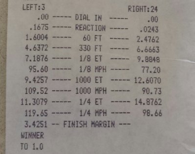

Thanks for the compliments! It's always fun to run with Vipers and Hellcats at the track with far less invested!
It does sound like they are very similar builds!
I have a Virtual Dyno app which predicted almost the exact e.t. that I'm running with a couple more mph. I have a couple of tweaks to get a little more power out of it and get the 60 ft. times down. If I can get it to 60 ft. just a little better, the Wallace Calculator says I should run 11.0. I honestly haven't even started tuning on the motor yet!
I drive this car everywhere and it's exceptionally street able and docile. It's a street car first and foremost.
I've considered a small shot of NOS to get me into the 10's but I gapped the rings way too tight when I built the engine. I'd hate to lift a ring land!

My old bracket car picked up .4 in the 1/8th with the 125 shot. Went from 7.60s to 7.20s
I ran a new best mph tonight. They were running street cars so the 60 ft. was off.
11.38@ 121.29!
60 ft. was a piss poor 1.74.
They came to the staging lanes after the first pass and told me to slow it down since I didn't have a rollbar. :p
