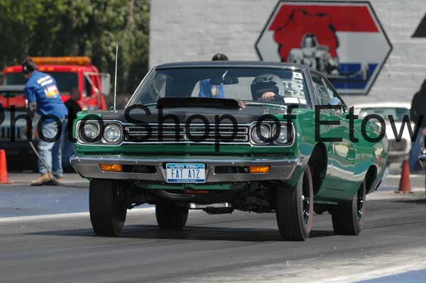

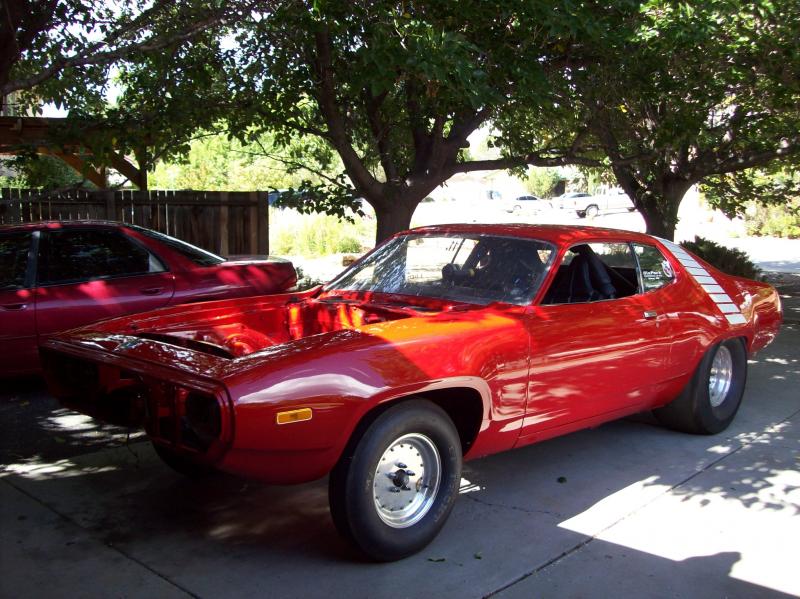

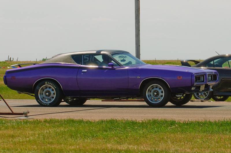

In the front cheep 90/10's with 6 cyl torsion bars.. No sway bar.. Rear stock worn leaf springs with 50/50 shocks.. keep things loose and lubed.. Best sixty with worn treaded tires 172..Fata12 How do you have your suspension set up to help weight transfer? I'm sure you need plenty with those tires.

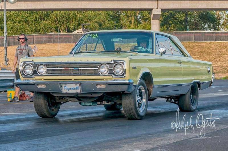

11.60 at 118 on a bias ply.. stock stroke 906 heads..
3920 race weight.
11.97 compression.
hyd.flat tappet cam. by Mr. Six Pack.
Full interior.
Stock suspension.
