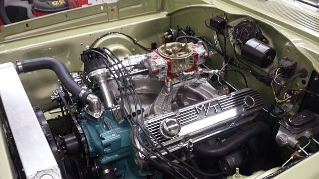

I don't post here much, but I have done a lot of reading!

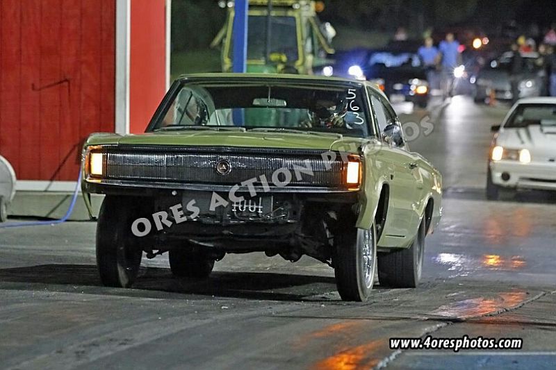

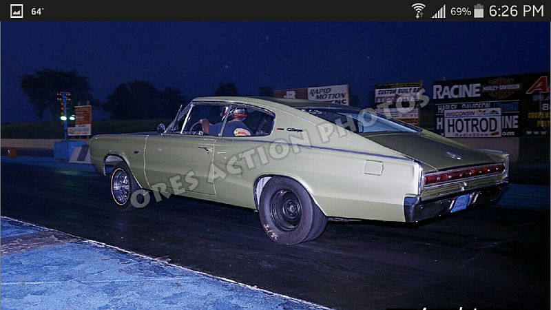

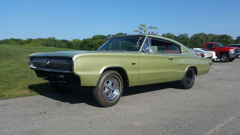

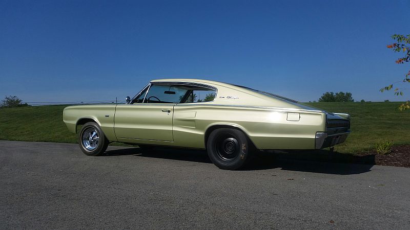

Here is my combination.
66 Charger 400 block bored and stroked to 469. Eagle crank and rods, JE pistons, Stealth aluminum heads out of the box, Comp Cams solid cam .540 lift 286 duration, Torker intake, Quickfuel 950, Hooker Super Comp headers, MSD 6al set at 6,000 rpm's, MSD distibutor, 727 trans reverse manual valve body, 4200 stall, rear is still all stock, with 3.23 gears. Just got the car on the road this summer and the rear will be gone through and 3.91 ratio thrown in. Running MT super street tires I have run a best of 11.91 @ 112 mph.

Wow, nice time for a big car and a big gear.
Yes very good for 3.23! I would think 3.91 would get you close to 11.50's
piwo440 nice ride, nice combo, good respectable times & runs, 3.91:1 should wake it up some
Congrats

Very nice Charger and it runs very good for the combo and gear !! Ron

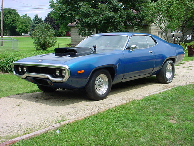

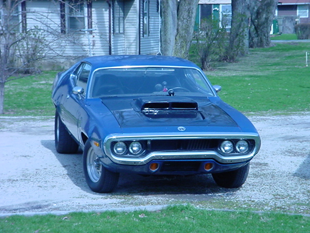

72 Roadrunner 3825#
+.030 440 w/ported 906s
Hughes/Engle HEV5636 solid cam
Edelbrock Victor w/4781 Holley(850)
Hedman 75060(2") headers w/3" headpipes & Dynomax Ultra Flos
727 w/PTC 9 1/2" converter & Cheetah v.b
8 3/4 w/4.10 gears
on Hoosier 28" QT Pros ... best to date 11.28 @ 121.26
Sonoma Raceway

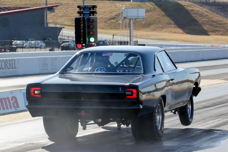

2014-06-18 14.10.41.jpg1968 Roadrunner 440 12 to 1 compression. roller solid comp cam, elbrock performer heads, mopar intake, JE pistons, MSD,Roller rockers, headers, trans brake, dana 60 4:56, electric water pump, electric fan, Turbo action air shifter,Line lock, ladder bar, fiberglass doors, front fenders, hood, lexan windows ( sides) fiberglass bumpers, twin batteries in trunk, 5 gal fule tank, good year 32/15/14 slicks, front runners, 1050 Holly Dominator, So far very soild car runs 11.1 very consistant. Line bored and decked. Looking for ten seconds as the weather cools.

Damn that's some car **** right there. Hey, what's the car weigh with all that fiberglass and lexan?
not exactly sure but I will take it to the scales this month

Another heavyweight that runs really well. Post up some pics!

that big girl really works well,
nice runs

close to the 10's
good luck in the future
nice car/68 RR either way
Thanks guys!
Ron it is fairly rough, it's been wearing the same paint & body filler since well before i got it ... around 35 years.
I went to the scales yester day and the car came in at 3110. without me in it.
really pretty light RR 3110 #'s {no driver}
especially with a full cage stock-ish floor pan etc.
lots of alum., aftermarket suspension, fiberglass everywhere & Lexan helps for sure
