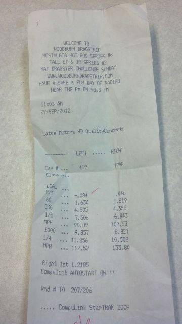

Was at the Woodburn,Oregon track in October and saw a late model charger go 9.60's on 3 stages of n2o.
Ended the day braking the rear end.

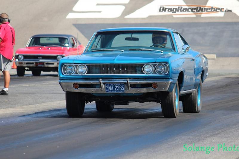

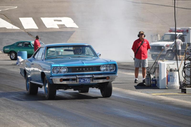

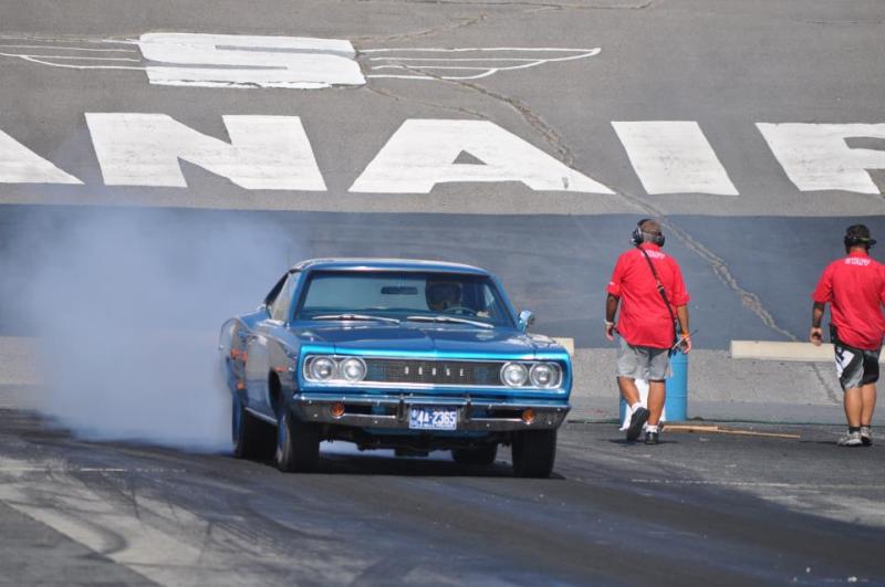

My 11 sec combo.
68 Coronet 440, 4000lb with me in it.
Engine 470 low deck
Source heads with very light intake port work
10.6:1 compression 91 octane pump gas
M1 single plane maifold
Quick fuel 950 carb
1.5 rockers
125gph mechanical fuel pump
1 7/8 Hooker competition
Running a solid flat cam, Comp XS290S dial at 112 maybe a bit too much retarded ???
3in dual exhaust with super Turbos mufflers
Manual body valve Fwd pattern.
FTI 9.5in 3800rpm converter
3.73, 8 3/4 rear
Hemi leaf spring with extended pinion snubber.
275/60r15 Nitto NT555R
The car has everything stock inside, still running 7 blade fan and power steering.
It ran 11.81 at 114mph car is street driven and except it is a pig on gas it is quite streetable
It should go faster this summer, getting more porting on the heads, steeper gear, 1.6 rockers and mayber a solid roller cam like an XR286R but not sure yet on the cam. It will depend on the flow we can get from the heads and also if i can convince myself that a solid roller cam can survive on the street, I am worried about the lifter themselves, any good or bad experience with solid roller lifter doing maybe 1000 to 1500 miles and 20-30 runs per summer ?
422757_281490331957077_444314015_n.jpg 549539_281590091947101_563999152_n.jpg 184115_10151083206426137_1919513850_n.jpg
NICE 68 Coronet
I agree thats a nice looking and running Coronet ! Ron

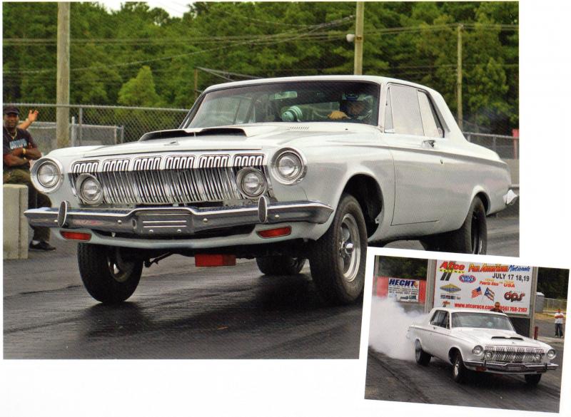

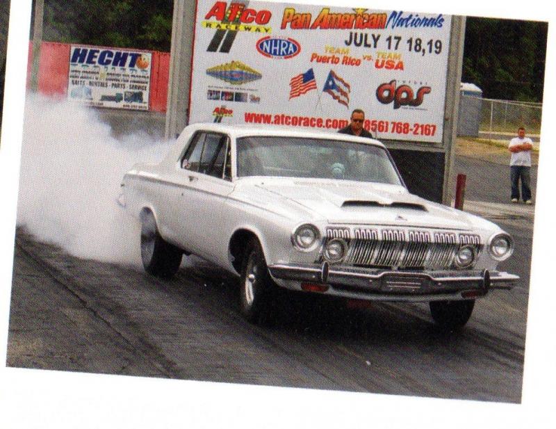

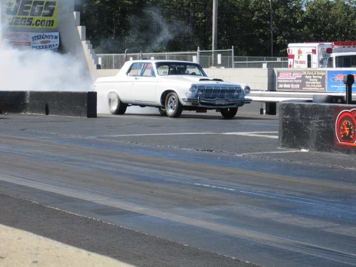

63 dodge
my 63 dodge
440 motor 906 heads 509 cam 4.10 rear 9 inch slick 4200 stall and 850 carb
pump gas 11:46 @118 best time
this car was a lot of fun never broke anything in 2 years of racing
my son raced it. now he races my dusterPolara_atco_8-4-09010.jpg62431_1636482351401_1217004472_31809558_2703938_n.jpg
Polara_atco_8-4-09010.jpg 62431_1636482351401_1217004472_31809558_2703938_n.jpg
67gtx 0324 tell us more about your combo, as this is very similar to what I want for my 67 Belvedere. I know it will likely be a little slower due to weight, but your car is exactly where I want to be performance wise.
Thanks
my 63 dodge
Sounds Like a nice working combo....
Thanks
440 stock crank stock rods resized arp bolts .030 forged flat top pistons with valve reliefs the cam was a
hughes 563 lift "I forget I changed it" hughes rocker arms, push rods by smith bros. 906 heads 2.14 intake
1.81 ex milled .040 edelbrock performer rpm 850 carb. msd 6al, Mallory 110 electric fuel pump factory
pre set 7 psi no reg. 4200 converter by dynamic 4.10 rear 28x9 slicks the motor was basically a street
motor idled around 800 rpm ran it at 6000 to 6200 rpm it just ran and ran never broke one thing on motor
for 2 years I think the car was just under 3400lbs hope this helps
Nice
67GTX 0324 thats a very nice 63 Dodge you have ! I also like the wheel combo alot with Torque Thrust up front and steelies out back as you can see. I do love the 63 Plymouth and Dodge's ! Sweet launch pic. Ron

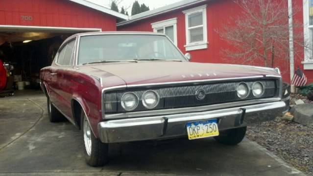

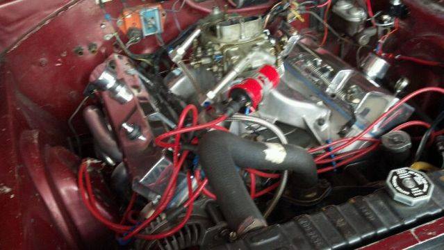

I'm hoping that after the upcoming changes I'll be able to post my findings here. Tell me what you think of the combo:
70 Charger 4100 lbs with driver.
493, 10.7 compression. Iron block, Edelbrock RPM heads Unmodified. 261/271 @ .050 .558/.578 Lunati Solid, 850 Demon carb, Edelbrock RPM intake, 2" TTI headers, 2 1/2" exhaust & tailpipes. MP electronic ignition, Chrome box, MSD blaster 2 coil. 727 with 3000 stall, GV OD, 3.91 diff. I have access to slicks but may buy some Drag radials for racing.
Is this capable of breaking into the 11 second bracket?
