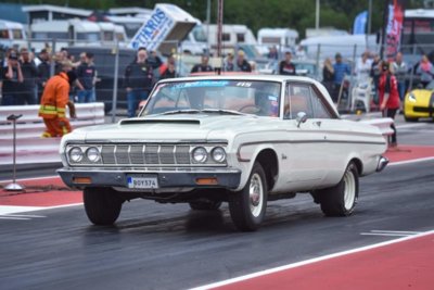

64 plymouth belvedere, all steel and stock interior and benchseat.
11.915s @113.1 mph
1.75a 60 foot
This run was with 100hp nitrous.
Goes 12.24 na.

Nice , looks great

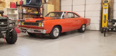

Well I finally made it to the 11’s. 1968 Road Runner 400/451, 10:1 compression. Solis lifter cam grind .600ish. Ported iron heads and factory intake. 800 edelbrock carb. Factory exhaust manifolds with 2.5 X pipe by Pypes. PTC 3500 converter. 3.73’s in an 8 3/4. G70-14 redline tires.
