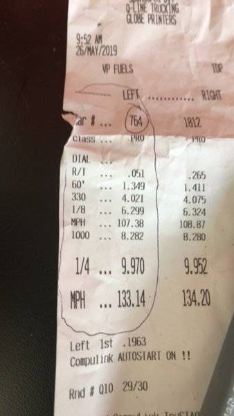

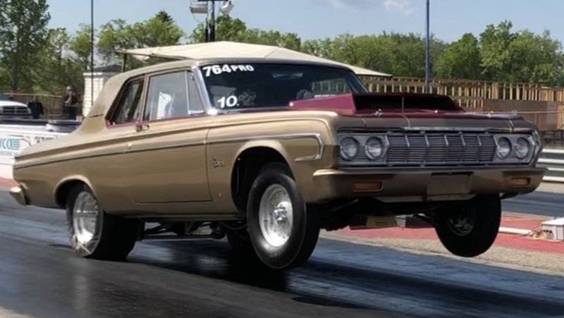

It's been a work in progress with my 64 Belvedere to get to the point of posting in the 9 second thread. Purchased the 64 out of Flint, Texas, trailered it home up to Canada, right up through Tornado alley in April, 2014. A trip that started out by heading over to Indiana to pick up a new trailer, that I had built for me. From there, headed over to Texas with great optimism that the Plymouth was going to be everything that it was said to be. If I was to do it over again, I sure wouldn't be cutting through south Chicago again though...
Upon arriving at the Plymouth, it became apparent that the car was oversold. That said, and everything taken into account (travel, condition, etc) well here we are.
A full rebuild took place on the Plymouth in my garage over the following years and in 2017 the Plymouth finally made it to the track. The Plymouth started out running in the high 11's in 2017 and from there it's been a work in progress heading in the right direction.
1970 440 block, bored .030 with 440 source 505 stroker kit. 12.7CR.
440 source lightweight crank, aluminum main caps, main girdle, ARP main studs.
Milodon pan and internal oil pickup
Comp Custom Solid Roller, 276 / 284 @ .050, .673 lift
Edelbrock Victor heads, Hughes offset 1.6 rockers. (Mild port work)
Edelbrock Super Victor intake, 1050 Holley.
TTI 2" 440-200 headers
727 Torqueflite, transbrake, A&A low-gear set, Ultimate 8" converter
Dana 60, 4.10's, Moser axles, Strange driveshaft and yokes.
Disc brakes, Wilwood fronts, Right Stuff rears.
Double adjustable shocks, QA1 fronts, Strange rears.
1969 K-frame, AE Engineering engine plate.
Comp. Engineering outlaw ladder bars.
All steel car, fiberglass bumpers.
6 point roll bar with dual swing-outs. Good for 10.0
3240 lbs, less driver with full interior.
Best of 9.97 @ 133.14 MPH.
Thanks to all of the FBBO members help in getting this 64 into the 9's.
