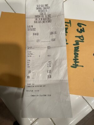

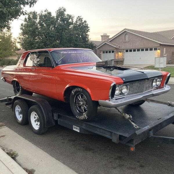

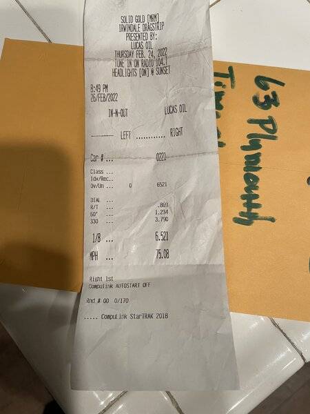

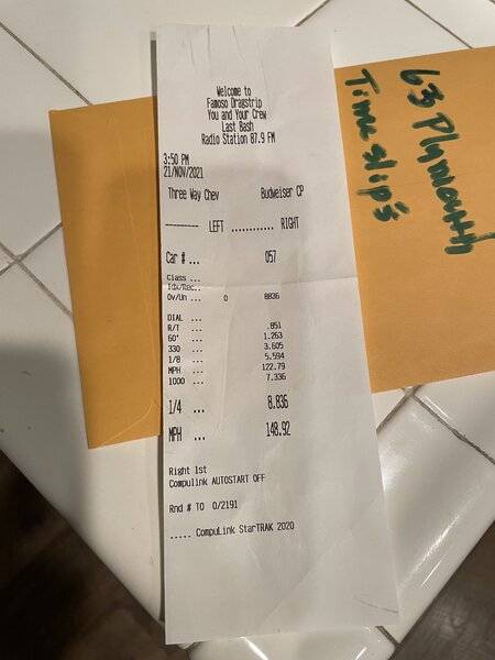

500 CI wedge Big Block 800HP N/A with a 200 Shot of Nitrous, 456 Gear, 29.5/11.50/15 Tire best of 1.23 60' & best run 8.83 @148.9 MPH

Nice. Give us some info on your combo.

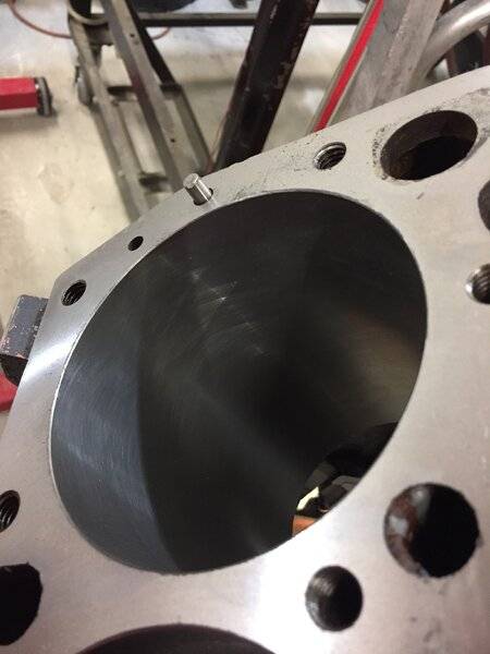

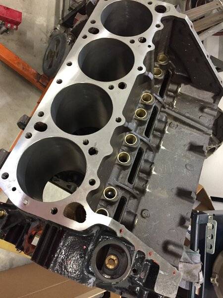

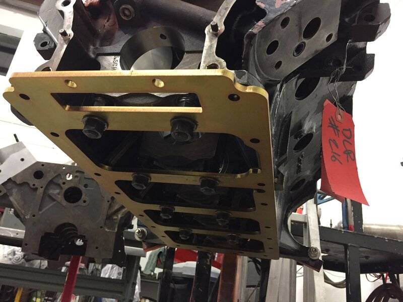

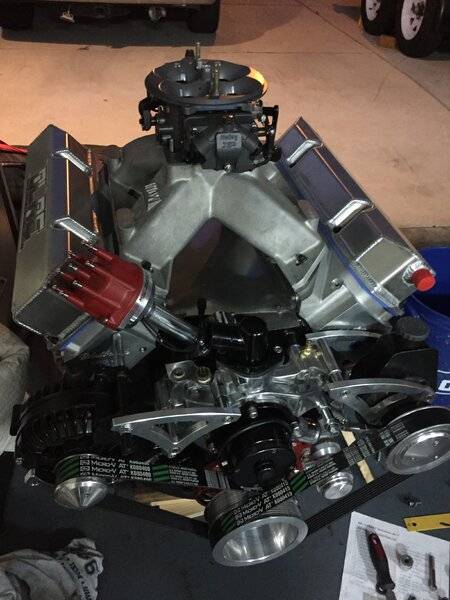

1/2 Filled Factory block, Girdle, bushed lifter bore's, Ported Edelbrock Victor Max Wedge Heads, 15.1 Compression, 1050 Dominator Carb, 1.6 Harland Sharp Rollers, don't remember all the specs on the cam but i think 735 Lift, Runs on VP~Q16

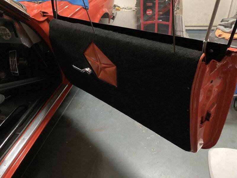

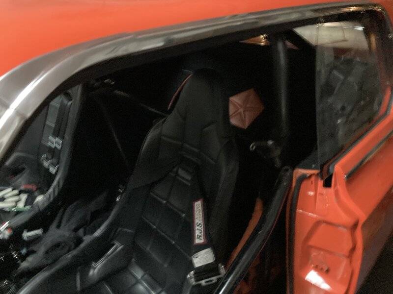

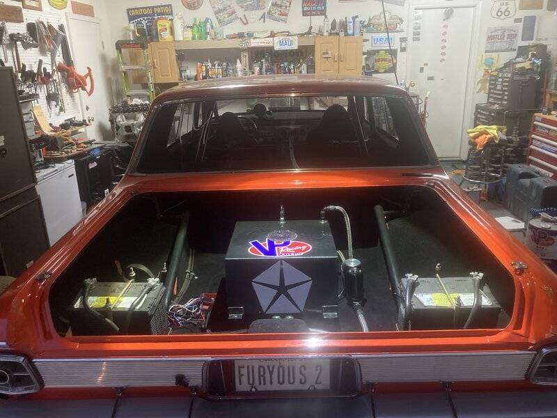

The car must be gutted with other weight savings to be 3k lbs.

nice car,,But if i am reading this correctly u r making 1000 HP with the Nos running an original type 2 bolt factory block !?
That's the way I read it too. Could be a good test case for block fill and girdle effectiveness.
My very similarly decked out 62, all steel, is 3300.
Whose girdle? Any machine work to install it? My favorite Mopar machinist doesn't like them, doesn't want to do them. Not sure why, I like the idea.
